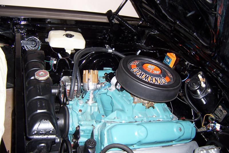

Hi Dave. If you need any help let me know. I got pics of my 68 GTX after replacing every nut and bolt after 9 years ( FULL RESTORATION DONE ). Put it back to all stock except for some color changes. I started it up last summer with the help of this site ( need to put the front and back glass in and done ).

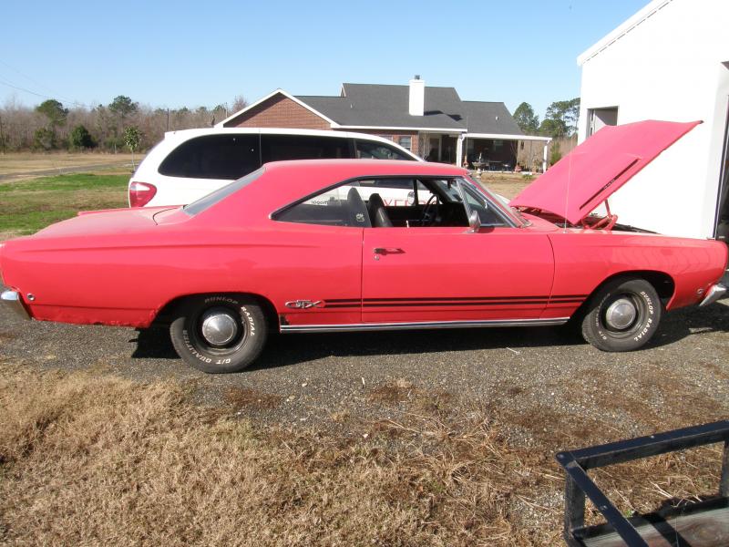

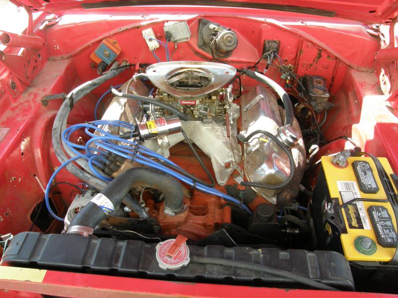

Thanks for the offer Dave, may have lots of questions, had a 69 GTX vert after High school. Mine is not a # maching car, so I am not going to try and do a restore to orginal. Car is running with a 78 440 and 727, 354 sure grip rear. Have change all the wiring and everything works. Have rust in lower quarters, but the rest of the car looks good. Won't really know until I get the paint off. Car was white and repainted to red sometime back in its life.

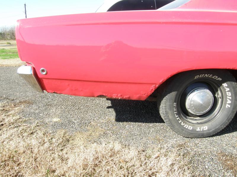

Here are some pictures

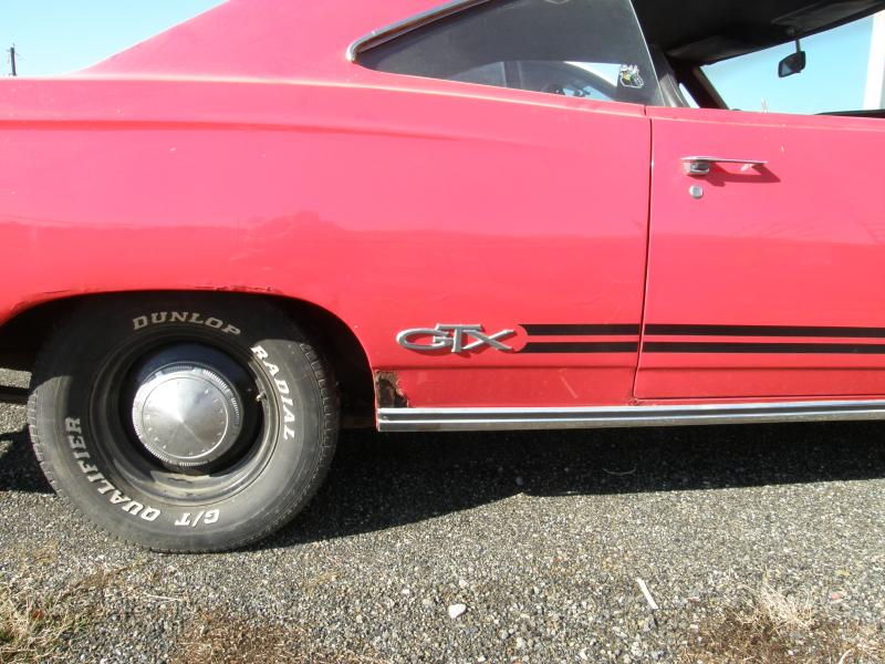

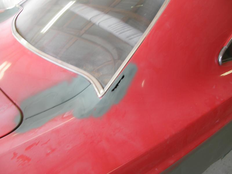

Well I started stripping the paint on the passenger quarter and there is 3/8 inch of bondo on it. Looks like I am going to have fun

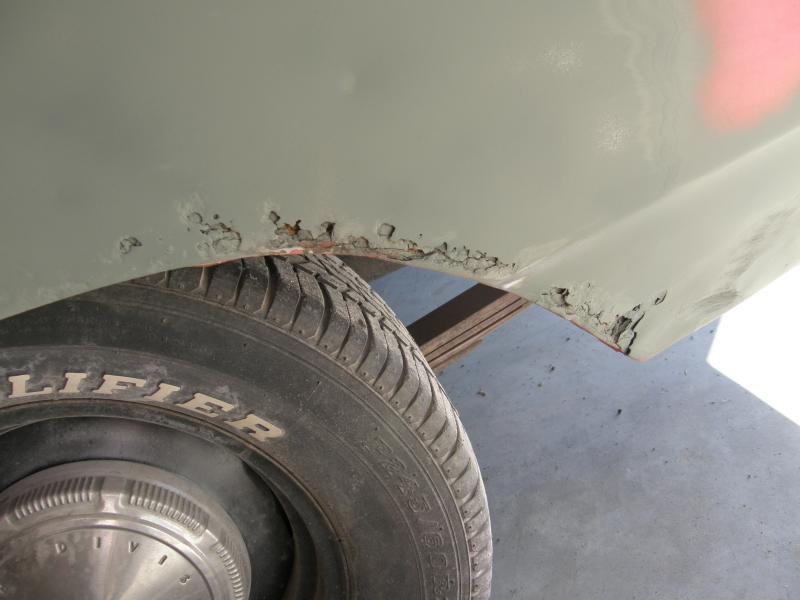

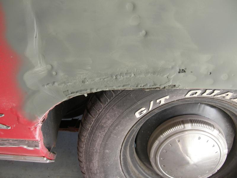

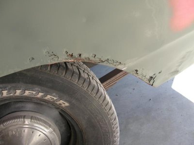

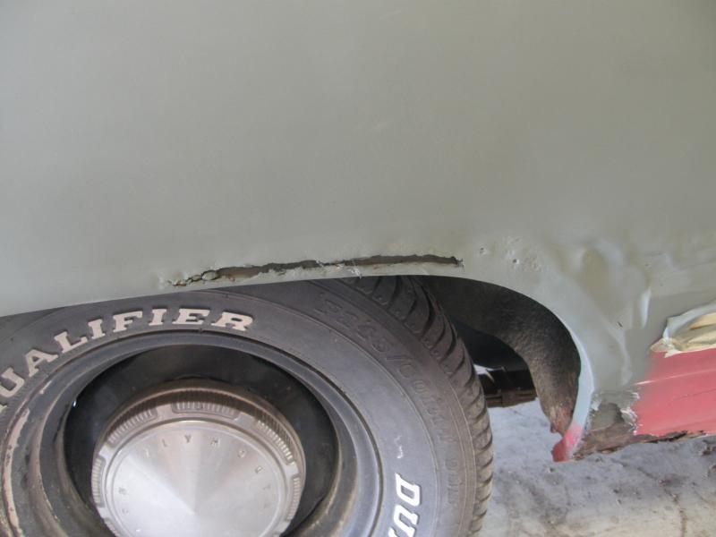

After stripping down the 1/4 there is a lot less rust then you think. Most of all the cracking was the 3/8 bondo on the fender from a dent about the GTX emblem. The lower 1/4 are gone, but around the wheel well only the crack you can see in the picture from on top of the wheel forward about 5 inches is rust. The rest was just painting cracking from bondo shrinkage.
DF
Well here what I found. Lots worst then I hope for.
