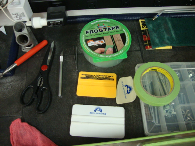

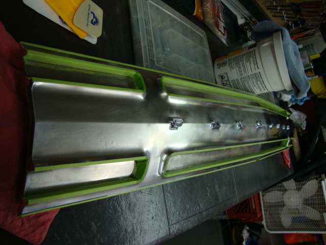

so far i used the green 3M tape for the straight edges and for the corners i used "frog tape"; its on the same order as the 3M, but a bit more workable.

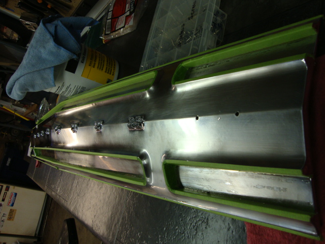

the light green is the 3M and the darker green is the frog tape. this part has been the biggest PITA so far; trying to get the right line cuz da chrome is so damn shiny, you cant tell what is what!! lol
i didnt tape the letters and scuffed around them free hand...just got be careful, it's pretty easy if you watch what you're doing. (obviously i will be taping them for primer and paint)
i have scuffed the panel with the green 3M pads (used 4 of them btw) and then tore off the first tape job and re-taped the panel cuz those pads tore the tape up pretty well and i want a nice fresh line. (it was a helluva lot easier to tape it off this time!!! lol)
these are tools of the trade...lol
