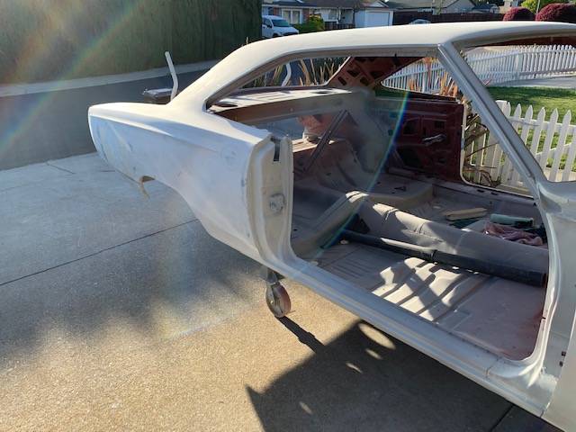

Finally getting a run at the body work this week, really nice starting out with a pretty straight car that is already blasted and has 0 rust. Makes it so much nicer. Still hate body work though! Still trying to decide if I am going to shoot it or take it someplace. I have been painting my own cars since I was 17 but I never do it consistently enough to get really good at it. The flip side is I did decide to let a shop do the body work and paint on my GTO and it was a train wreck, 3 1/2 years of body shop hell and three body shops later it is back in the shop being repainted again now due to peeling paint. Even though it is warranty work it is still a pain. I will for sure do all the prep on the RR just would like someone who paints for a living actually squirt the paint on not to mention I am relegated to a garage and don't have a big shop. Who knows maybe I should dust off the old Sata and go for it myself.

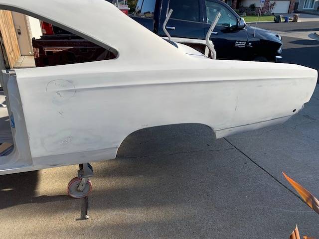

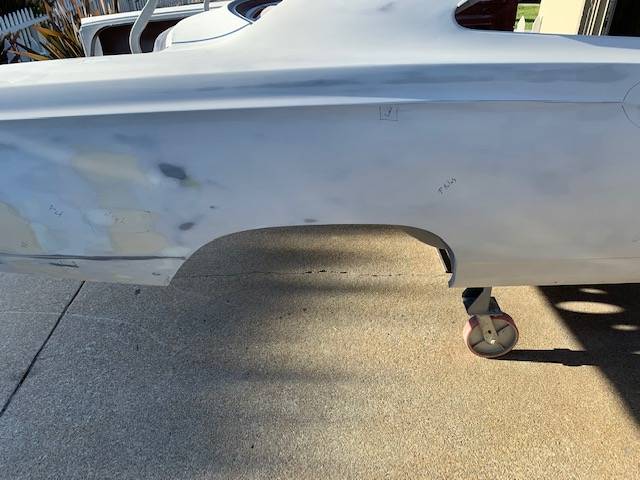

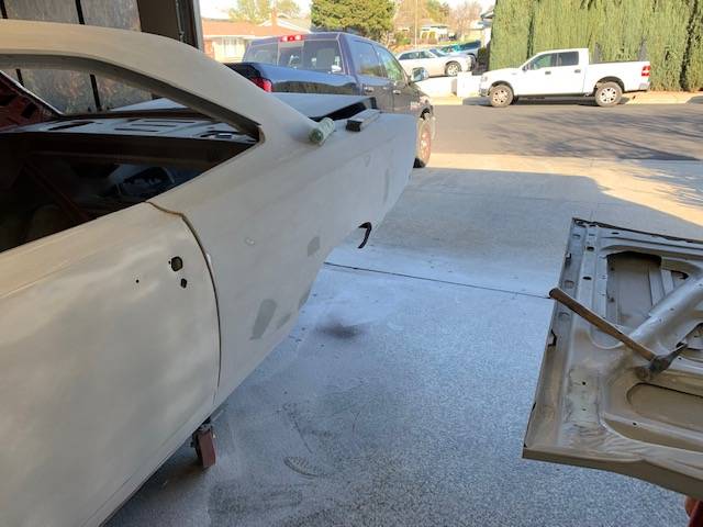

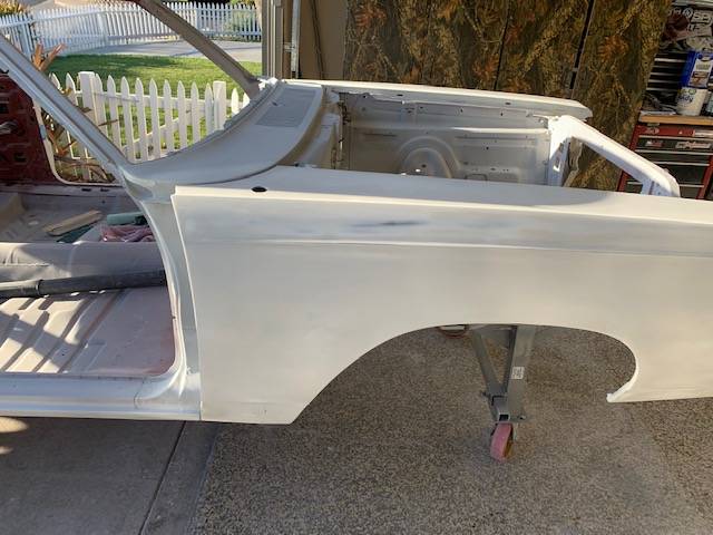

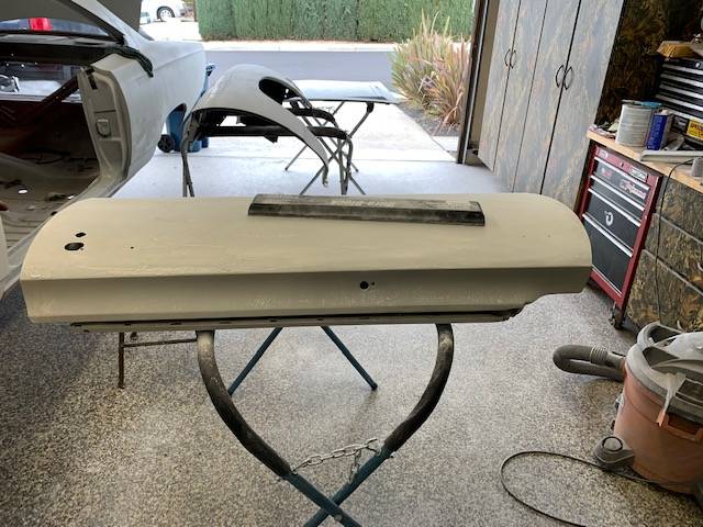

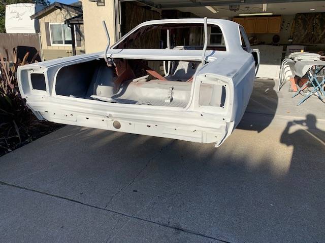

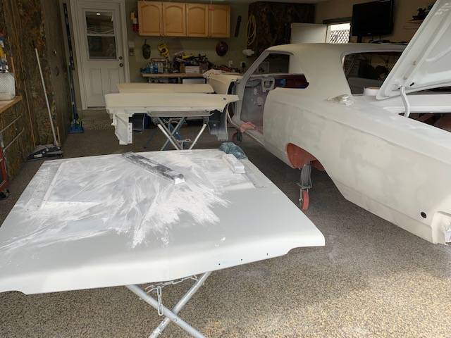

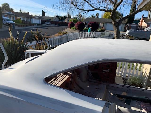

Plugging away on the body work. The passenger quarter has been a slight challenge since it was replaced at some time. It appears that the car had some rear end damage at some point way back in the day and a quarter from another car was installed. Since the quarter was brazed on I would assume it was done back when the car was fairly new and it was done by a collision repair shop as an insurance job. Overall pretty good work I am just being **** about it matching the drivers side perfectly. I made a pattern of the drivers side and just kept working the metal on the passenger quarter until it was as close as I could get it to the pattern then floated it out with filler and then blocked 95% of the filler off. My goal is to shoot both quarters with polyester filler/primer tomorrow and block the entire car again. Then the first of next week get it in 2k primer before I leave for Idaho on Friday. Once I get back from Idaho I will do the primer/block/primer/block/primer/block thing until I am satisfied with the final product. All the primers are from SPI and I am still trying to decide if I want to use BC/CC or single stage. The guys at SPI recommended I use 2 stage rather than single stage but I wanted to keep the original looking appearance. I am still weighing all the pro's and con's but I have a feeling it will end up being PPG base or Automotive Art Motobase and SPI clear.

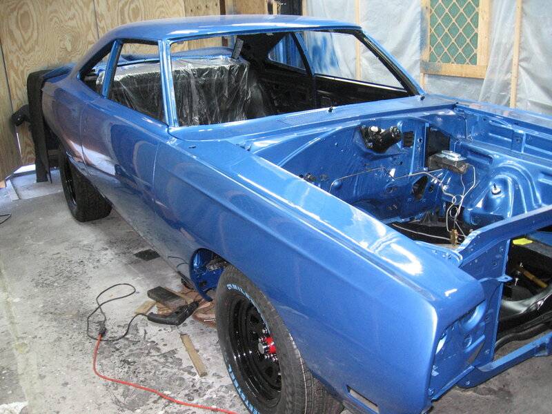

Your into it now for sure. I used Matrix paint. Which is PPG paint. Three coats of base then added color blender with a micro flake royal blue over the b 5 for pop. Then three coats of clear. Lot of work. I would add fish eye to my color blender. It does not hurt to add it to your clear or base coat even if they say you don't need it.
Your into it now for sure. I used Matrix paint. Which is PPG paint. Three coats of base then added color blender with a micro flake royal blue over the b 5 for pop. Then three coats of clear. Lot of work. I would add fish eye to my color blender. It does not hurt to add it to your clear or base coat even if they say you don't need it. View attachment 1088678

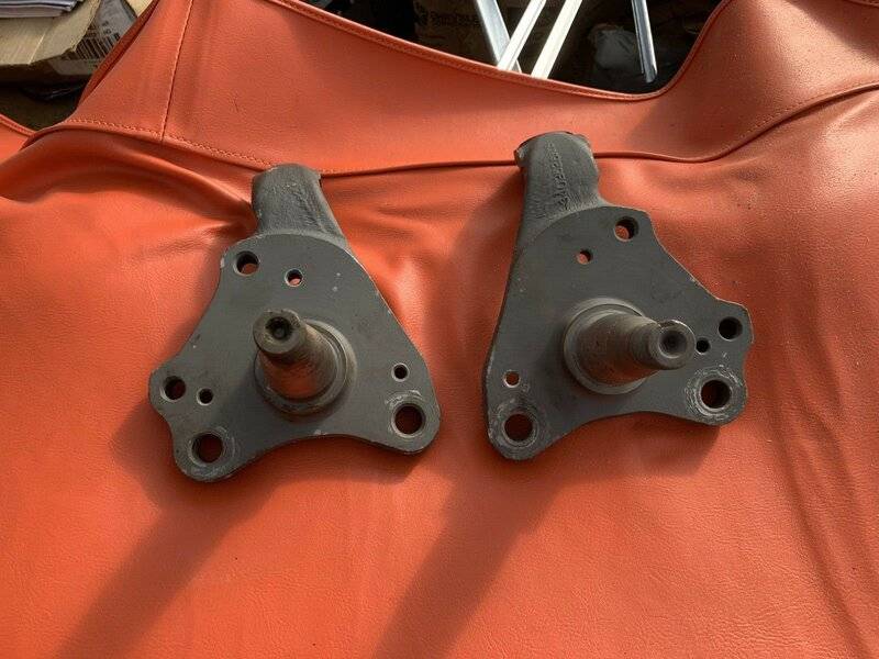

I have been thinking about other parts of the car while doing the body work. I have pretty much settled in on a disc brake kit and narrowed it down to Dr Diff or SSBC or maybe even a set from Pirate Jacks. Sunday morning while waiting for my wife to get ready for church I did a quick spin through ebay and saw a set of 73 Cuda spindles with no bids and 2hrs left. Starting bid was $125, I thought what the heck for $125 I would take them but figured at the last second someone would snipe them. I bid $125 and go figure we get home from church and I am the proud owner of a set of Cuda spindles. So now I am going to piece the front disc together and save a few bucks. There is a great thread here on the boards for that exact swap. I also picked up the sliders from a member here on the boards, Dr. Diff has the caliper kits really reasonable so it has all worked out so far.
If you have to by calipers and rotors anyway get the bigger "Cordoba" rotors and associated calipers. .
Doctor Diff is the source assuming he has them in stock.

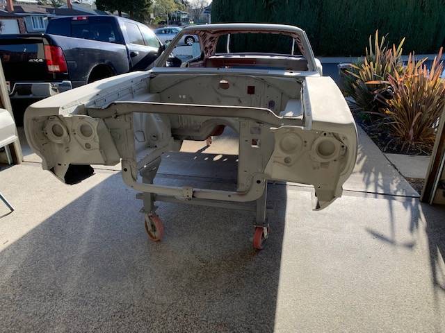

Was the cowl top off the car when you got it?
I can't tell from the first pictures but it looks like it.
I always wonder about the inside of the cowls when bodies receive this type of treatment since I've have to pull more than one apart to get to the inside.

The cowel was intact and pretty clean inside.
