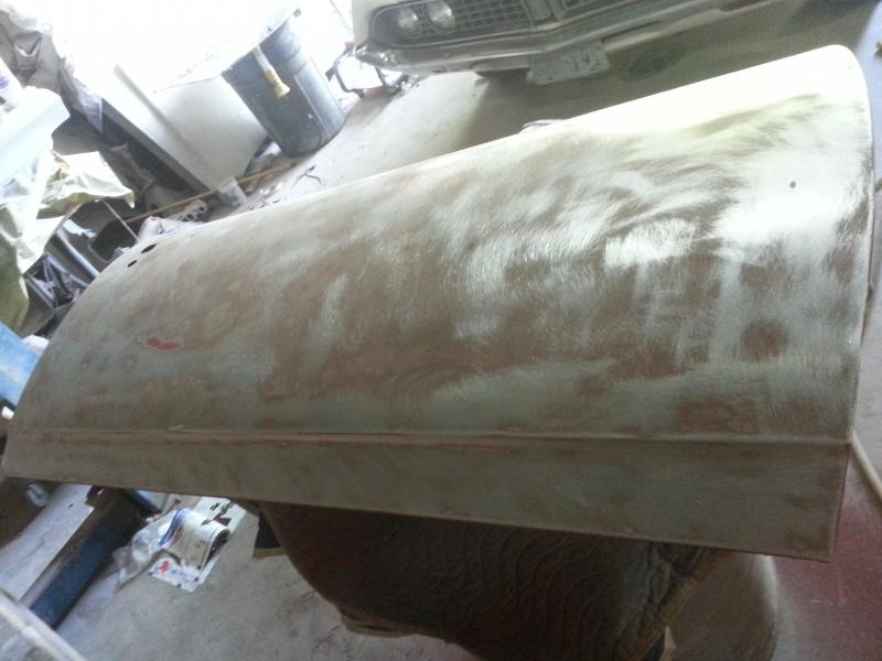

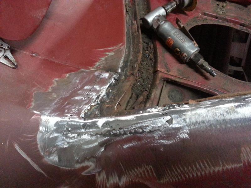

i stayed late and made some repair panels. heres the left rear window corner. gonna wipe it with some all metal tomorrow then mud. hope to prime rt door, rt fender, and left fender tomorrow night and start painting pieces maybe sat. its been a while since ive done metal fab, used to welding new panels on and painting. lol go easy on by work please. :bootyshake: 20130821_174953.jpg

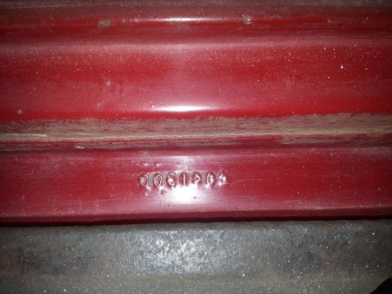

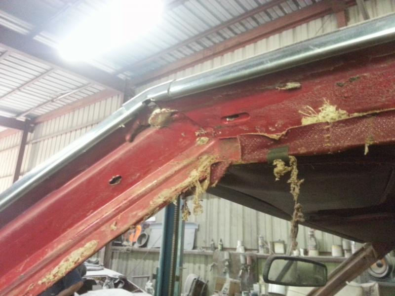

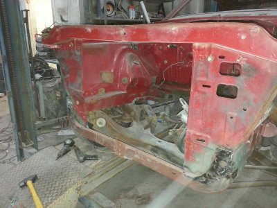

Al, glad you joined. I hope you can find the pics, that should be entertaining lol. Im in the stage of the car where I have aggravating nasty work that doesnt show much progress for the amount of work you have to do. The fenders, hood, and doors are sripped, mudded, and primed. The right frame rail was about 3/4 up from the left. I put it on my frame machine and got it equal. the right inner fender needed some work so ive finished that as well. The mud work on the roof is near done as well. I hope to be painting pieces in a week or two. When we stripped the fenders and doors, I had a pleasant surprise, absolutely no rust. I feel like ive won the lottery. Lol we changed the lower tie bar on the radiator support because it had rolled off the front of a car trailer and bent it pretty bad. Guess where I found the new support. In the trunk. One of the previous owners bought a nice used radiator support for it. I posted some pics of the a-pillar after I took the weatherstrip off. Its clean as new. The pic of the numbers is the trunk jamb with the part number in it I guess?

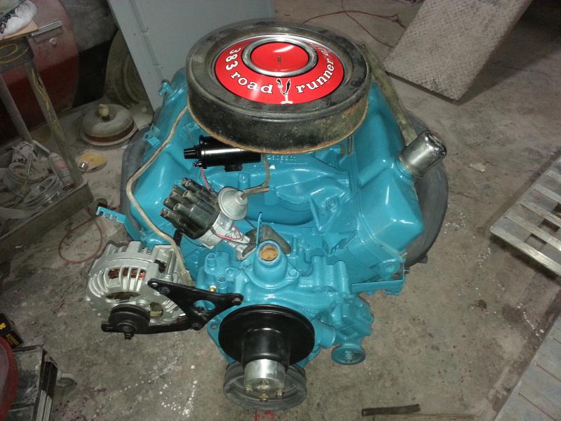

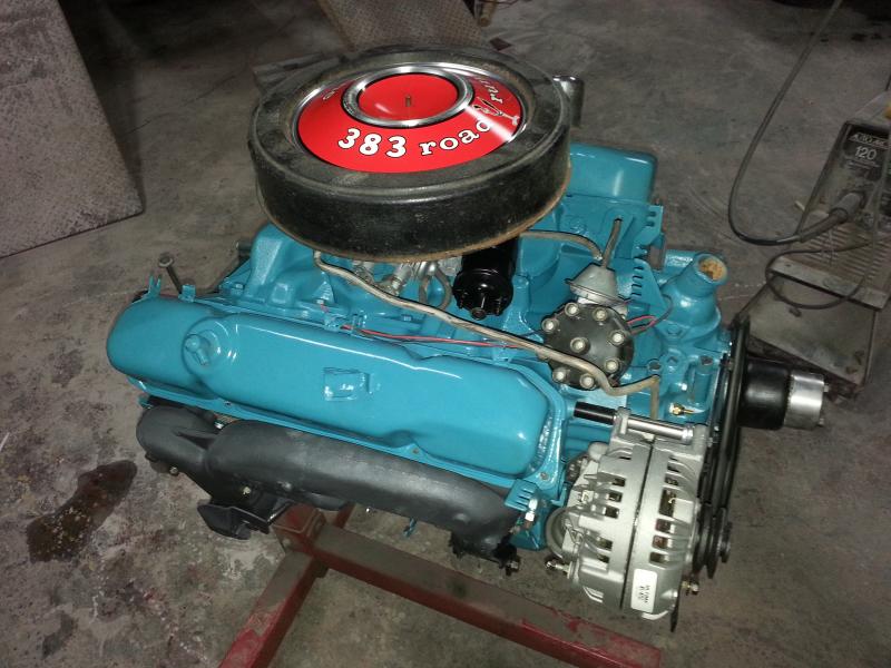

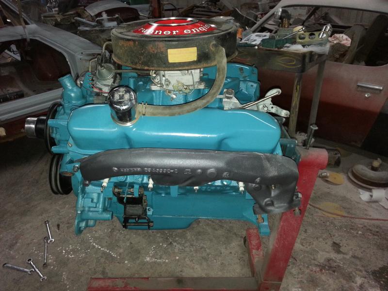

Been plugging away on the drivetrain and body. Bored motor 30 with new pistons, small cam and valve job. Stayed late tonight and got the motor pretty much ready to go in. Converted dist to pertronics. Found an original air filter on ebay. Trans cleaned and rebuilt. All the sheetmetal is ready for paint. Hope to be done with all the spraying by next week. I ordered classic air and legendary interior. Heres a few pics of the engine.

i stayed late and made some repair panels. heres the left rear window corner. gonna wipe it with some all metal tomorrow then mud. hope to prime rt door, rt fender, and left fender tomorrow night and start painting pieces maybe sat. its been a while since ive done metal fab, used to welding new panels on and painting. lol go easy on by work please. :bootyshake:View attachment 135376
Your work looks pretty darn good to me. I see what looks like a few small holes at the top and just wanted to make sure you knew to seal them up by either welding or putting seam sealer on the back side. "Not nitpicking" just hate to see a blister start where moisture came threw. I know I sound like a broken record on here about sealing things up "just trying to help". Your motor looks great "nice job"
I would have to agree. I would weld them up if they are holes don't count on allmetal or duraglass. i would clean and seal the backside of anywhere you weld also just as a precaution anywhere you weld makes a "hot spot" that will rust a lot easier than the plain steel. Awsome clean car will be a sweet ride when you are done. Keep up the good work.
