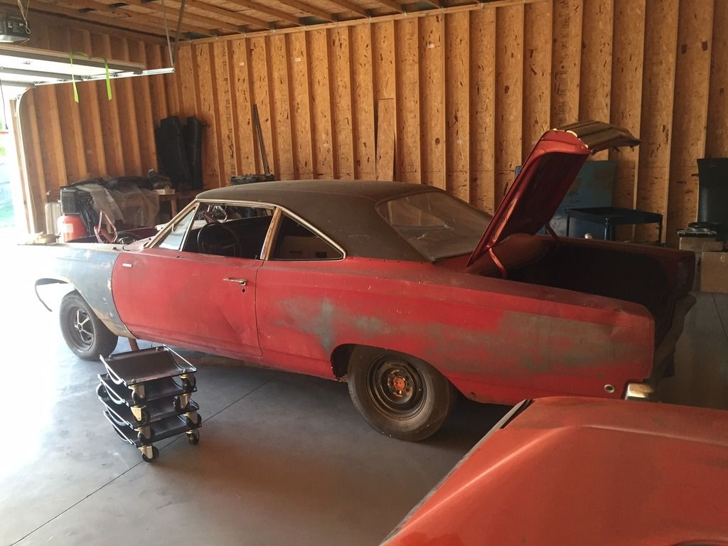

68 Roadrunner Post w/ 6.1L HEMI, 6 speed, and IRS
Thanks for all the great pictures of your work, and great progress you are making, that's super. Actually I think I'm more envious of your beautiful new garage, and the floor! Keep up the good work, will keep checking back!
Sounds like a great build and trust me you won't regret cutting that floor for 2 extra gears and a smoother shift:thumbsup:.
I can't believe how nice those fenders cleaned up, to bad it wasn't the case everywhere else but still a solid starting point. Looking forward to this build.

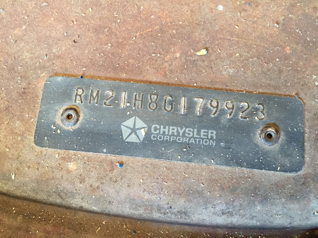

I took the dash frame to a local powdercoater, who blasted and powder coated it in a satin black. The only blasting cabinet he had big enough to blast this dash used coal slag, which is quite aggressive so I was worried it would warp the metal. I asked him to turn the pressure way down; he said he used 40 psi (instead of his usual 100 psi) and it turned out great! I am really happy with the texture and finish. Plus I got rid of the UGLY marroon.
I don't have a good picture of the dash frame beforehand, but the metal around the VIN plate will give you an idea of what it looked like. This car had been sitting in a field in western kansas without a windshield for more then 1o years so all the paint had been baked off the top of the dash frame
