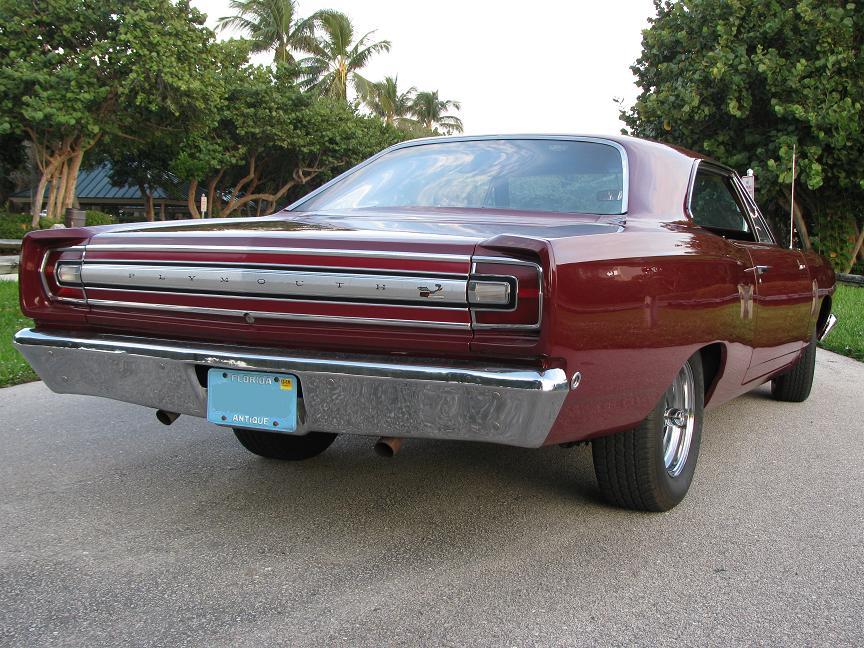

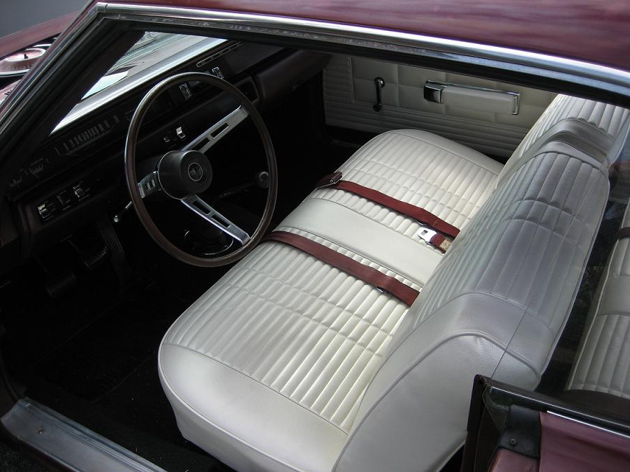

Tail pannel, B piller stainless if a RM21, the H** code int., same as a Satellite int., that consists of carpet, chrome arm rest bases, rear arm rest ash trays and the delux steering wheel. While a option on RM21 cars, it was std. on RM23 cars. Here's a few shots of my RM23. My car has the optional woodgrain steering wheel.

Have I ever mentioned how much I love the `68's?, rrunner that car is beautiful!. Man, I can't wait to get the "DOG" in to paint and put back together.
Thanks! I have always had a thing for 68 RR's also. Matt, From what I've seen, you car is making nice progress to say the least.
