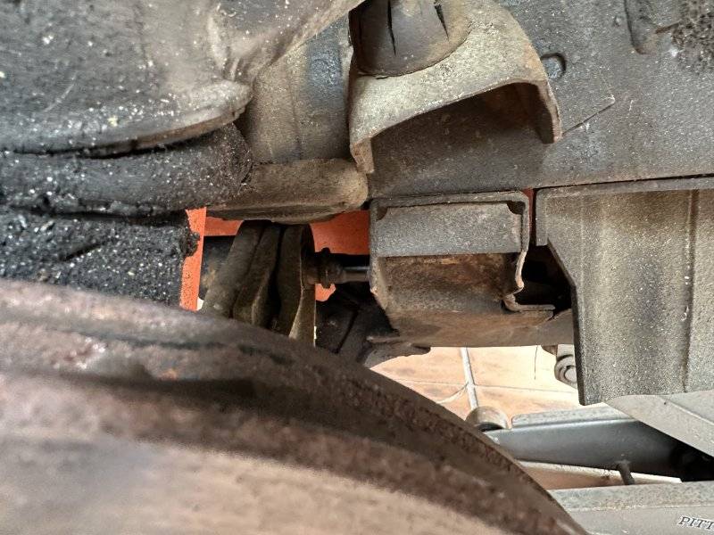

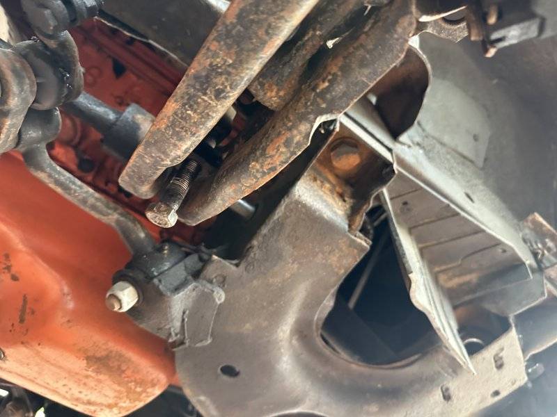

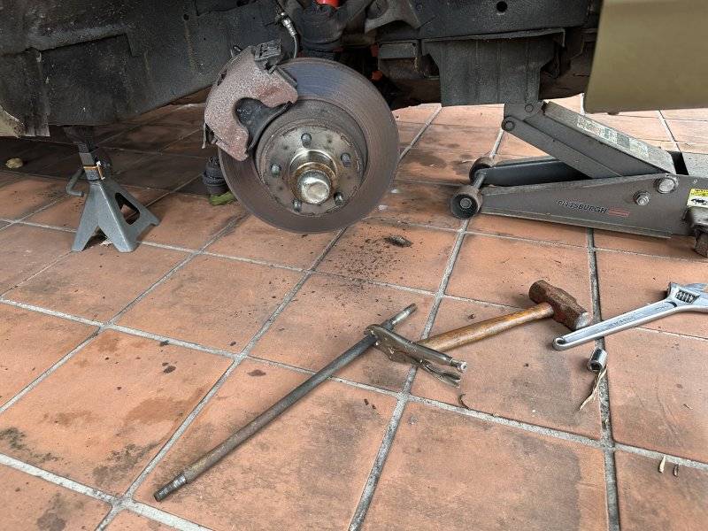

The fun bit of this job is that one has to loosen the LCA to get the rod out. Thankfully, that makes undoing the torsion bars a hell of a lot easier. I loosened up the torsion bar adjustment (not before measuring the bolt head-to-plate with a caliper for returning it back to the same spot), then unbolted the LCA, removed the torsion bar retainer ring, and gave the LCA a few good whacks.
Bada bing, bada boom.
I undid the strut rod before this, of course. Undid it at the K-member first, then at the LCA. It's fun (not) to undo the K-member bolt when the radiator is in...no room for a socket and ratchet.

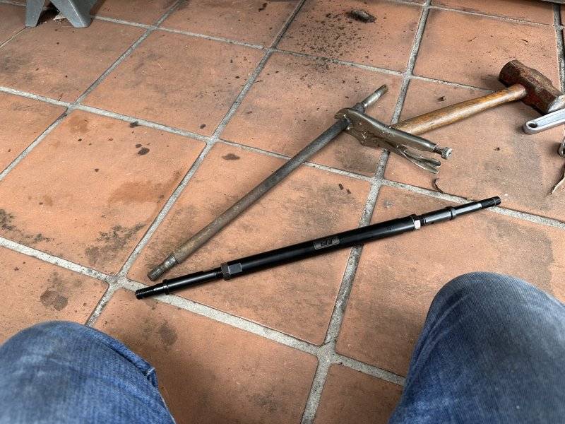

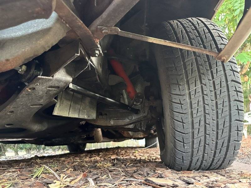

And here's the shiny-shiny:

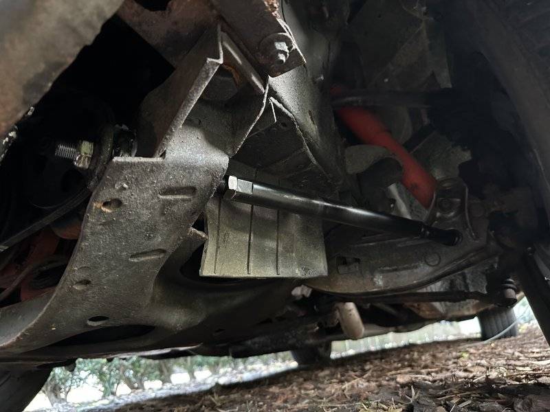

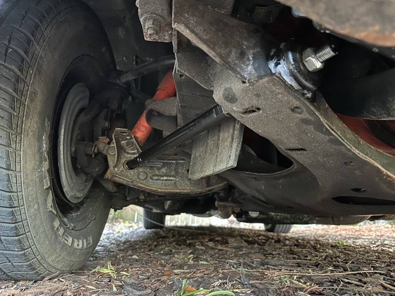

I installed them in a bit shorter and extended them to the factory 17.5" length. Didn't want to affect anything at this point. Heck, I don't have my turn plates or caster/camber gauge yet ("Anyone here getting rid of these cheap?"). Yes, I did this while crossing my fingers I wouldn't screw up the existing setup too much.
Apparently, I was pretty accurate about it, because nothing major changed in the front end after buttoning it all up, other than it's riding a bit higher as the rods are now keeping the LCAs from pulling backwards - what they should have been doing in the first place.

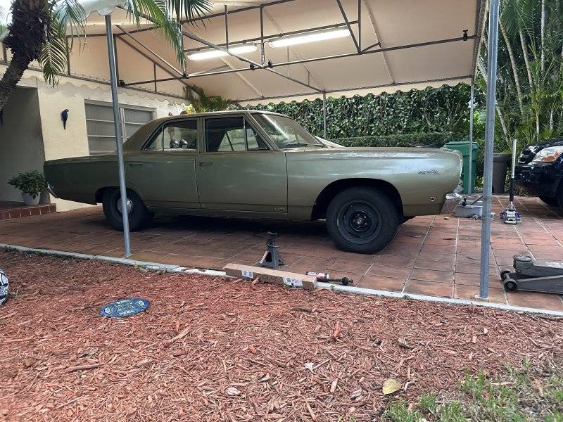

Speaking of which, it's always fun to look at the front end after dropping it off the jack post-suspension mods. Before rolling the suspension to settle, it always takes on the Un Homme est Mort suspension setting. The clone LAPD Belvederes in that film had their torsion bars cranked to the moon for jumping the bridges on Dell Avenue.
I tightened the LCAs after settling it out.
