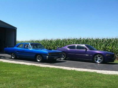

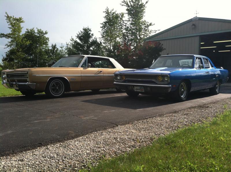

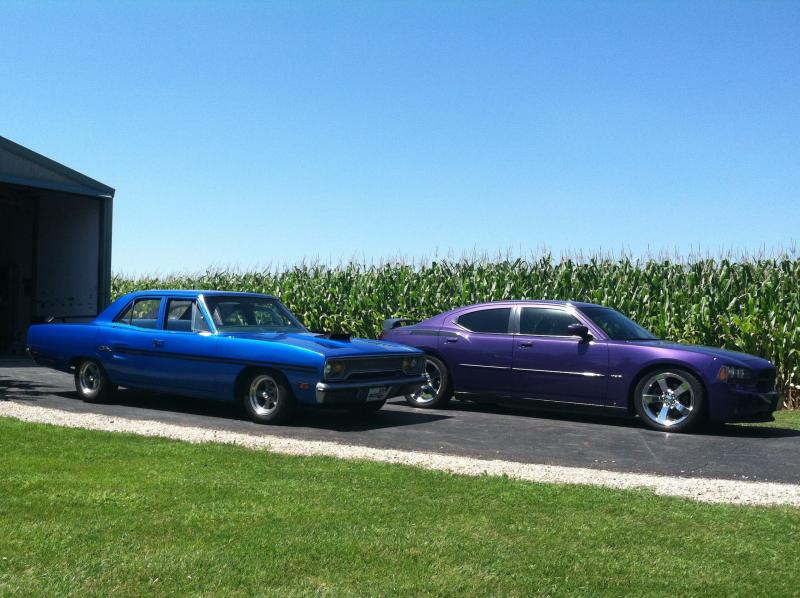

Couldn't resist a bit of "Generation Gap" photography today:
And lots of love for the More Doors:
-Kurt
Nice pics, nice cars! I took a few pics of my sedans last summer too!image.jpgimage.jpg
Ralphie, you can pack up that Fury III and your GTX and send them my way whenever you like :)
