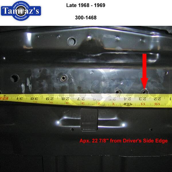

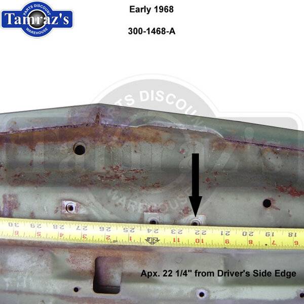

On the early Roadrunners and GTX's they originally located the hood latch
an inch or so from where the later 68's and 69's.
All hoods are not created equal!
Where’s the later one? More towards the front or one side or other like the inch you mentioned?
Is it difficult to get to, to open the hood on the earlier one? Or another problem?

Eliminate the dents, rust and body filler on your old hood with a new AMD hood made on our own tools. All underside braces and brackets are reproductions of originals so our hoods have the correct appearance on both sides. There are two different postions for the latch and safety catch on 68 models. This hood fits early 68 models. The distance to the center of first hole for the safey catch when measured from the drivers side of the hood is approximately 22 1/4". If a similar measurement shows 22 7/8" then order part number 300-1468.
This fits:
1968 - 1969 Plymouth Belvedere
1968 - 1969 Plymouth GTX
1968 - 1969 Plymouth Road Runner
1968 - 1969 Plymouth Satellite

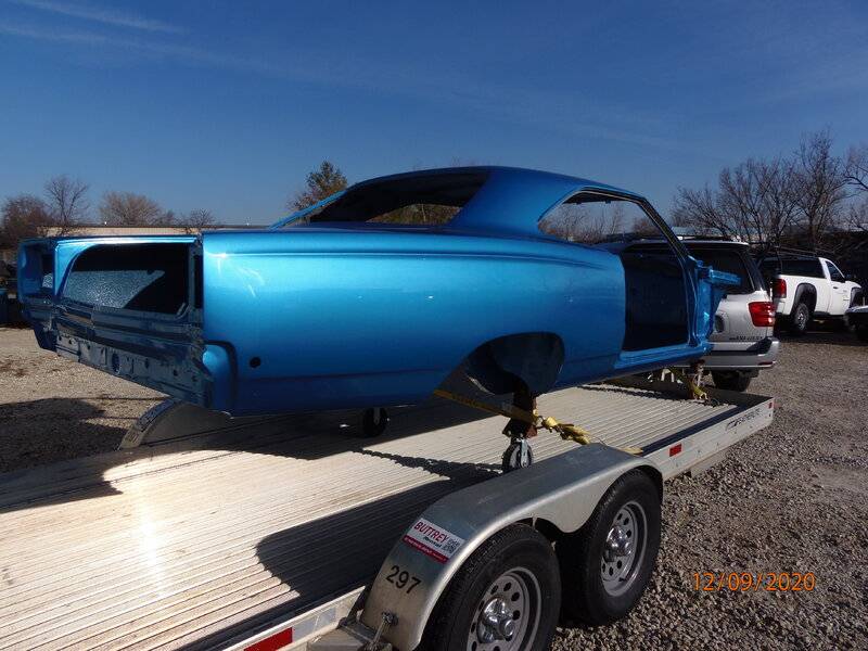

Yeah, That Red Bull is really something! I have been taking alot of pic's all along
since 2011 and figured I would post a few important ones in order now that I am
actually putting it back together. I wish these things progressed that fast! Some
take a lifetime.

QQ1 was actually a half-year color that had a cut-off date if you were ordering the car.
They quit using it in July I believe? My car and Mario's were Born in June, and we both
have that P.I.T.A. hood latch location also. The paint is Spies Hecker, and they matched
the color with the inside of the deck lid before it was stripped. Dead Nuts! Had some
friends joke that it was a GM color from the label, but Hey, they had to start somewhere!
I plan on putting 15" Magnum 500's all around with the full chrome, not the trim ring.
Tires will be determined at the last minute. The engine is a 440, 0.030 over with 906
ported heads opened up to Max-Wedge size with an Indy Dual plane intake and Eagle
H-Beam rods. Speed Pro pistons with a 0.080 dome (cut down from 0.140) 727 TF
with a 2800 stall convertor and a Dana 60 with a 3:73. Hooker competition headers
and I almost forgot, I opened the stock oil pickup passage in the block to 11/16 and
put the Milodon Road Race pan on and their 1/2" pickup.View attachment 1052062 View attachment 1052063 View attachment 1052064 View attachment 1052065 View attachment 1052066

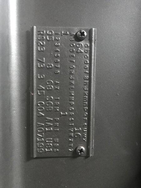

About 15 years ago I did a 68 GTX. First time ever apart, 55,000 mile car. Exterior was AA1 silver, interior colour QQ1
I had no Idea they did that either! Interior color QQ1? WoW!
The things the factory did in 68. When I came across the paint code I grabbed a picture of it. That GTX was a nice car too, 426, 2 X 4BBL. 4 speed Dana car.
On that fender tag, it has the interior paint code where my MFG. date is. ?????
