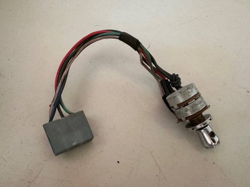

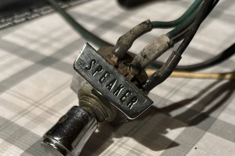

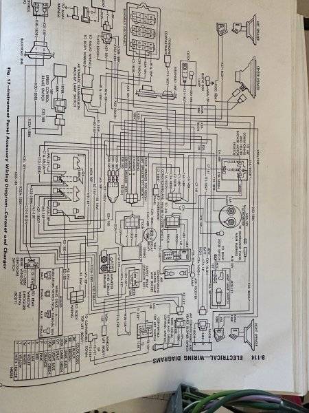

Never seen that. 8 track output fader and speaker outputs must only have two plug connectorsRear speaker was available with Am/8 track in 68-70 B bodies too. It used the same fader switch for single rear speaker.
So it’s the same output 2/4 speaker systems just gets divided up to appropriate number of speakers. Thanks RC

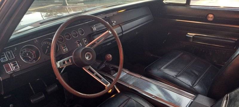

Some even were equipped with a console mounted 8 track & a Microphone
You thinking the cassette player?Some even were equipped with a console mounted 8 track & a Microphone
Not offered in a 68-70 B body. They did offer console mounted cassette deck with mic in 71 & later.Some even were equipped with a console mounted 8 track & a Microphone
I stand corrected. I had a 71 Charger R/T with the "wild kingdom" louvered hood scoop, Y4 gold w/tan interior! (I wish I had taken more pics!) Go Wing, etc. It had the E Body type console with the cassette deck & mic.Not offered in a 68-70 B body. They did offer console mounted cassette deck with mic in 71 & later.
