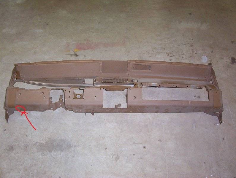

#1 Can anyone with 69 B-Body Power Windows tell me the correct location to mount the under dash relay? I believe that it mounts on the bottom edge of the dash frame to the left of the steering column, but there are several holes there to choose from.

I figured that there was more to it. My 70 FSM shows a safety relay in that area. The relay is laying flat with the connector side facing the fire wall. I believe it should be this hole.
Not sure on which hole, but Panora picture looks right. I think the relay bracket/body is used for the ground connection.

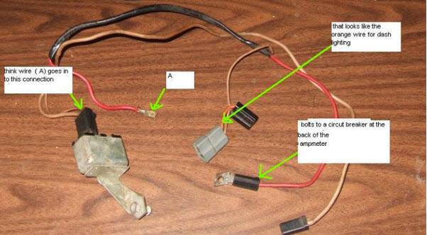

Picture of my wiring. I don't see a circuit breaker in the assembly. I had thought that the larger RED wire hooked up directly to the ammeter, but the wire does not appear to be long enough to reach the ammeter location (if the relay is mounted on the bottom of the dash frame adjacent to the A/C duct). More research has identified a threaded post type CB/Fuse that I may be missing.
However, one of my other projects in rebuilding the car was to remove the ammeter, splice the red/black wires together, and install a Voltmeter. So now I need an alternate power source for the power windows.
I ran a dedicated wire off the positive battery terminal into the interior of the car, will terminate a 4 terminal fuse panel, and plan to connect the power windows to a fused connection. Additionally, I also plan on connecting power for heated seats on a second terminal of the new fuse panel.

The wire you marked dash lighting is going to be your 12 volt ignition keyed feed. It must go to another componet that is unplugged and the connectors act as a jumper. I know I have a diagram somewhere and I just need to find it. Like I said the FSM likes to make it hard like its top security.

Agreed on the wire identified as lighting connection (another Mopar affectionado labeled my pic in response as to where the wires went) and it did not make sense to me why the light circuit would have any input into the power windows.

I was able to find the information in the wiring under Coronet. So the relay is fed constant 12 volts from a circuit breaker that hangs off the ammeter. The relay must be grounded. The keyed 12 volt source is piggybacked on the radio feed connector. The remaining wire 12ga. Tan goes to the window harness. Fuse wise I would go with a 15 and see if it holds. There may of been reasons for the breaker. Information wise that same breaker also fed the convertible top and rear window on a wagon.
