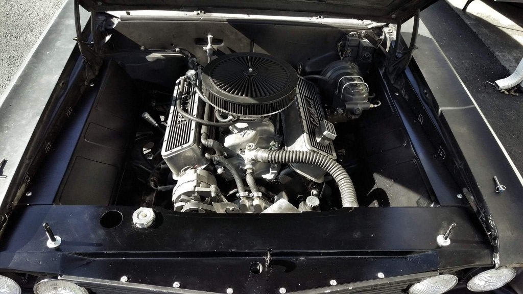

Initially I went to Randy for help making some aluminum inner fenders with some cool bead-rolled designs, which quickly turned into a complete engine bay overhaul with a chopped core support, dropped radiator, hardlines to re-route heater hoses, and a front finish panel. Came out pretty sanitary though!

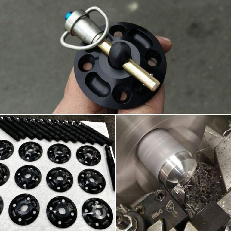

At this point I also designed and machined my own billet aluminum hood pin kits that I've also been selling online. "Blackout" series shown here in an anodized black finish

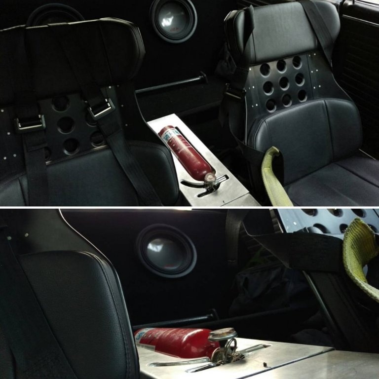

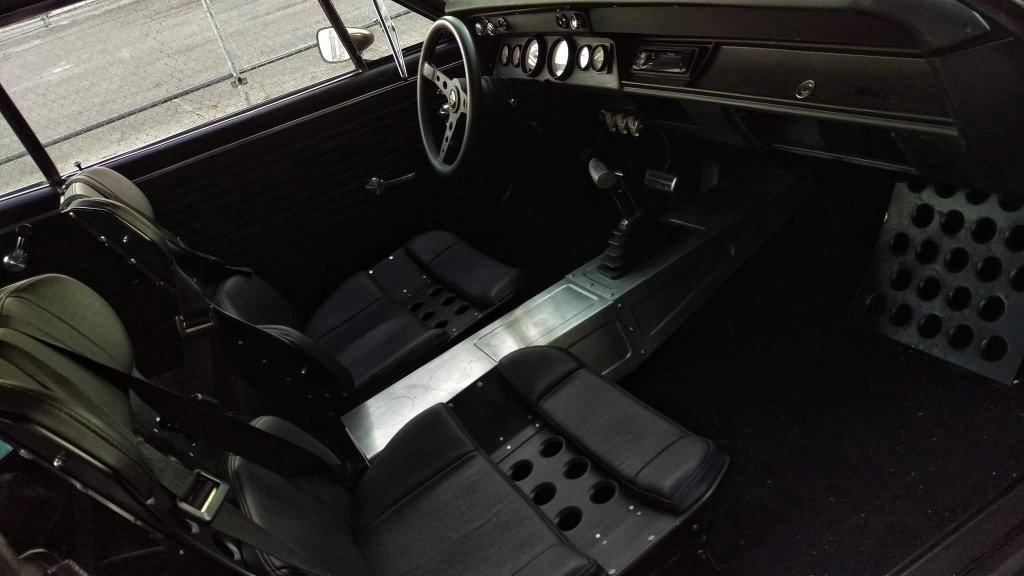

Then I set my sights on some custom aluminum seats. Designing a traditional seat rather than a straight sided "bomber seat" presented more than a few development challenges, but now that it's all said and done I'm in love with them. I'm actually just about to ship another pair out to a guy that's putting them in a first gen camaro. So to carry on with all the aluminum work, I designed and built a full-length aluminum console which is still being finished up, and will have cupholders, a carbon fiber cell phone charging/ change holder tray, and a mount for my fire extinguisher as seen in the pics.

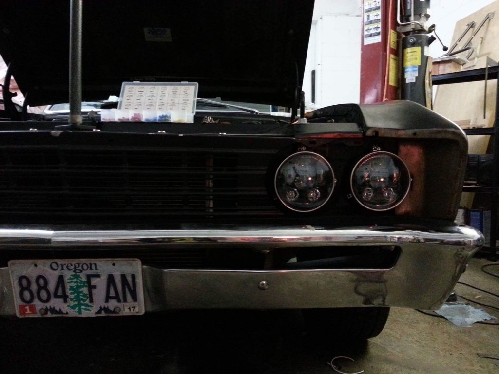

Oh yeah, and LED headlights! The light these things put off is absolutely amazing. Not bad for $50 apiece on Amazon haha

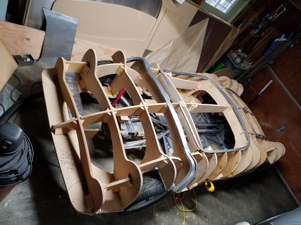

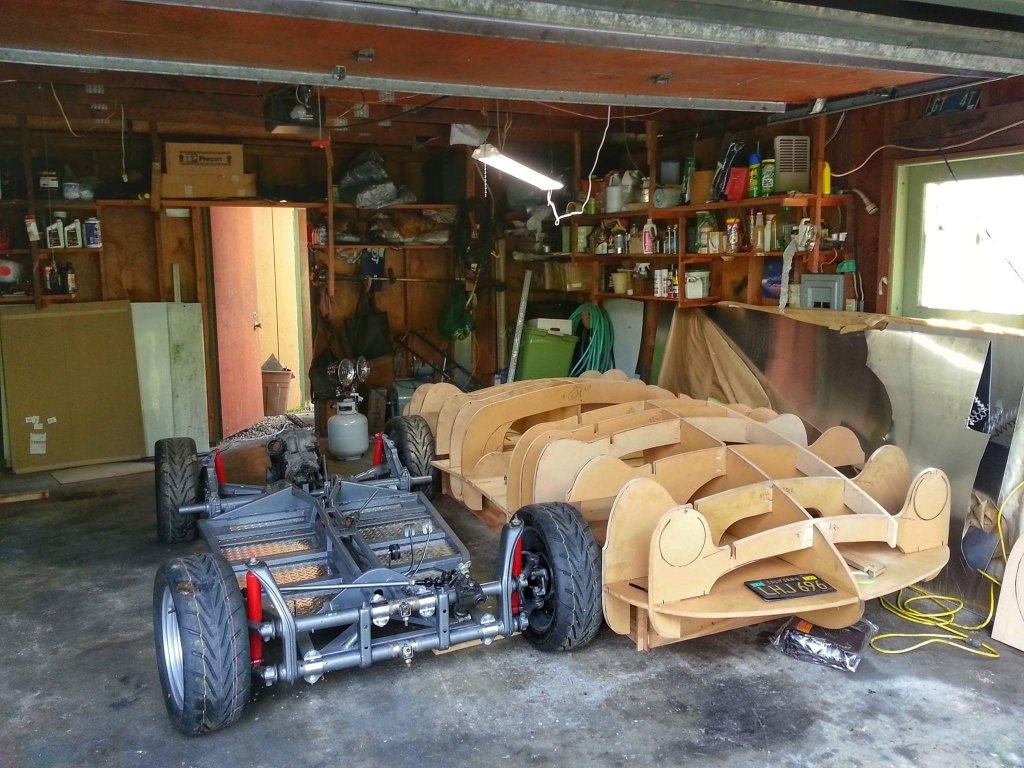

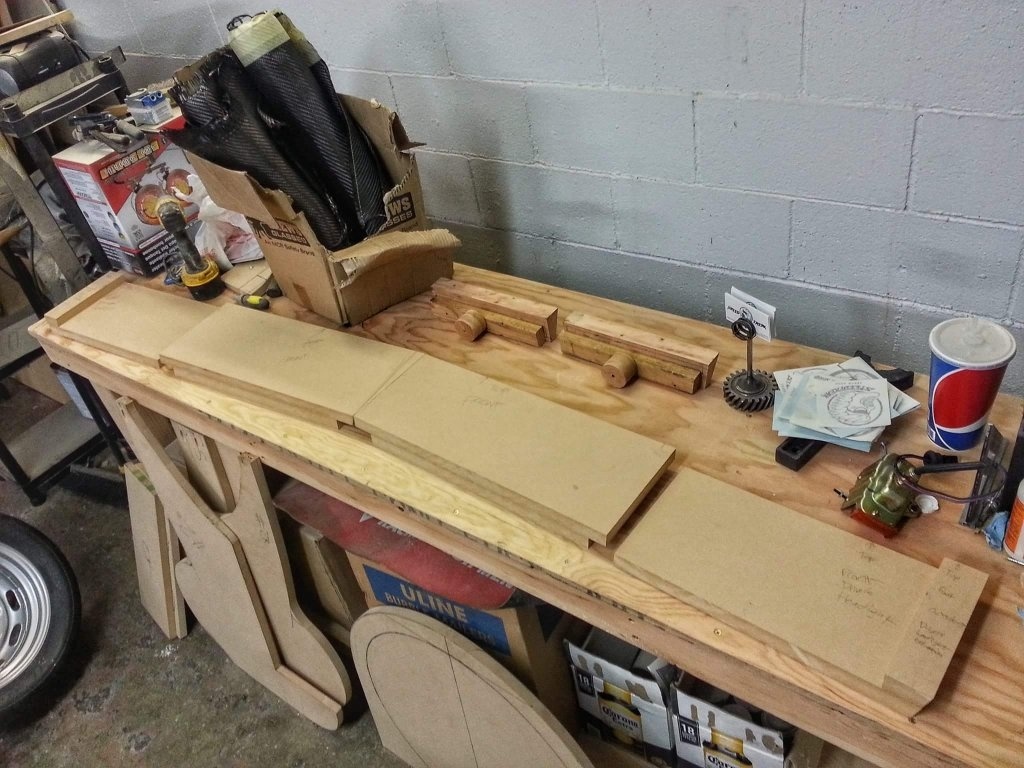

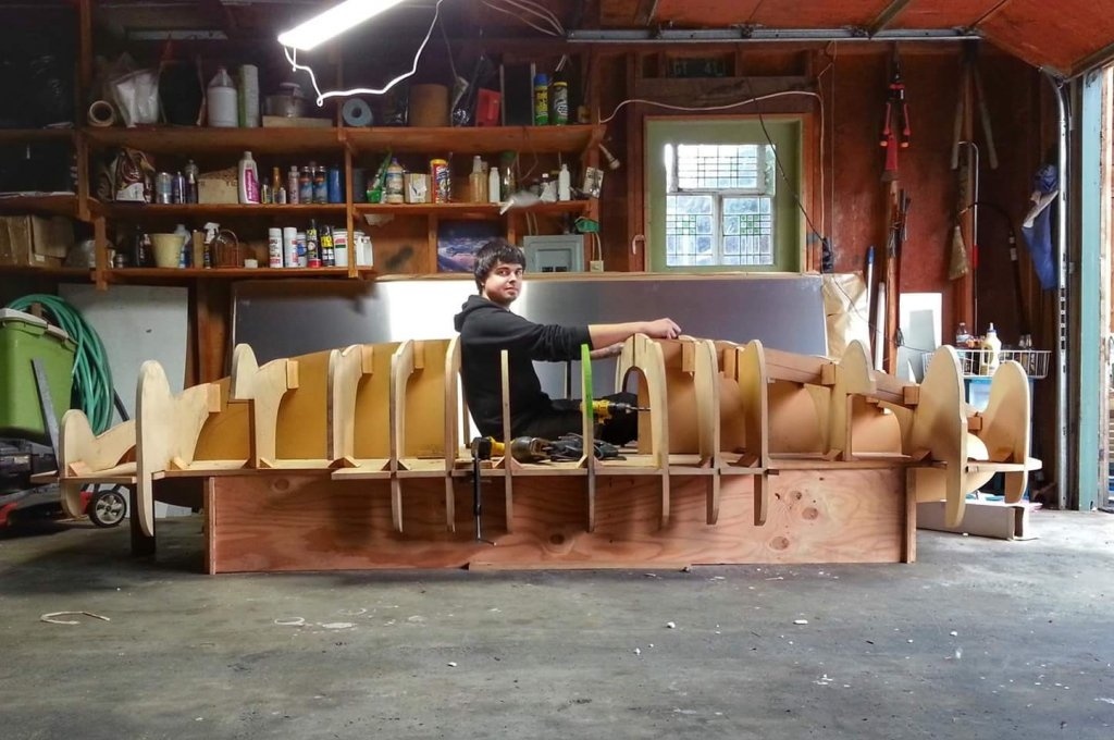

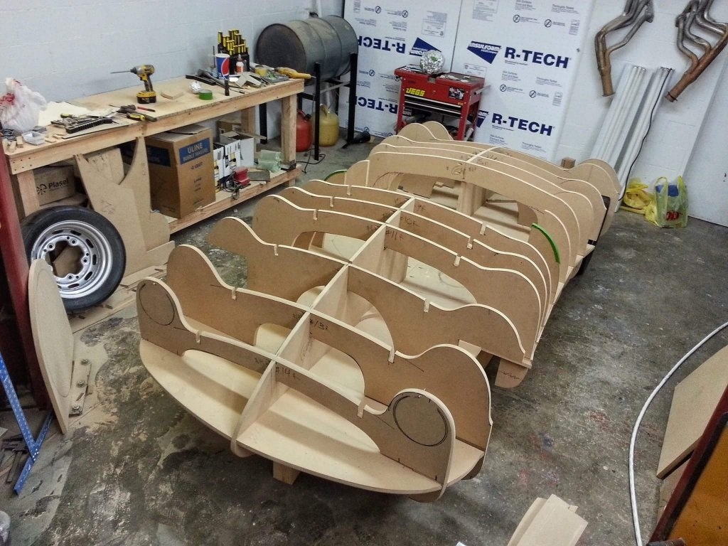

Started by shaping the buck at my shop, based on some scale drawings I did

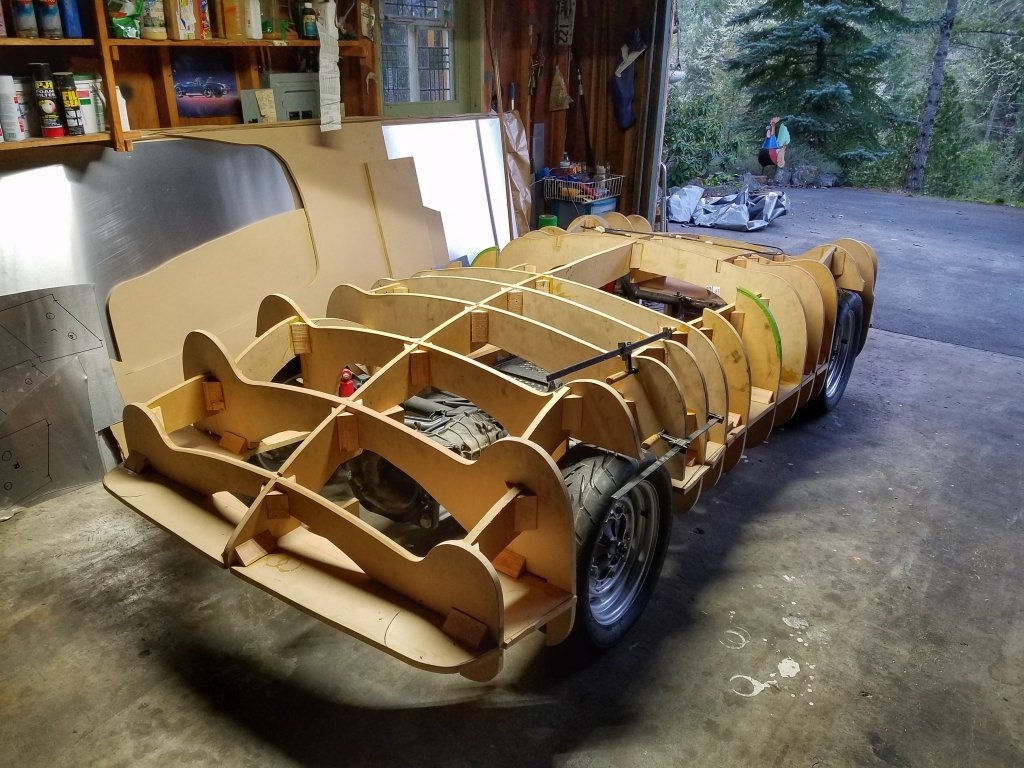

Then got moved over to Randy's and got the buck over the chassis, after narrowing it and shortening it haha. Lesson #1, always build the buck on the chassis
And now I'm shaping metal defining all my edges with 2" strip .063" aluminum broken to 90*

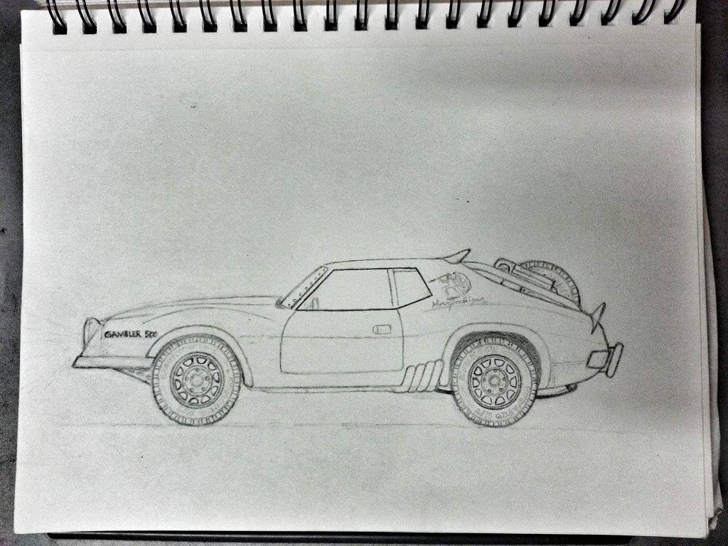

And there's one other car in the works I forgot to mention haha, a '72 Javelin dubbed "Harpoonigan" that's a project between me and two other friends as an ultra low-buck, mad max'd out rally car we'll be taking out on the OG Gambler 500 this July, possibly with Roadkill Magazine riding shotgun. And if you haven't heard about the Gambler, you need to! Haha
