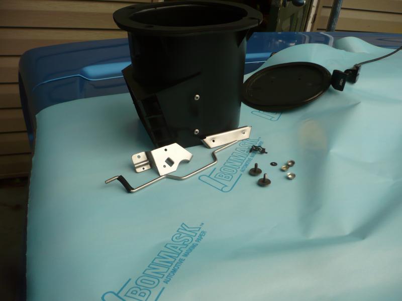

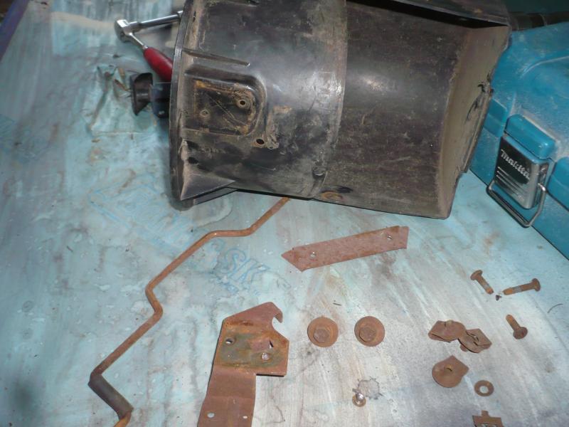

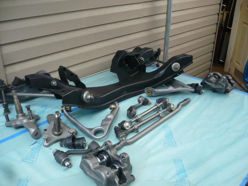

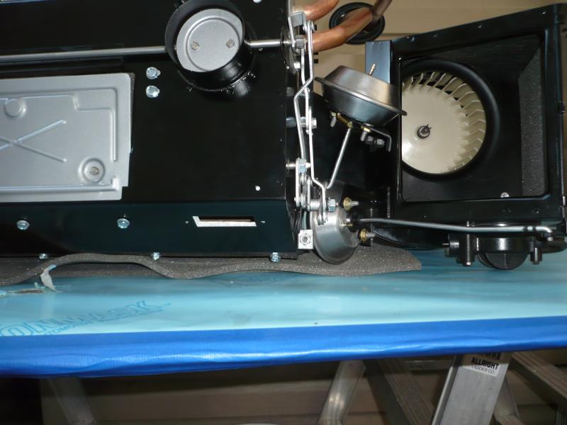

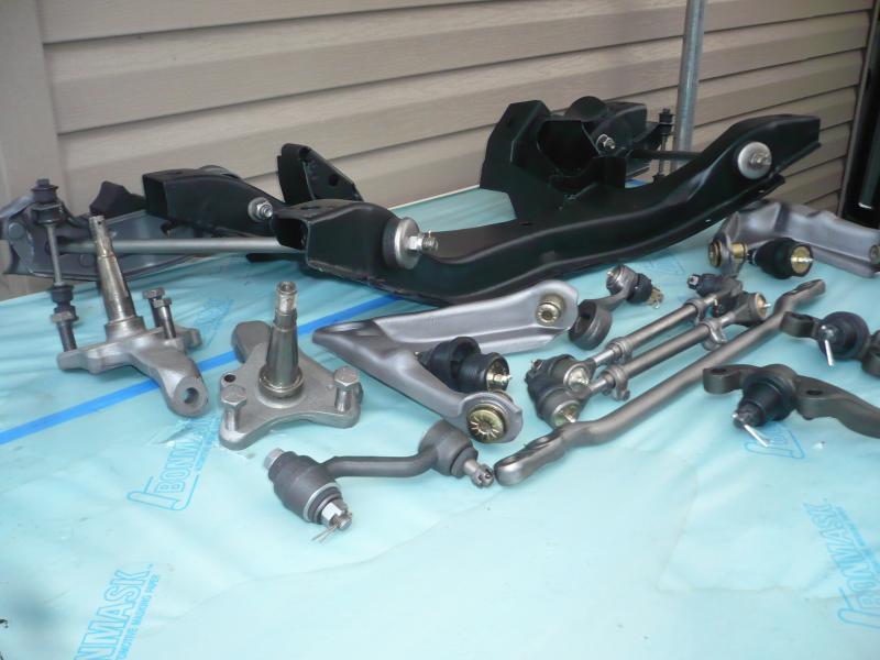

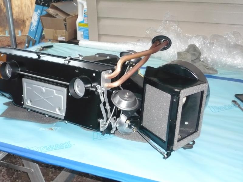

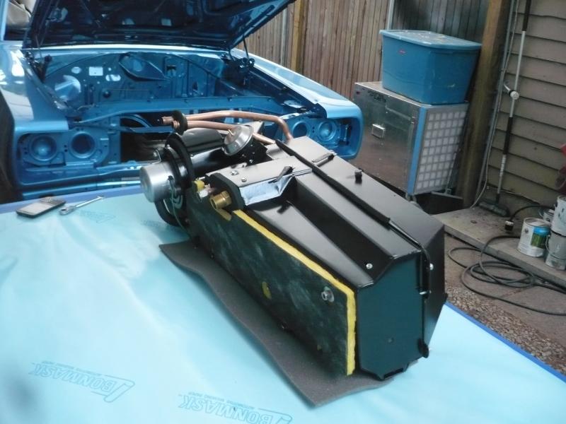

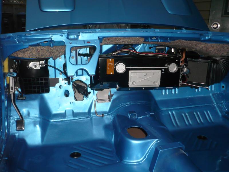

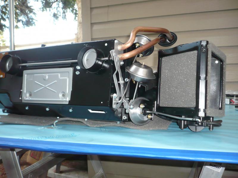

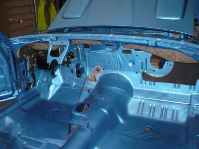

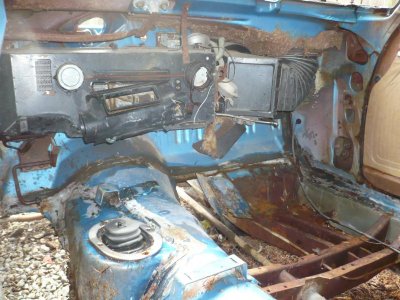

Well 8 months after i got it home i finally have time to get back on it. Finished AC heater box. ( Will never do again) And started getting front end going.

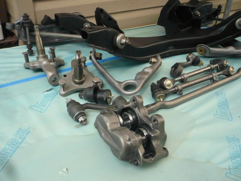

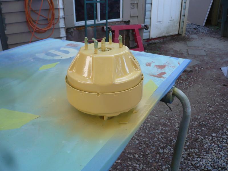

The vacuum pods were a bitch to get the proper look without painting them. Rag AC Done Finally 017.jpgRag AC Done Finally 023.jpgRag AC Done Finally 031.jpgRag AC Done Finally 035.jpgDB -5 & Rag suspention start 023.jpgDB -5 & Rag suspention start 028.jpgDB -5 & Rag suspention start 039.jpg

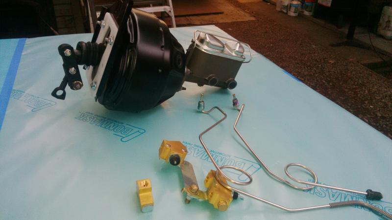

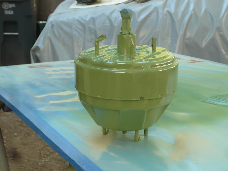

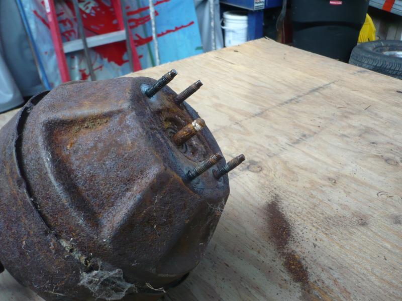

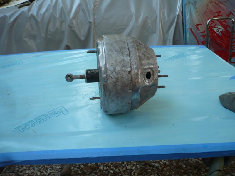

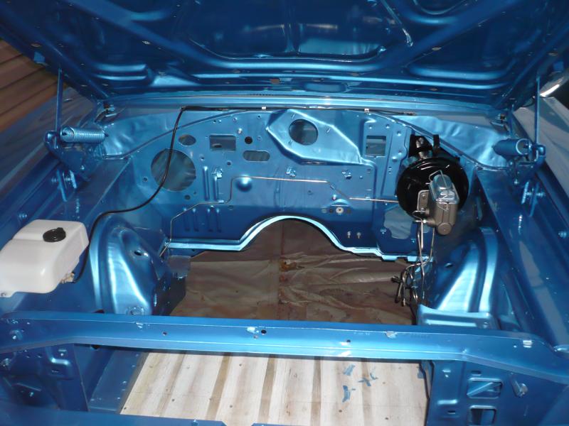

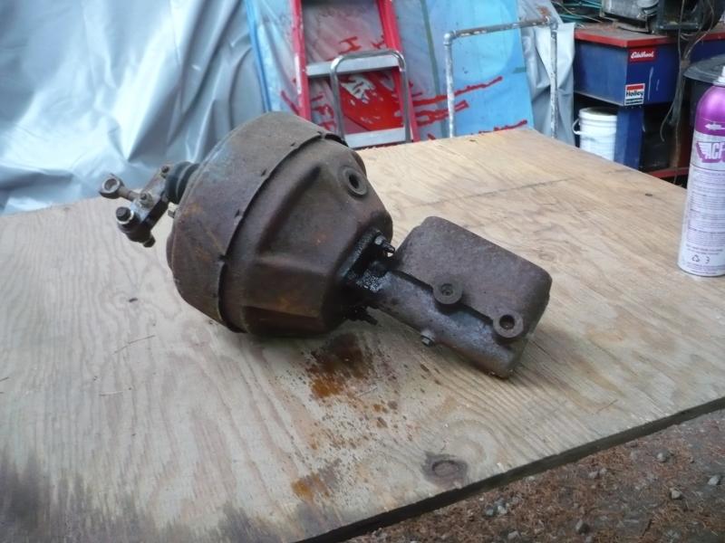

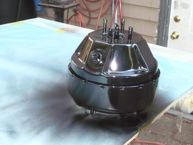

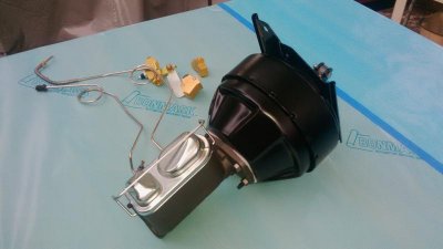

Going to start resto on the brake booster. Very ugly job.1969 Brake booster restore 001.jpg1969 Brake booster restore 005.jpg
Having seen what you did with the A/C heater box and front end kit....that brake booster should be a breeze. :headbang:

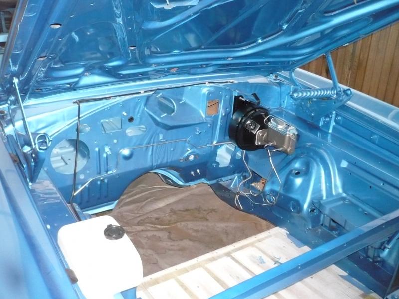

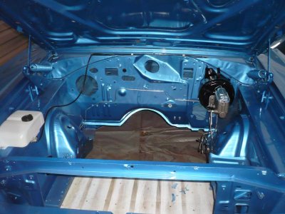

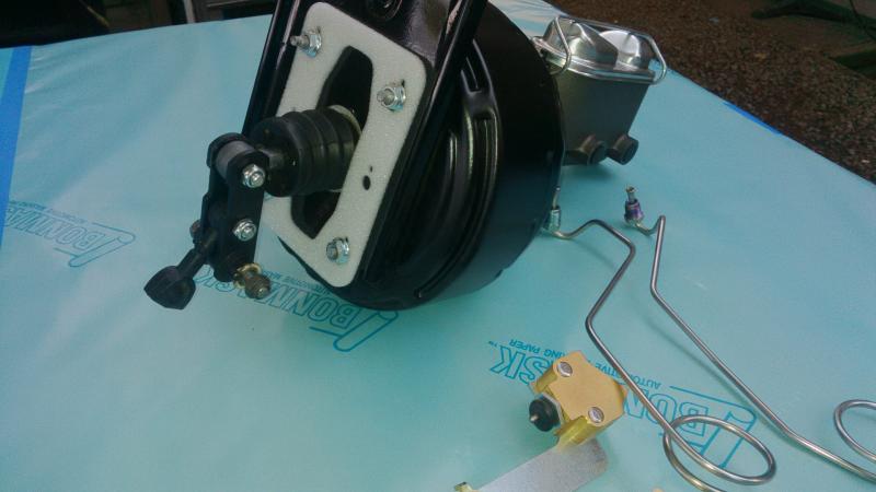

1969 Brake booster restore 030.jpgAaahhh. Epoxy prime. High build prime and sand and sand and sand. High build prime again and sand and sand and sand. ..1969 Brake booster restore 016.jpg1969 Brake booster restore 024.jpgDB -5 & Rag suspention start 006.jpg

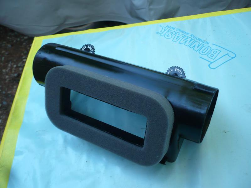

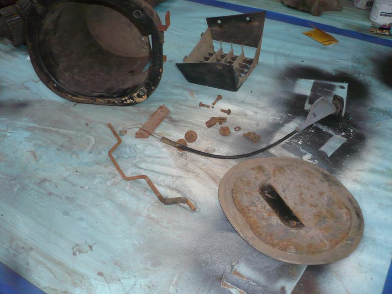

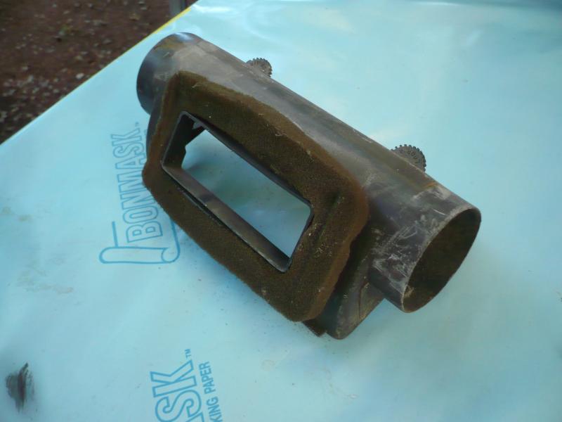

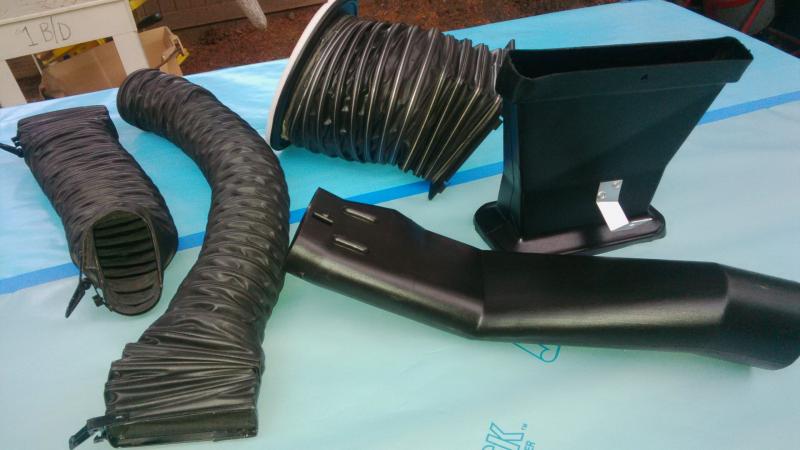

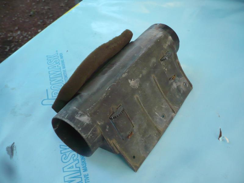

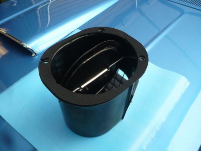

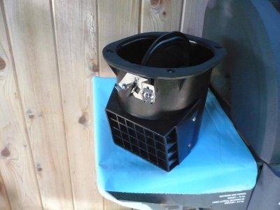

You know how many beers this took to complete..:icon_hang::icon_hang:fresh air box start 005.jpgfresh air box start 006.jpgAir box before assembly 007.jpgair box finished 003.jpgair box finished 010.jpg I took the slow road. No painting involved.. Am i stupid or what. Painting parts is faster.

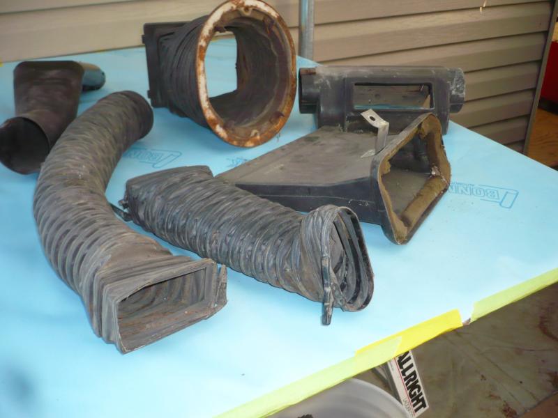

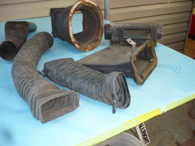

I think next time i buy a car done. This is taking along time to restore. I will be 90 before i can drive this. Good thing i have cold beer to keep me motivated.IMG_00000118-2.jpgIMG_00000119-1.jpgIMG_00000117-1.jpgAC air duct lines restore start 004.jpgair duct center done 006.jpgMore air duct resto done 020.jpgMore air duct resto done 021.jpgIMG_00000125-4.jpg

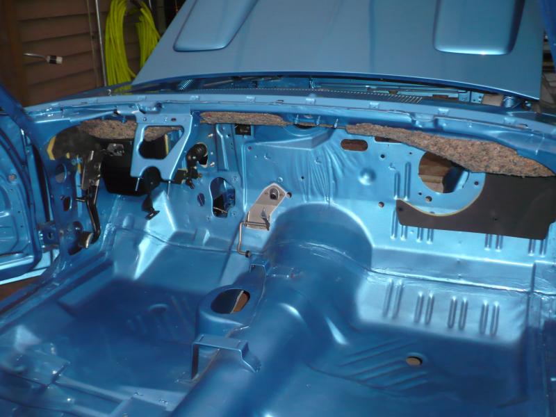

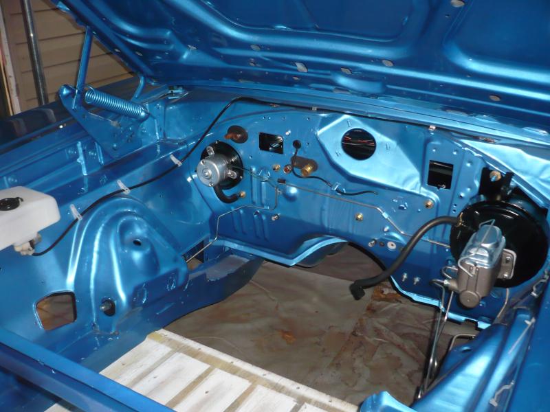

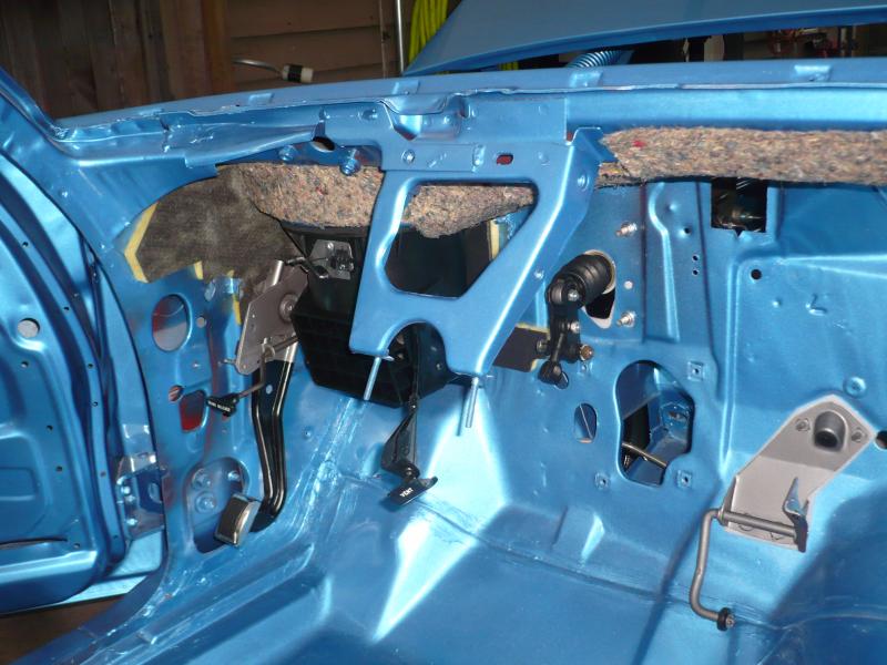

Rag under dash parts start 008.jpgFinally the fun stuff. Installing parts. This stuff keeps you motivated to keep going. Lots of people get half way on there projects and then let it sit and give up or have no time. Lots of cooled beer in the restore process works well..Rag under dash start 2 005.jpgRag under dash start 2 009.jpgRag under dash start 2 012.jpg
The first and last F N AC i will ever do. Pain in the *** to line everything up to install the AC box, then try to not scratch or chip any of the paint and parts. Here is some before and after pics.AC Box Installed 016.jpg500 rag july 3 2012 026.jpgAC Box Installed 021.jpg500 rag july 3 2012 015.jpg
Wow, great work. What products and technique do you use to restore your parts if you don't paint them? I'm intrigued.
Well in most cases i try not to repaint. Send stuff out to get replated like Cadiam, Zinc, things like that but bare steel i dont want to rust so all i can do is paint POR 15 bare steel paint. I try to keep it some what original but when you replace floor pans and other major parts, keeping things original after that is not that big of a deal. Those are big none original parts so to me its all open. But in the end if i can make look as close to original i will try.
