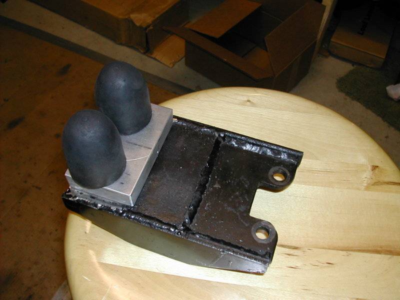

I ran my wife's 4 speed Challenger for a year. Hopped up small block with a completely stock drivetrain and suspension. It had wheel hop even on the street. An adjustable pinion snubber close to the floor allowed 5000 rpm starts with 9x28 slicks (12.50@110). At the end of the year upon inspection we found achipped a spider gear tooth and the stock axles twisted 1 spline. So before spending big $ on Cal Tracks (which do work very well) spend $20 and weld up a taller snubber.
Doug
Always have used stock springs with a snubber about a 1/4" from the floor. Never had a wheel hop issue.
