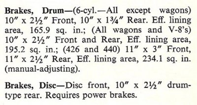

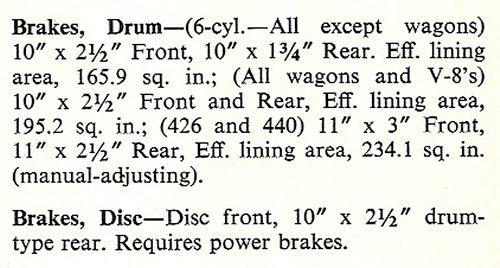

Thanks for the reply. I assumed they must have been swapped out at some point. I thought maybe there was a possibility that earlier cars may have had the 10" brakes OEM. It's an original Dana rear end. Not sure why someone would have gone through the headache of downgrading the brakes.

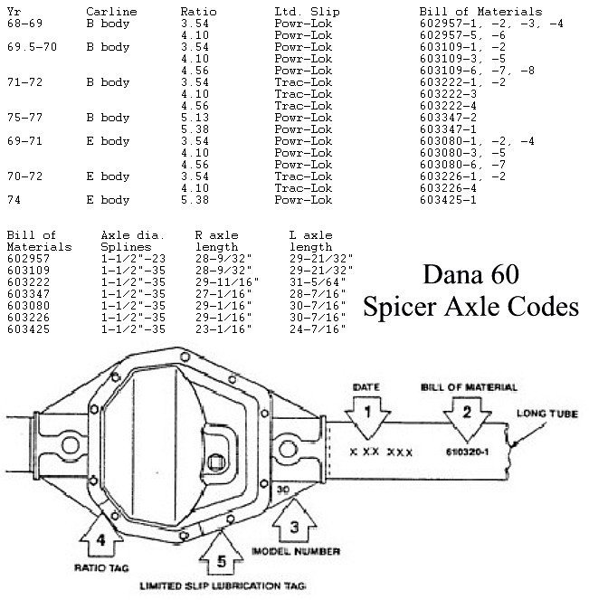

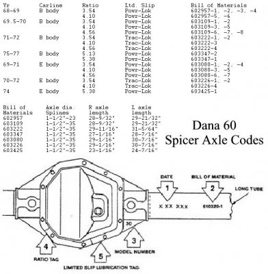

082 - 3.54 s/g, Dana 60, 11" rear & front drums, (A33 Pkg)
083 - 3.54 s/g, Dana 60, 10" rear drum - front disc, (A33 Pkg)
084 - 4.10 s/g, Dana 60, 10" rear drum - front disc, (A32/A34 Pkg)

Dana equipped cars with power disc brakes came with the 10" rear drums, sounds like your Dana came out of a power disc brake car. Is your car a 4 speed or automatic?. Jay Leno has a '70 Hemi/4 speed R/T Challenger that's Super Track Pack coded, (4.10 Dana, Disc brakes, heavy duty cooling etc.), but along the way one of the owners must have gotten tired of the 4.10's and swapped in a 3.54 equipped Dana....that had the 11" drums, that would have come out of a Drum brake Hemi or 440 4 speed E-body.
