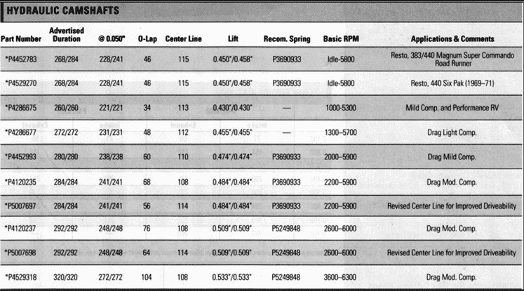

Is that the 292 .509 cam ? IMO, 2500 is not enough stall. Really needs 3500 +.
Do a compression test, that cam seems to like at least 11:1 or so, and if the cranking compression isn't above 180psi, not too snappy. As stated above, a bigger convertor will help in any case.

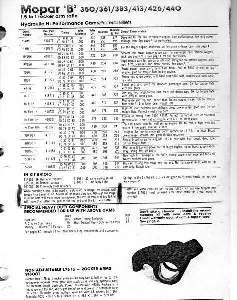

The 440 has one of the highest, if not the highest, rod/stroke ratios of any of the popular V8 engines. What that does is hurt low end power....but gives good top end power [ if the ports etc flow well enough ]. Sig Erson recognised the problem decades ago & put this note in his cam catalog. It is ONLY in the BB Mopar section, no other brand.

Chrys should have spoken to D. Vizard before revising their cams. To improve drivability, you reduce duration, you do NOT increase the LSA....which just turns a dog into a bigger dog.
