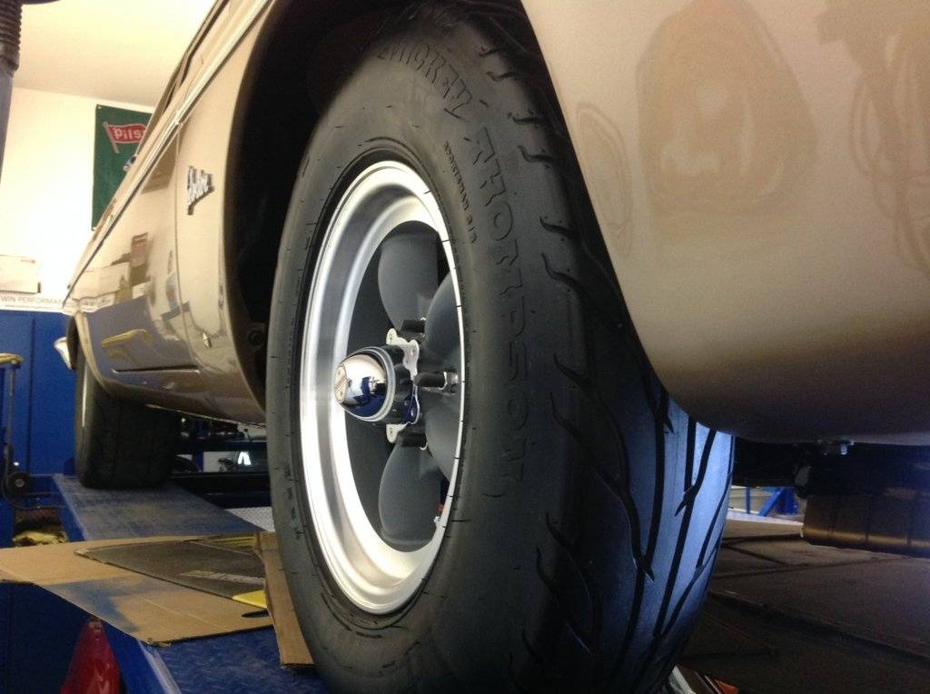

Malex, what front tire did you use on the Super Bee. I'm looking for a 28" tire for a 5" rim. Not really liking the tires I have up front.

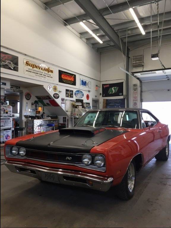

I was just over doing some work on the Super Bee today in fact. The front tires on the Bee are the Mickey Thompson SR. I believe that those are the 26" tall ones, but give the 28" ones some serious thought. Look up Mickey Thompson Sportsman S/R. 28X600 R15 LT. Those will fit a 5" rim and fill up the wheel well at the same time, although a 26" will also do the trick. Taller is just my preference and I have them on both my Plymouth and Camaro. I used to have the Sportsman non-radial on the front and those are a hard drive. Like taking a cow down the trail, wanders all over. The S/R is a nice drive.
I don't have any pics of the base plate, sorry, it's been 7 years since I did that. And hell, I might as well attach a picture or 2!
26" tall S/R on the front of the Bee.

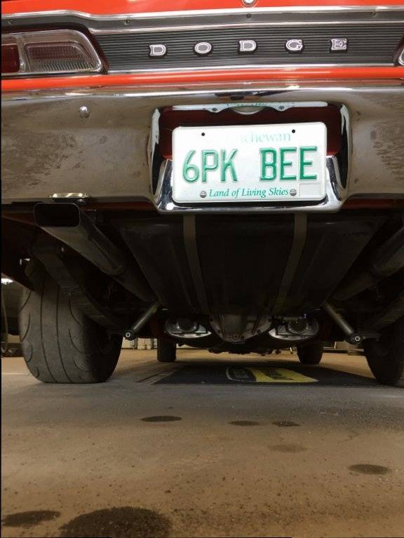

Just scooped a rear shot today. The tail light panel was the first one off the press at AMD.
Dana and SS springs.

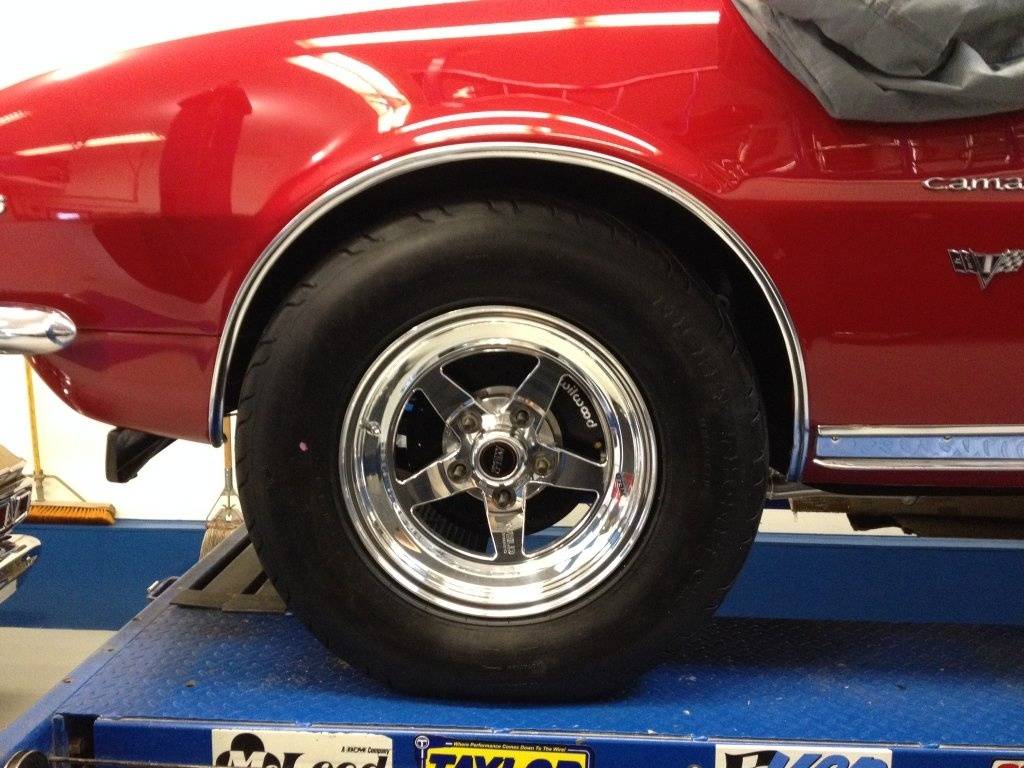

28X600's on my Camaro too, getting close but they fit.
Yes, that's what I'm after. I have the same set up you did. The 26s just don't look right to me. I'll be ordering the SRs! Thanks.

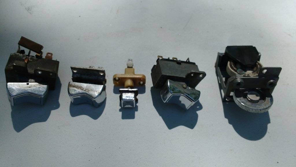

Got the switches out to clean up. Dash dimmer switch needed the most. Used a dremel with a wire wheel to clean up the contacts & such then a little electric grease to keep it clean. BTW where can I find the replacement rockers, I know I've seen them somewhere but couldn't find them last night. Mine the chrome is bubbling or flaking and want to replace them.

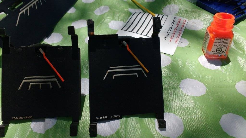

Got the speedo out and cleaned the face. Ordering the white decals for the increment markings on all gauges. Also painted the needles on them all.

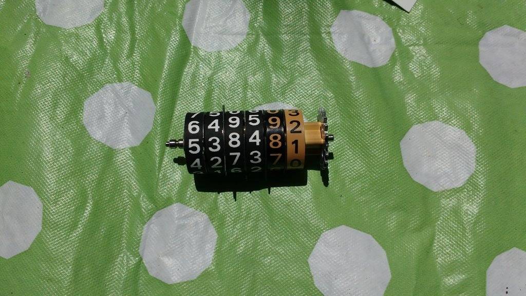

Put the decals on the odometer. It took me about 2 pieces to figure out the right tension to put on them to get the seems right. They give you extra numbers so that helps!
I think I'm going to reset my odometer to zero as I can't confirm the mileage, but I do have a picture of it for record.
