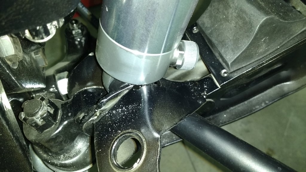

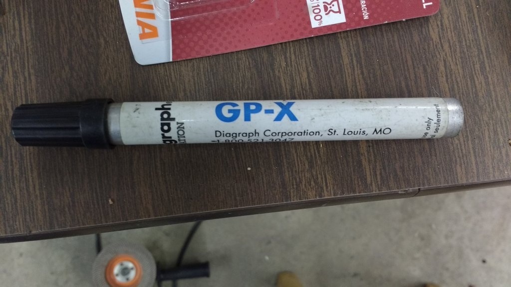

Got the shock on the pass. side, and clearance. These paint pens work great for touch up. Use them on bolts ect. that need a little touchup.

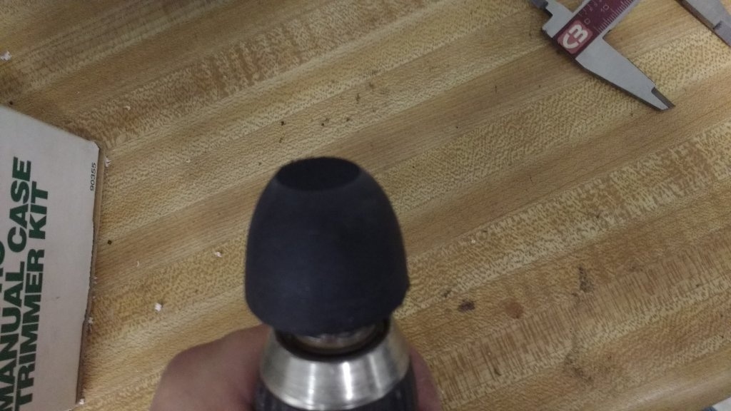

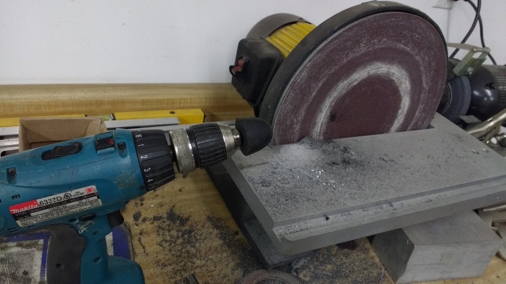

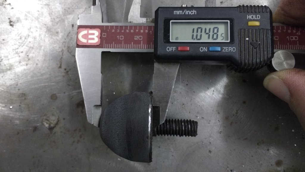

Going to take about .25 off the upper bumper to give me some more travel.
So I used a drill and disc sander to do this. I shortened it to the height I wanted, then put the same profile back on it. Also it put the profile on center with the bolt. You might be able to see how off center they were.

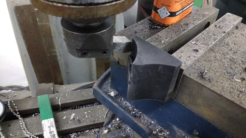

Used the mill & a fly cutter to do the lowers. Removed about .5" off the height on these. Gained me about 1.25 more travel, bumper to bumper with out any interference anywhere. This may be overkill but thought I'd try to get the max range of motion. The cal tracs recommends 5" of travel. I have a total of 6.5 now. So hopefully I can set it up with 3.5 of compression travel for street driving then lower in a little while racing at the track if I need to. Hopefully it'll hook good and I won't have to adjust it at the track.

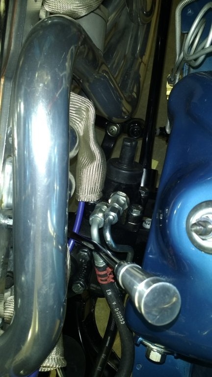

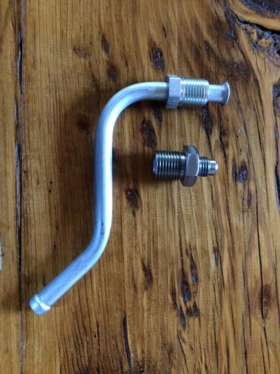

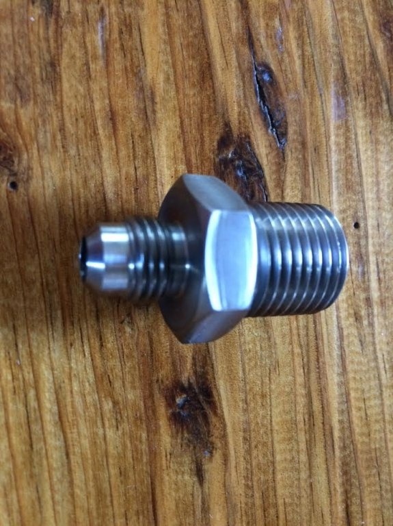

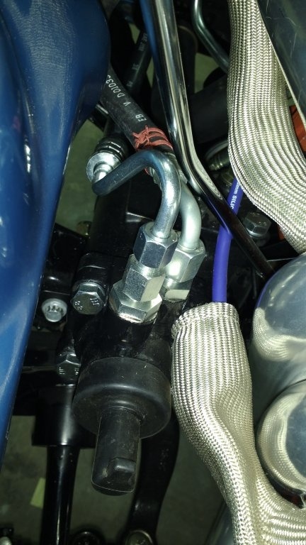

I wanted to see what my Borgeson steering box still had in it. These were the fittings that were in my box. It looks different than your fitting. I don't remember if I ordered the kit for mine. I would have to go back into my records to find it. I did not try the threads to find out if they are metric or not.
Yes those look like the same fittings I ordered from Summit. The OEM pressure line is a 5/16 line (#5) flare. Got that fitting now on order. I'm guessing they came up with a 16mm 1.5 flare nut for inverted flare on the return line.
BTW they are 37 degree flare.
Sometimes, as we all know restoring these old cars, we have to improvise on parts and pieces. I would've done the same thing as you did on your bump stops. Where did you get that GP-X touch up pen? Don't think I've ever seen that before. Is it just touch upaint? I really didn't think of using something like that for touching up nuts/bolts because I was just going to use paint and a brush. Guess I'm experiencing a brain fart. Just curious

I got mine figured out now. So if you want to run a factory PS line let me know and I'll send you the 6 to 5 flare fitting to go to the OEM line. I'm not sure what they charge for their pressure hose but you could compare it and see. I think my line was about 30$.
Glad you got it figured. When I get to the PS I will probably be asking you questions. Thanks.

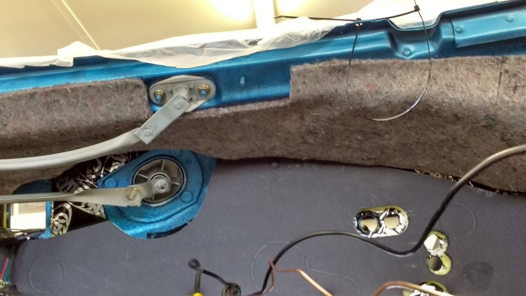

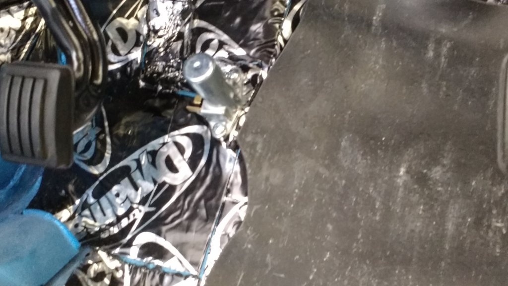

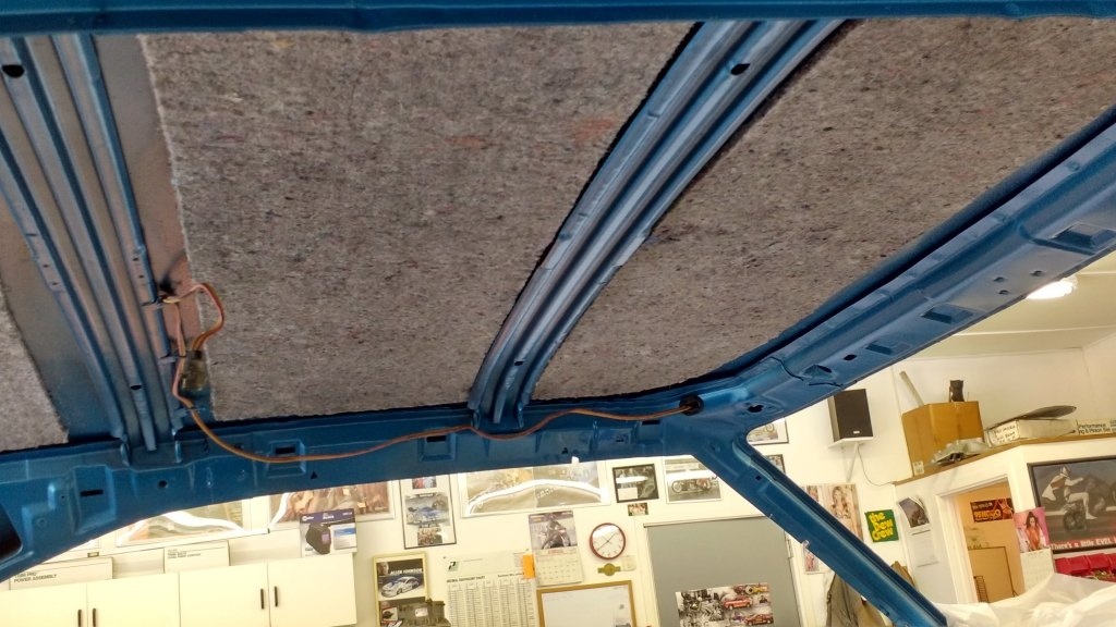

Got the dimmer switch in, dome harness, and jute glued in.
I didn't glue the jute in the rear package tray as I wasn't sure if was installed on top or bottom. Mopar74 let me know it was on top, so I don't think I'll glue it for now.
