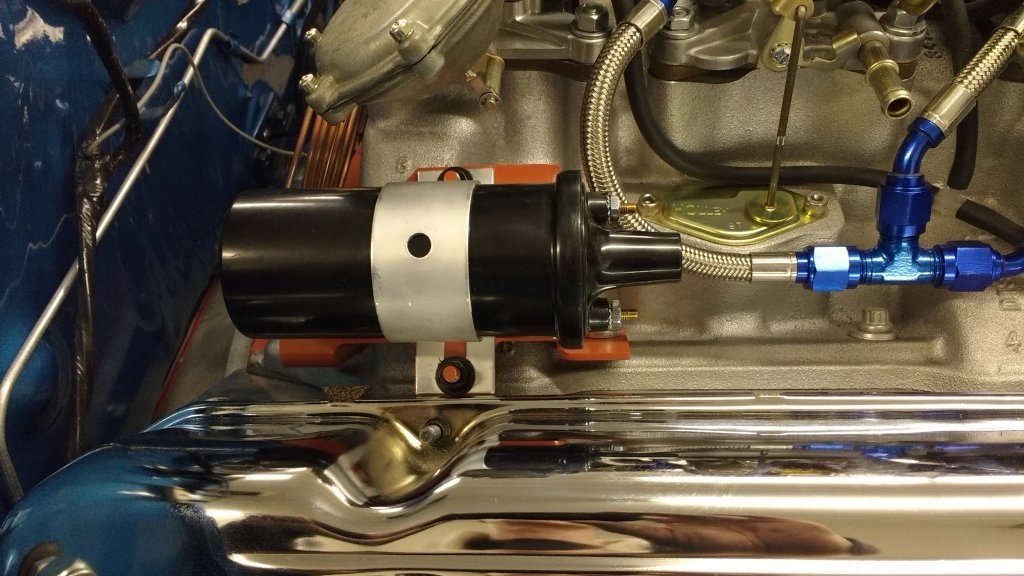

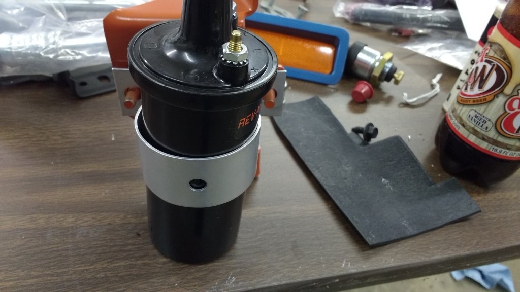

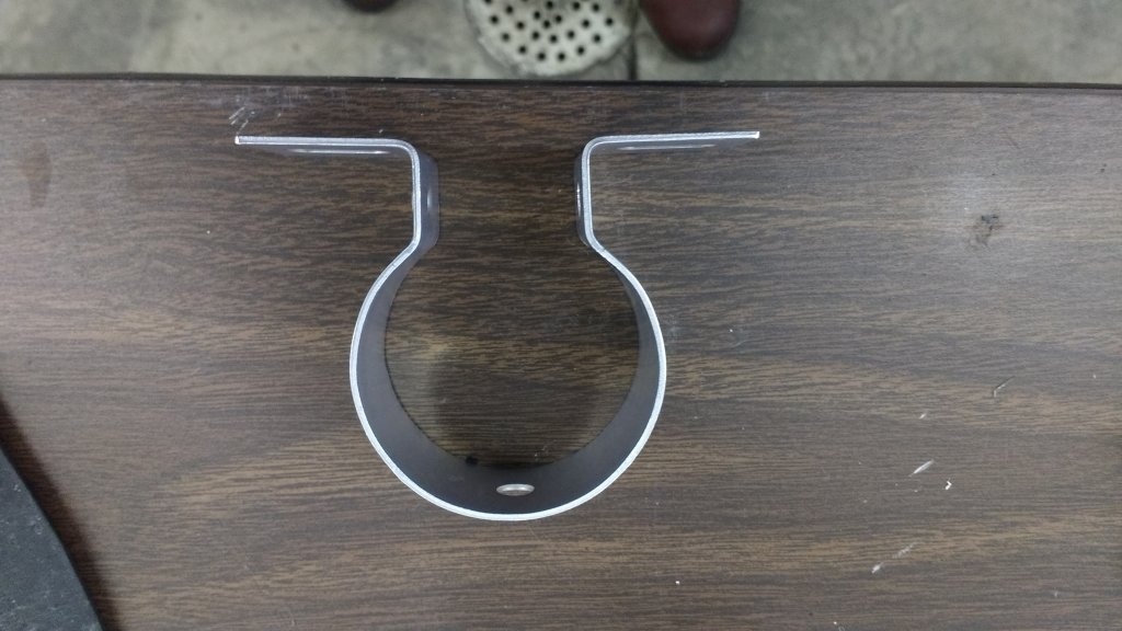

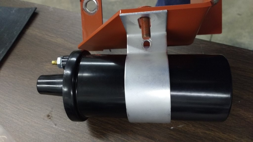

Had just a little time this weekend so I thought I'd at least get a little done. Funny how a 10 minute job turns into a hour or more. Case in point. I got my coil bracket so I figured I'd get it on real quick. Wrong!
So I slip the coil in, tighten it down then go to put it on the bracket and the holes are not far enough a part to get on the mounting bracket. You can't get at the tension screw with the bracket on the mount. So I removed it from the intake.

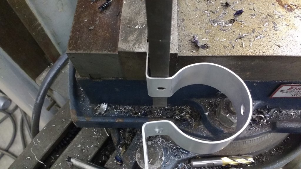

As you can see with the bracket loose enough for the slots to fit over the studs the bracket is way to loose.
I stuck it in the vise to rebend the angles at the top of the parallel sides.

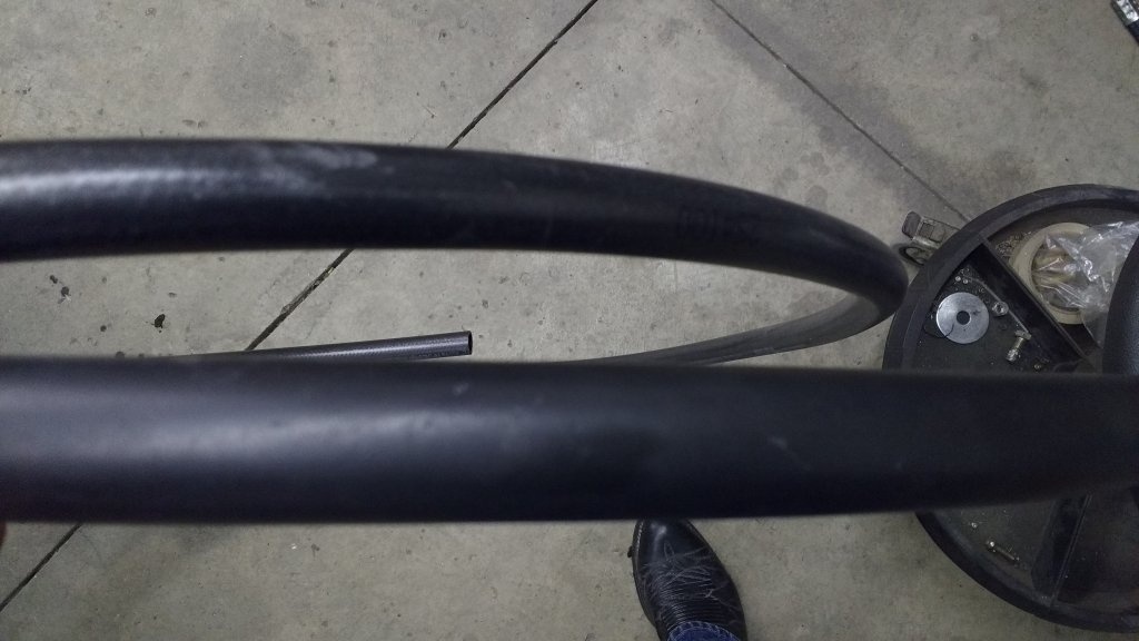

Here is an example of the difference in std AC hose & the reduced barrier hose. Got the hose & fittings but I goofed on 2 of them so need to order a couple more today.
I don't think that I have had any replacement part, that I have ordered, fit without custom fitting.

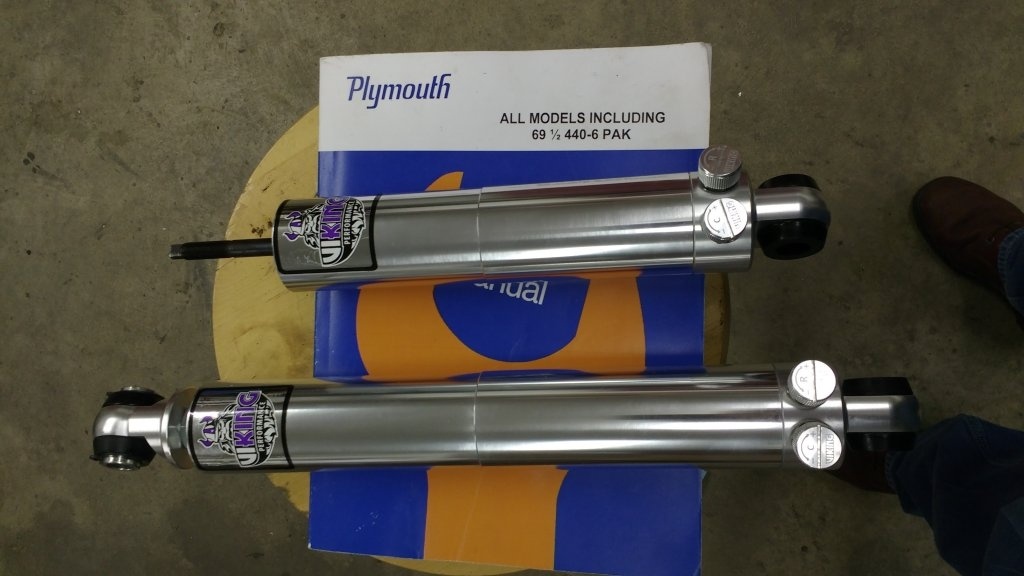

Got my Viking shocks from PST yesterday. Can't wait to get them on! Should be super easy to adjust.
Th way stuff is made anymore? don't count ur chickens before they hatch!
True, but at least they're easier than the comp engineering ones!

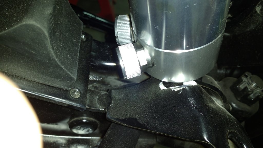

Installed one of the front shocks to check fit. I gad to clearance the front sway bar bracket just about a 1/8". not much. I'll clean it up with a file then touch it up with paint. I installed it with the knobs to the inside so I could see them better.
