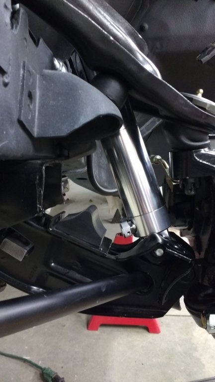

Installed I measured for length of travel, 6" from unsprung to the bumper just touching the pad.
View attachment 412933 How's this old bee?

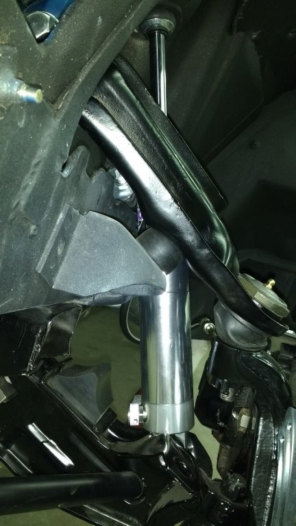

Cutting 1/2" off the bumper is no big deal, what would you need to lower it at the track for?View attachment 412805
I was wondering if there would be any harm in taking .5" of material off the compression bumper on the LCA. I'm thinking I'll get it aligned with 3" of compression travel at the wheel and then lower it 1.5" at the track. Does that sound safe feasible? BTW make sure you don't forget to clear the splash guard on the rotor when lifting. Don't ask why I bring this up.![]()
