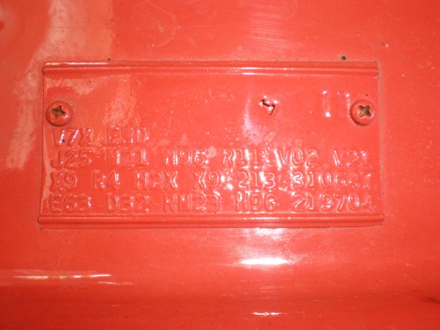

my fender tag is coded for a side stripe I have just never known what stripe it is .
V7X Accent stripes longitudinal paint black
V21 Hood performance stripes
V02 Paint two tone
Spring special packages would have the double wide stripe as part of that package. code would be a-14 with a vinyl top or a-15 with out the vinyl top. Package included hood performance stripes, magnum 500 rims, body belt moldings, and I think a sure grip but not sure on that.
V02 Paint two tone

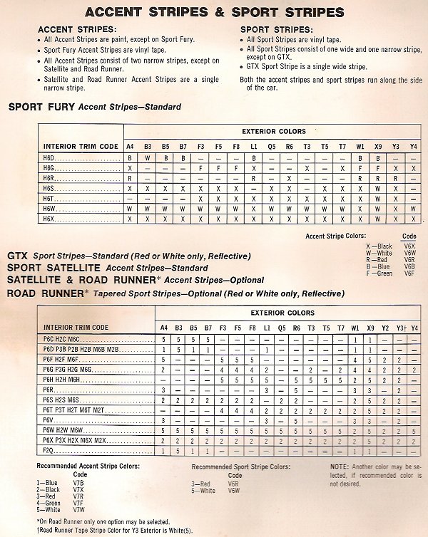

V7* is a accent stripe, this was a 1/8 painted siingle stripe, while the others were V6* or V8*. The * decodes the color of the stripe, popular ones are X=black, W=white, R=red
There were only 2 Pinstripe TAPE colors offered from Chrysler on the 69 RR
Both were REFLECTIVE, code V6W was the White Reflective dual sport stripe color and V6R was the Red Reflective. Black was NOT offered from Chrysler, only from the aftermarket stripe cutters.
I have a question after reading your fender tag. Was your car painted R4 Red lower body with a Black painted roof? X9? as indicated by the v02 code. I have a seen lot of tags and never seen a 69 RR with this combo?

There were reflective, V6*, and non reflective, V8#, tape on stripes avalible. Both are in the dealer handbook with white, black and red offered. I guess it's possible some were added at the dealer but they were offered on new 69's
Accent stripes, V7*, were 1/8 painted on.

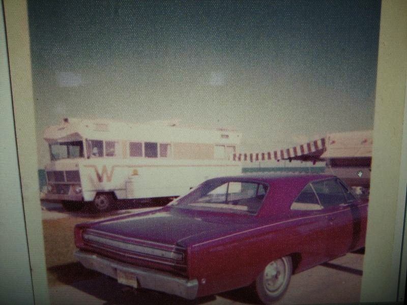

Here's a pic of my 68 in 1973 with the org accent stripe.

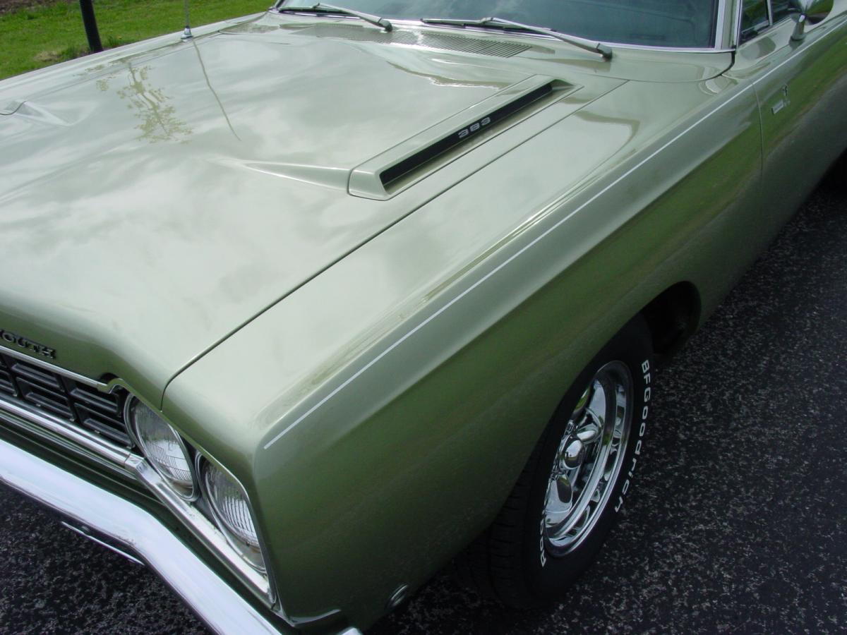

Here are some pic's of another members car @ another site. The org accent stripe on my car was 1" below the body line and followed the body line all the way back at the 1" below. This member stated the same about his car when we had talked.
