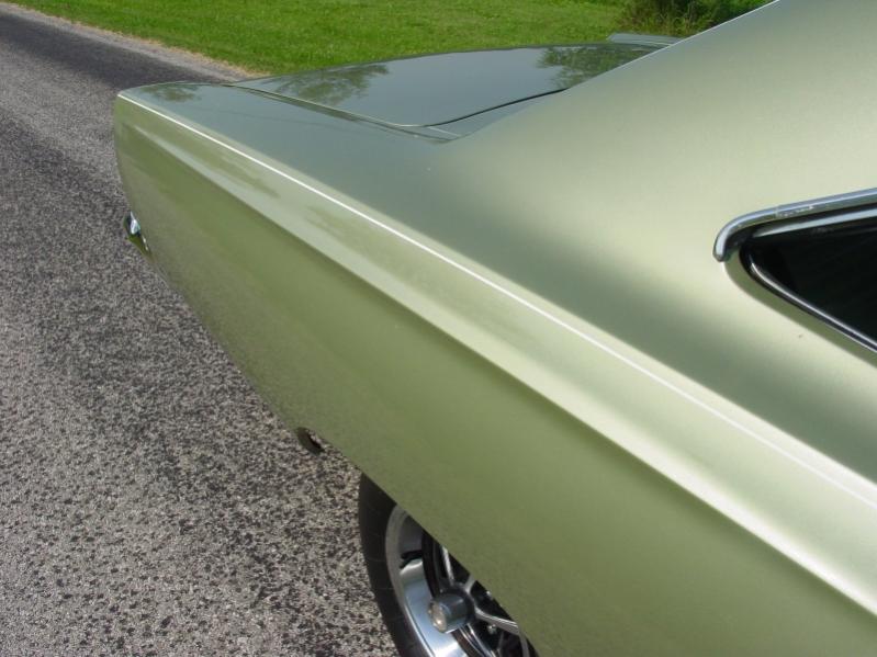

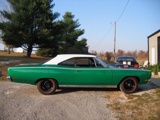

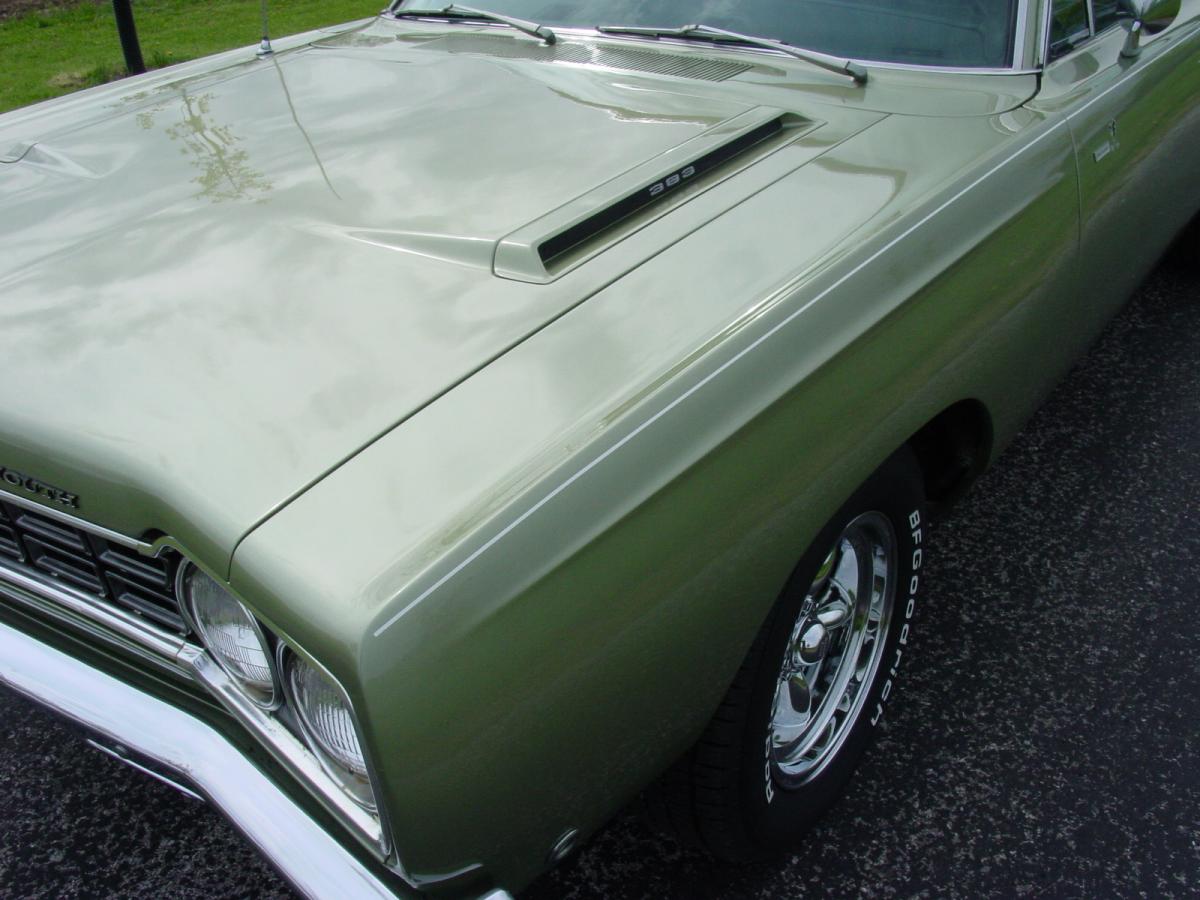

Here are some pic's of another members car @ another site. The org accent stripe on my car was 1" below the body line and followed the body line all the way back at the 1" below. This member stated the same about his car when we had talked.
Thats 7W I beleive, my A12 has that but 7X (Black) Cool lookin stripe!

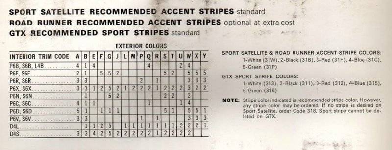

There were reflective, V6*, and non reflective, V8#, tape on stripes avalible. Both are in the dealer handbook with white, black and red offered. I guess it's possible some were added at the dealer but they were offered on new 69's
Accent stripes, V7*, were 1/8 painted on.

There were only 2 Pinstripe TAPE colors offered from Chrysler on the 69 RR
Both were REFLECTIVE, code V6W was the White Reflective dual sport stripe color and V6R was the Red Reflective. Black was NOT offered from Chrysler, only from the aftermarket stripe cutters.

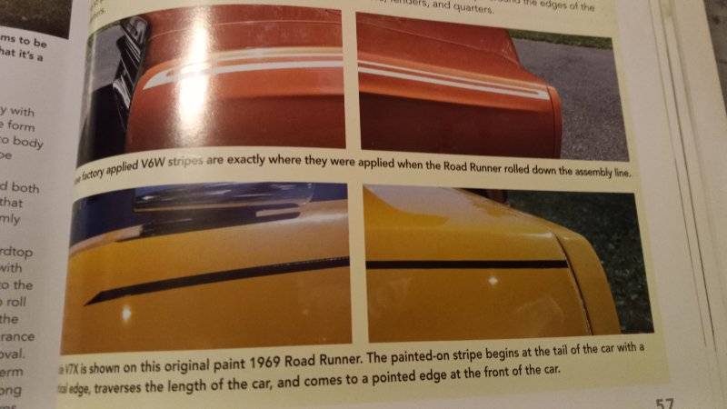

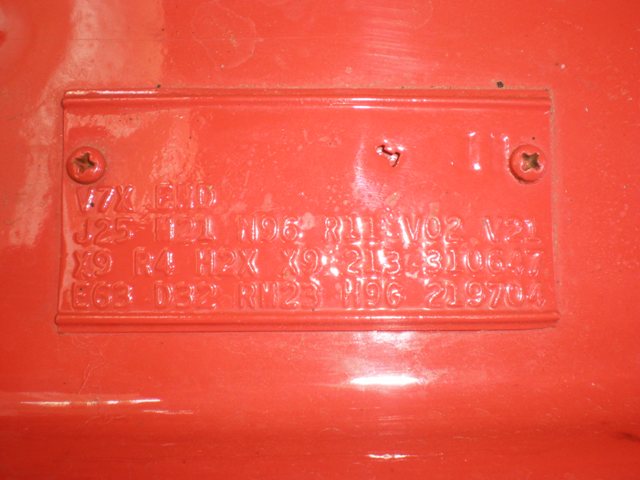

V7X code would have been a Black painted upper body pinstripe option
What is 7X ?
V7* is a accent stripe, this was a 1/8 painted siingle stripe, while the others were V6* or V8*. The * decodes the color of the stripe, popular ones are X=black, W=white, R=red
What is 7X on a Plymouth A12 tag? Govier said it was a Longitudal black pinsteipe. But who knows 30/40 yrs later. Poor guy
V6# is the reflective tape dual stripe, red or white only. V7# is a single painted-on stripe, painted on with rollers at the factory (beugler tool?)
It looks just like the 68 above, follows the fender/door line, at about where the bottom spear of the dual tape stripe would be. Could be black, red, white, blue, or green.
