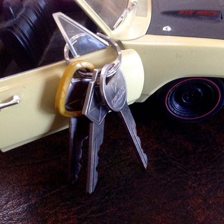

In the meantime, the key will turn if you find the sweet spot. My Sport Satellite did this for years. Put a little "English" on it. In my case, it was gently angle lift to the 1 o'clock position before turning.
new switches are not expensive.it is over 40 years old i would replace any old parts i could with new if i could.
Johnny, a couple of other things to consider here with the OP's original problem. First, the "Key won't turn" problem the OP has seems to indicate the fault is within the "Ignition Key Cylinder" not the switch. These are two separate components, and purchasing a "new switch" does NOT include an "Ignition Key Cylinder" with it. So then, if you purchase a new "Ignition Key Cylinder" to replace your original while keeping the original "switch", you then will have "Different Keys" for your "New Ignition" while your original door key cylinders use the "old" key. This situation is exactly what I was faced with on my car. I did not want two different keys plus a third one for the trunk to be able to operate my car. So that, along with my desire to maintain originality whenever possible led to repairing the original key cylinder. Just something else to consider in this particular instance.
Agreed. I have the 3 key circumstance for years due to a replaced ignition.
