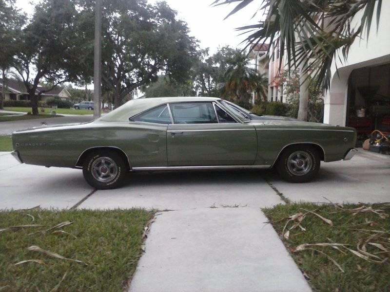

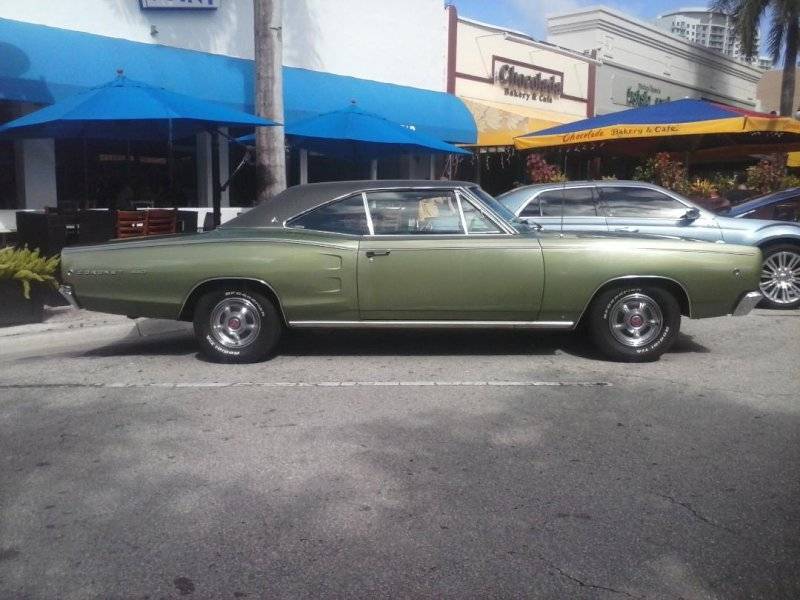

For a stockish ride , I also would go with the 6 leaf HD leaf springs. The ride is comfortable with those. That's what I put on my 68 Coronet back in 2004. Those springs will pick up the rear about 2 inches. These brought back the ride height back to the same height as when the car was new. I think you will like these springs. I bought these from ESPO Springs & Things.
