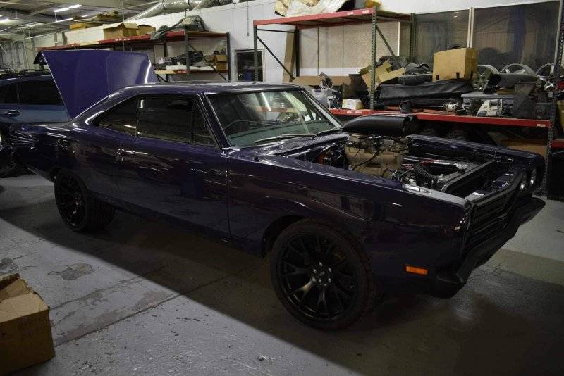

Hello all,
Spent the last 3 years building a 69 roadrunner. Thought I would finally drive the car today and sure enough it stalls out when shifting into gear.
To give a lil back story, I bought a straight body and it came with a 440 and 727. I thought it would be a simple task of putting the motor and trans in, getting some interior restored and voila. Well 3 years later and several tens of thousands of dollars later I'm still getting my heartbroken daily by this thing lol.
Now, the car. I made some slight upgrades to the motor.
COMP Cams Thumpr Hydraulic Flat Tappet Cam and Lifter Kits CL21-602-5​
And its running a dual carb Holley 4150 sniper setup
Electric fuel pump
Holley 12-879 regulator (set at 60psi)
Not sure about the current torque converter but I'm thinking that it may not like the cam.
I have a brand new Hughes Street Master 24-25 but I REALLLLLY don't want to have to drop the tranny and put it on.
Lastly, if transmission fluid is low could that be a potential cause?

BTW Cool Shot, car looks Badass..

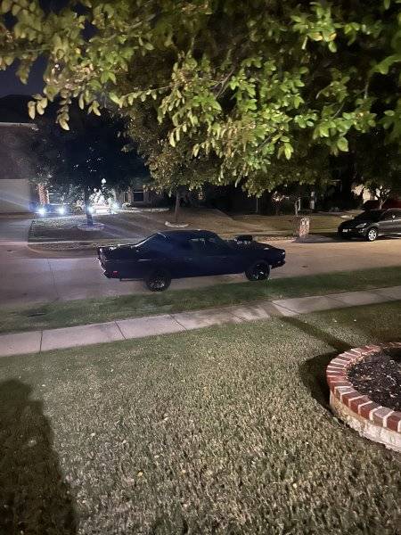

Update: Still can’t get the IAC situation where I want it but I also believe the timing might be a hair off. Drove the car for the first time today even though it was only to get the car off the street and into the driveway. That’s a MAJOR milestone and appreciate all of the incredible input from the community. Beyond grateful as all of these comments helped me in some way shape or form

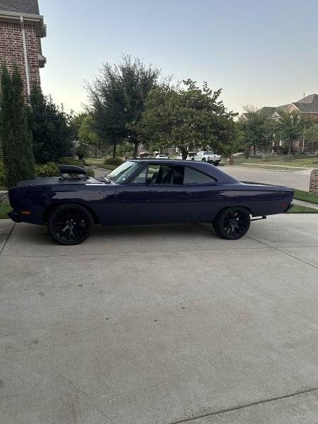

Update: I've got the car running and driving but having an issue dialing in on the proper timing to alleviate it running rich and pinging in the pipes.
440.
Edelbrock RPM Performer Heads
CompCams Xtreme Energy 224/230 Hydraulic Flat Cam
Holley Sniper Dual Quad Sniper
Holley Hyperspark Kit (distributor, ignition box, ignition coil)
Powermaster Onewire Alternator 165 amp 8-58529
I'm soooooooo close but just can't quite find the sweet spot on the distributor.
I have initial timing at 15degrees as most people have requested but its still running lean.
