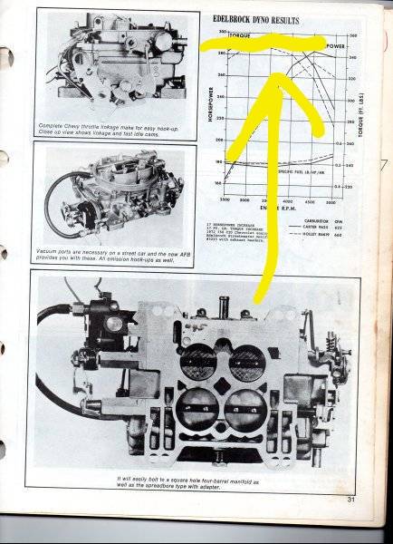

the same single dyno test from whenever performed by whoever (perhaps with an agenda, perhaps not),
So the test could have been done during or after Edelbrock had started negotiations with Carter on a licencing agreement or similar regarding their carburetors and the dyno test could have been a marketing exercise?66 Sat,
I don't know when the test was done. Obviously after 1972.....
