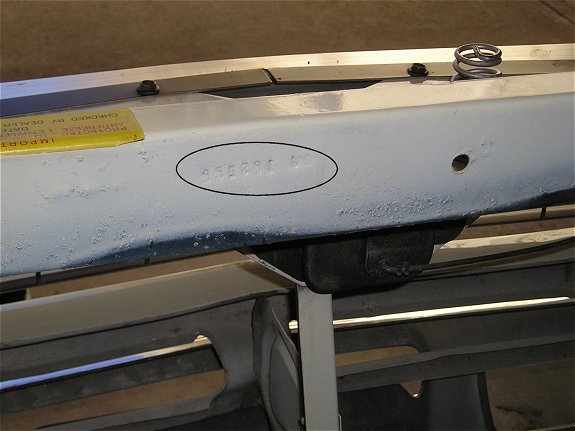

Where about's on the radiator support is the vin stamp? mine engine bay was painted black. Before i acquired it and i don't know where about's to look.

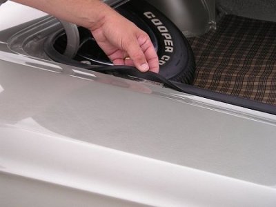

I don't want to sound stupid but I just purchased a 69 bee, it does have the fender tag but where is the number on the trunk rail? The rubber is in good shape so I don't want to pull it all off.
Approximately here

My 69 STL built car is here. Different plants put it either on the back of the support or on the top. Either way, it should be about in this location.
This would be from the inside of the engine compartment looking out over the grille.

my 69 st louis cars and 70 st louis cars are stamped in the exact same spot on the face of the upper core support but my lynch road car is on the top

Yep. Different plants used different specific locations. There are lots of variations in the Mopar world.
