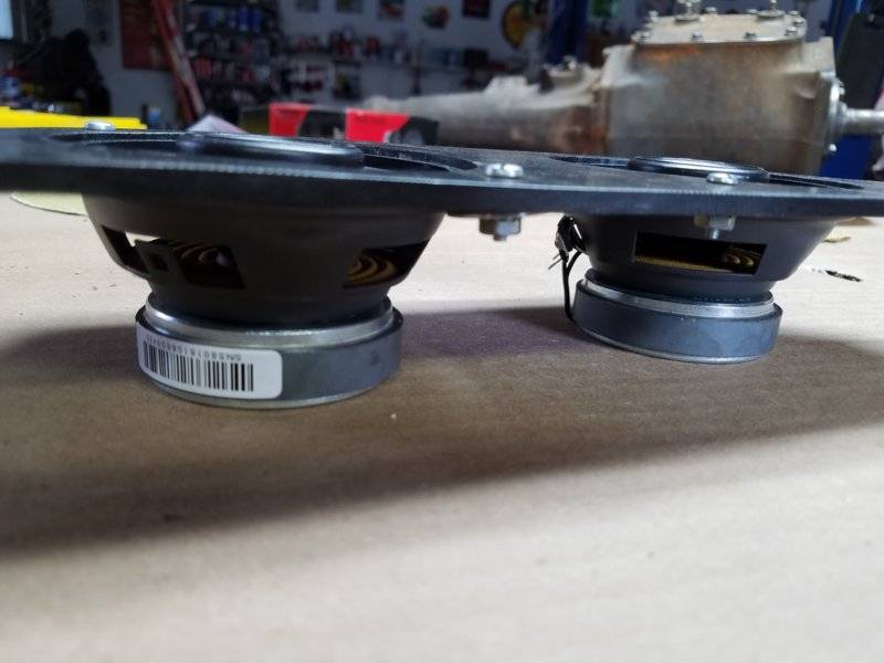

Made a bracket to hold 2 - 3.5" speakers out of Plexiglas and painted it black.

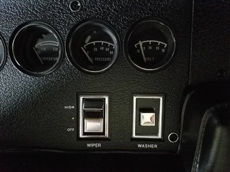

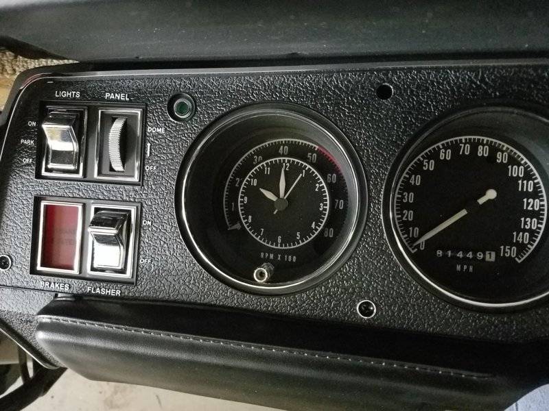

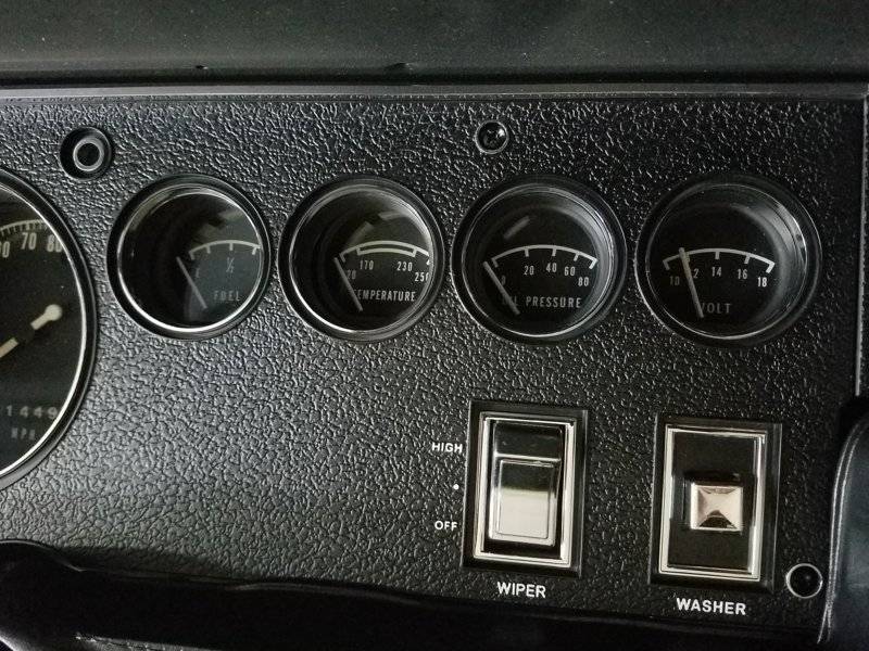

I have been using Shannon at Redline Gauge Works for the past 3 cars I've done and been happy with the results. The one thing that always bothered me though was on a amp to volt meter conversion, 12 volts on the scale was always straight up and when the car is running the needle is way to the right. So he told me it is no big deal to modify things and put the 14 straight up. I like this a lot better. Of course I am the only person who has ever asked for this modification.
View attachment 867628 View attachment 867629 View attachment 867630
I like that better too! I asked him about that a few years ago when he did mine. I don't recall exactly what he said about it but was not doing it at the time. Guess he got it done now. I'm gonna send mine back for an upgrade. Thanks for the heads up.
Better pic of the volt gauge. Didn't mean to create any more work for you Ed....

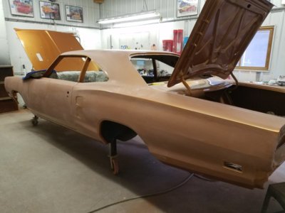

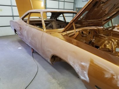

Stopped over to help him get the finished decklid and hood bolted onto the car. I always have a hard time looking at the cut/buff process after seeing a car freshly painted.

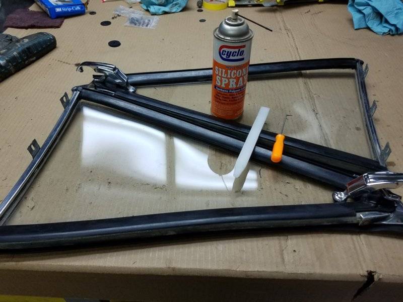

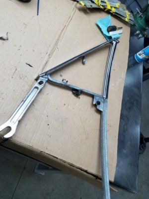

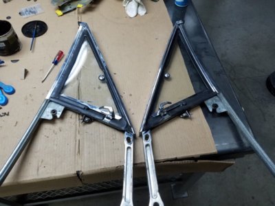

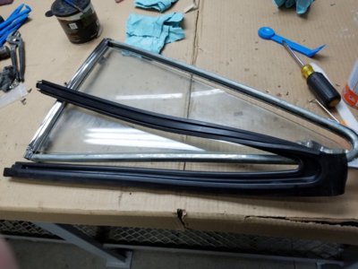

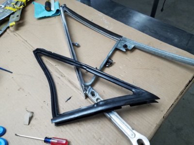

Bought new gaskets from Detroit Muscle Technology for the vent wing windows and rear pop out quarter glass. Cleaned and polished up everything. I think they turned out great for 50 year old parts that spent all their life outside. Three item that make this job easy are silicone spray, a windshield installer tool, and a small 90* pick.

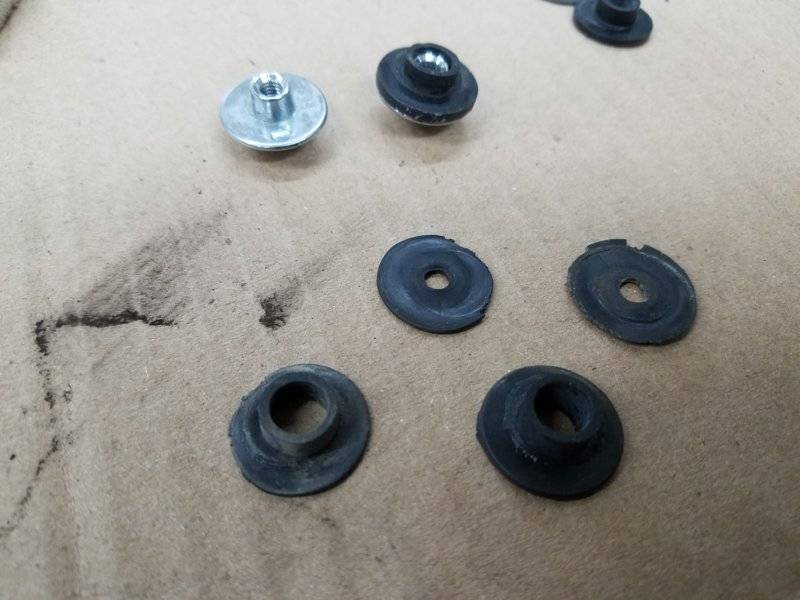

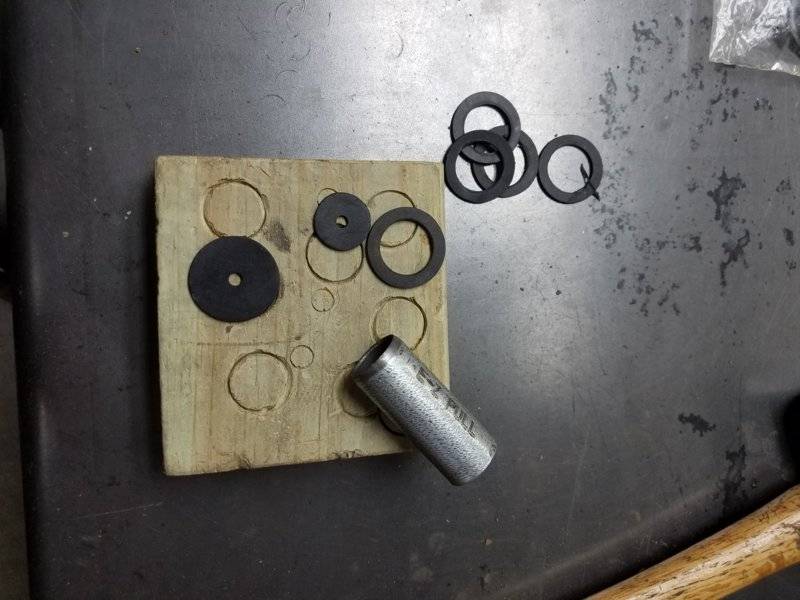

One thing I did find out is that both the flat washers and black pivot bushings are not reproduced or available anywhere. I am still on the hunt for a couple nicer bushings, but for now reused my originals. For the flat washers I picked up some made from neoprene at our local Ace Hardware. Found some with the correct center hole, but the were to big diameter. Made a punch from a piece of 3/4" emt conduit. Put in some new stainless screws and called it a day.
