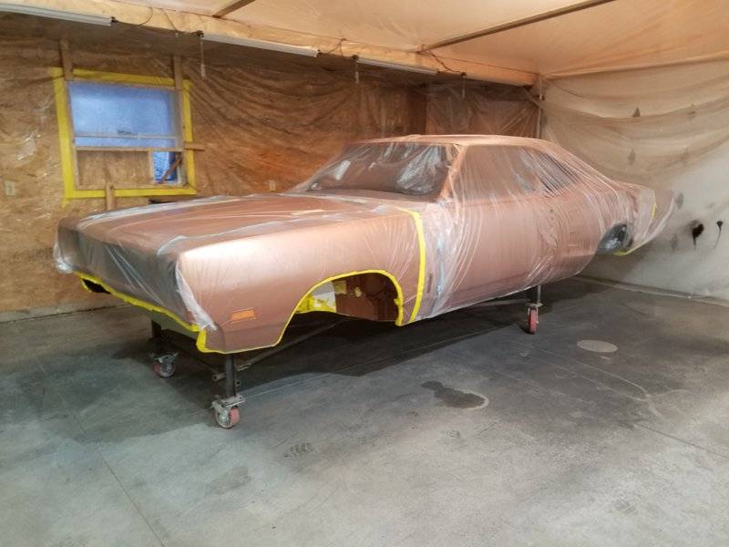

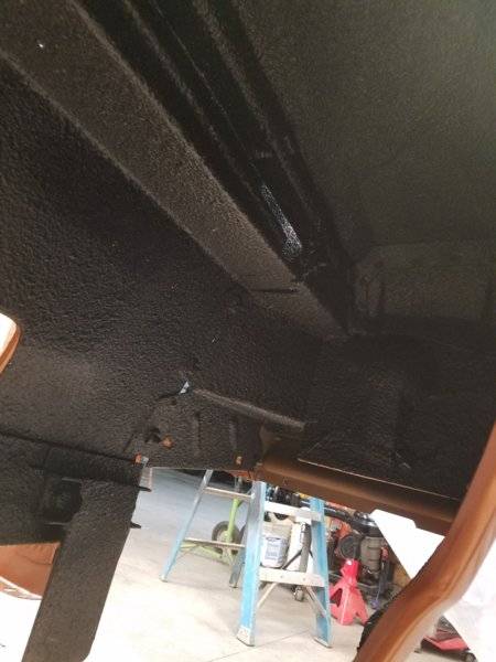

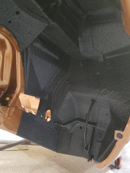

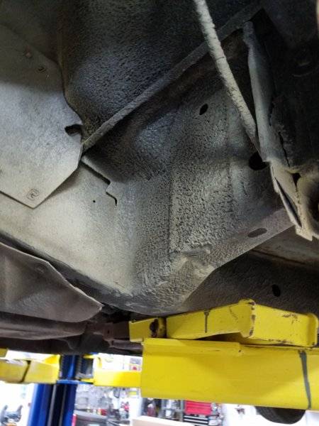

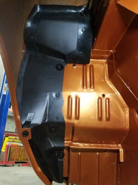

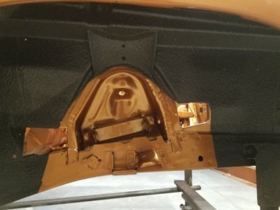

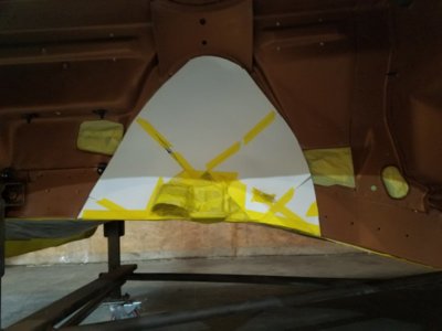

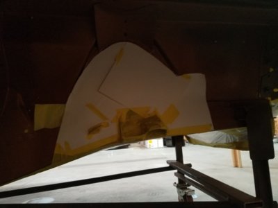

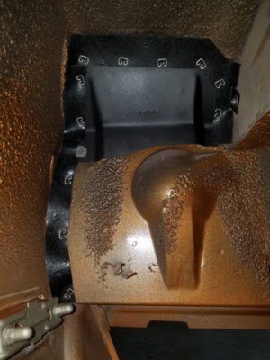

Try clay bar if you see/feel any paint overspray.That is my worst fear. I have to do it all over again to spray the front wheel wells with undercoating. That stuff really makes me nervous as it goes on with a high pressure and likes to get everywhere.

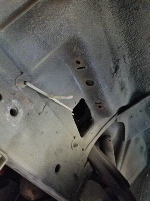

As a matter of fact I did. Made that mistake once. What a bitch that was getting the antenna installed through the door opening.Did yah install your radio antenna before you did that??

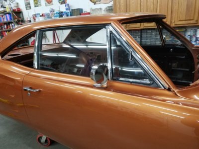

1969 T5 copper PPG 2031.What colour is the paint?

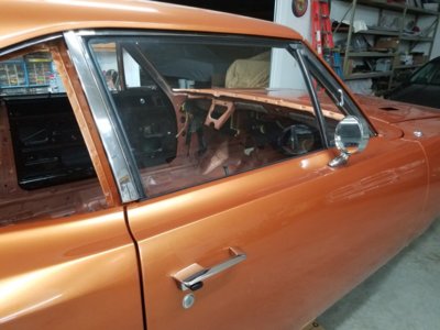

Looks great!

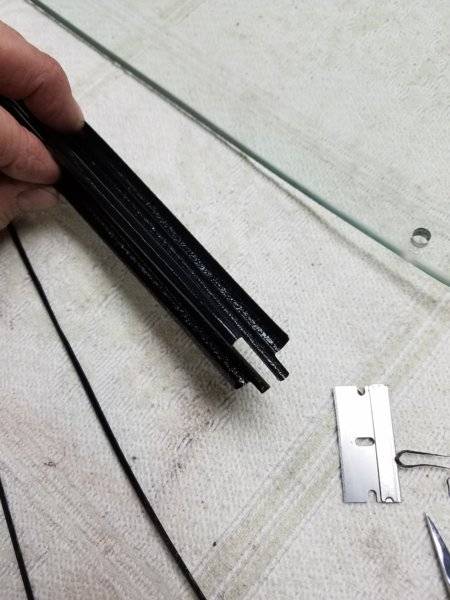

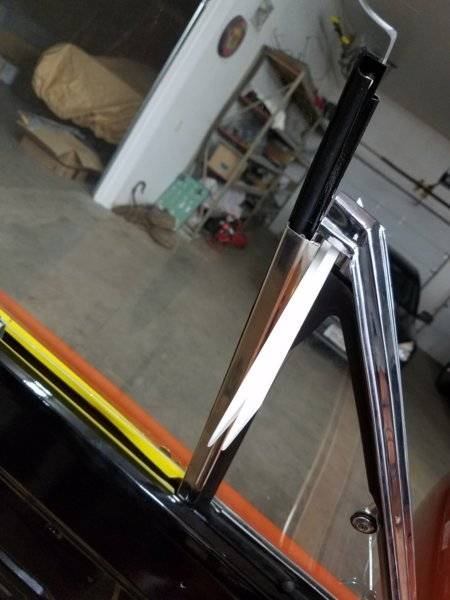

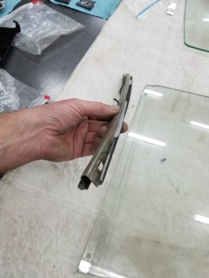

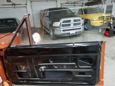

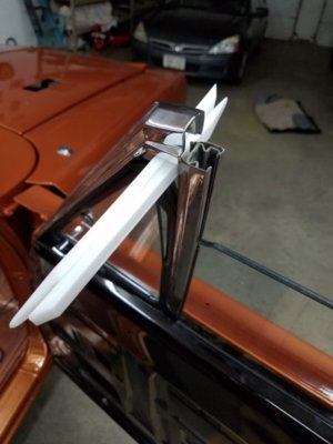

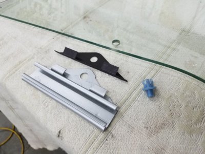

I found it is way easier to install the vent wing into the door first.
