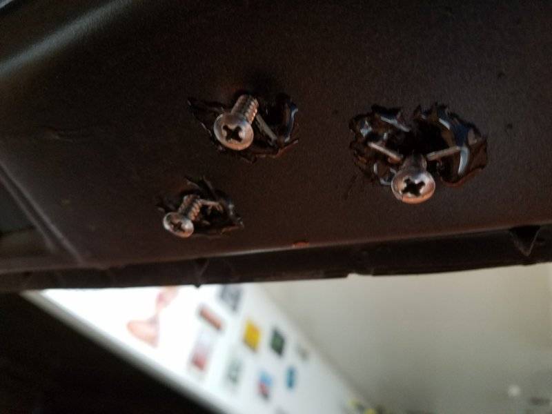

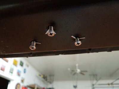

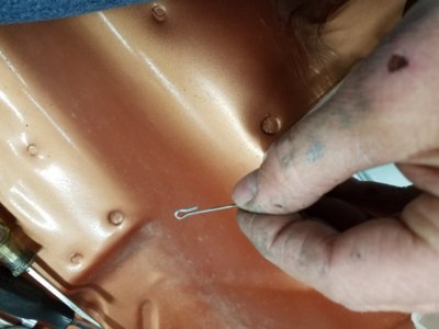

Been getting things ready to attempt the headliner install. Found out the one of the previous owners had stripped out the holes holding the rear view mirror. With the car already painted, and unable to get to the backside of this area, I didn't want to take a chance with the welder and grinder to fix the holes. A big thanks to Doug @dvw for the idea to use small cotter pins. I would never thought of this simple solution. After getting them in the holes, I put a dab of epoxy on the legs just to hold them in place when I remove the screws after the headliner is in place.

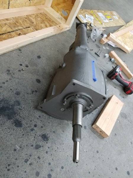

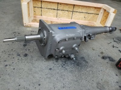

A new to me 18 spline transmission from Jamie Passon showed up last evening.
Did you keep it oem or add a gear?

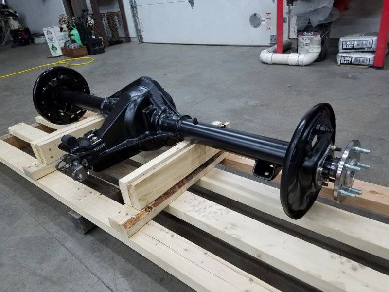

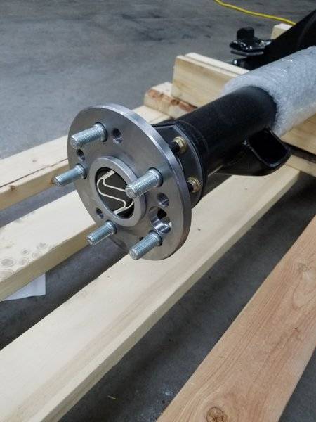

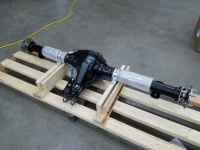

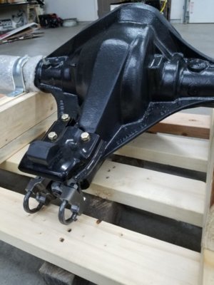

Strange S60 showed up today. Cass had told me 30 days from ordering and it was here in 29. Very nice quality looking piece. Merry Christmas to me .
20191220_113004.jpg 20191220_112948.jpg 20191220_112955.jpg 20191220_112929.jpg 20191220_165653.jpg 20191220_112940.jpg

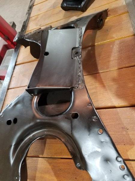

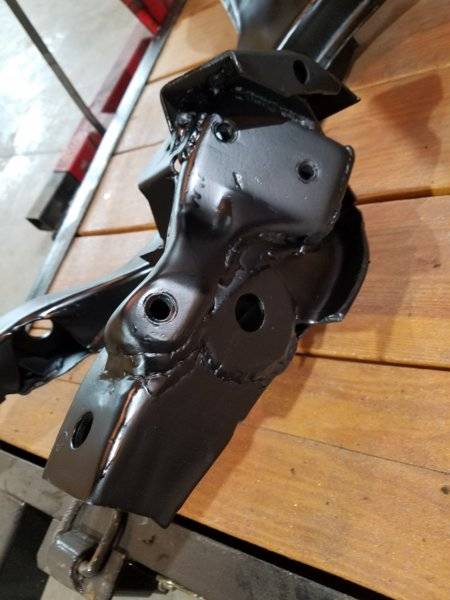

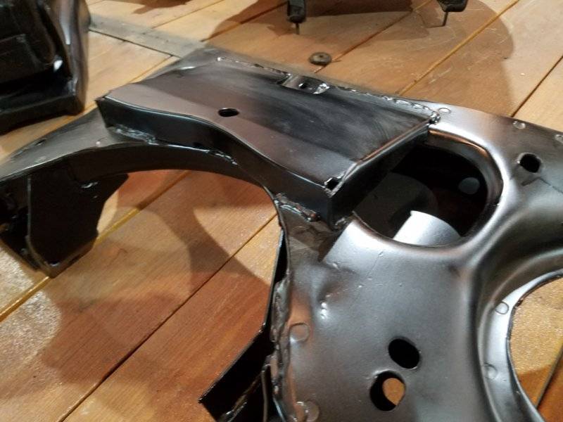

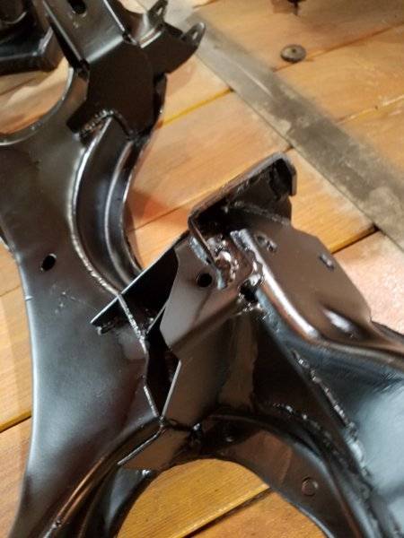

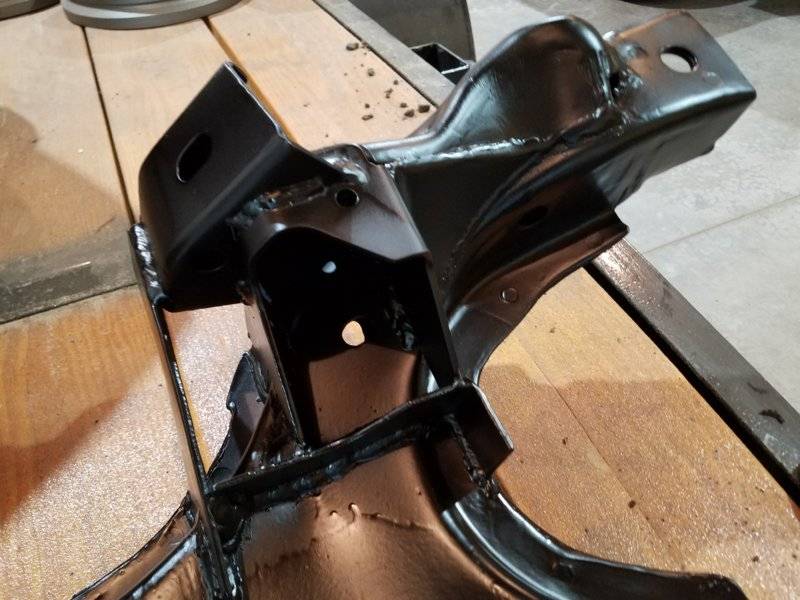

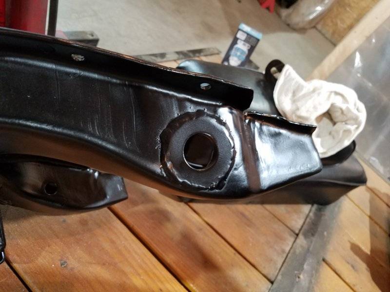

Got the k-frame taken care of. Even though I think Firm Feel charges to much for their stiffening kits, I bought another one from them. I told them to keep their goofy skid plate that comes in the kit because it is a terrible reproduction. They must have heard that before, because they gave me a few bucks off without hesitation.
My friend Al who is a Hemi nut and custom fabricates Hemi k-frames and Hemi engine brackets also make skid plates. He does an awesome job on them. He sells his stuff all over the States. Old school guy who doesn't have the internet or a smart phone. Everything is word of mouth. He was the only place you could buy these until recently, now they are reproduced and sold from several vendors.
View attachment 792015 View attachment 792017 View attachment 792018 View attachment 792019 View attachment 792021 View attachment 792022
What’s his contact? Been wanting to do a gen 2 Hemi but can’t find solid engine mounts for them anywhere.

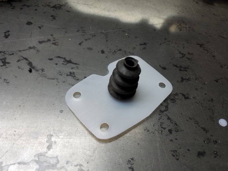

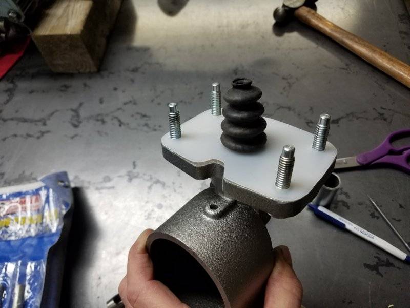

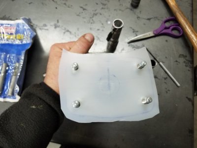

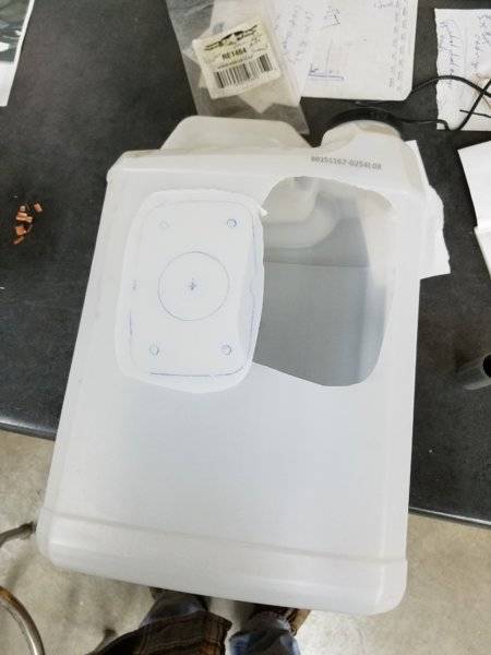

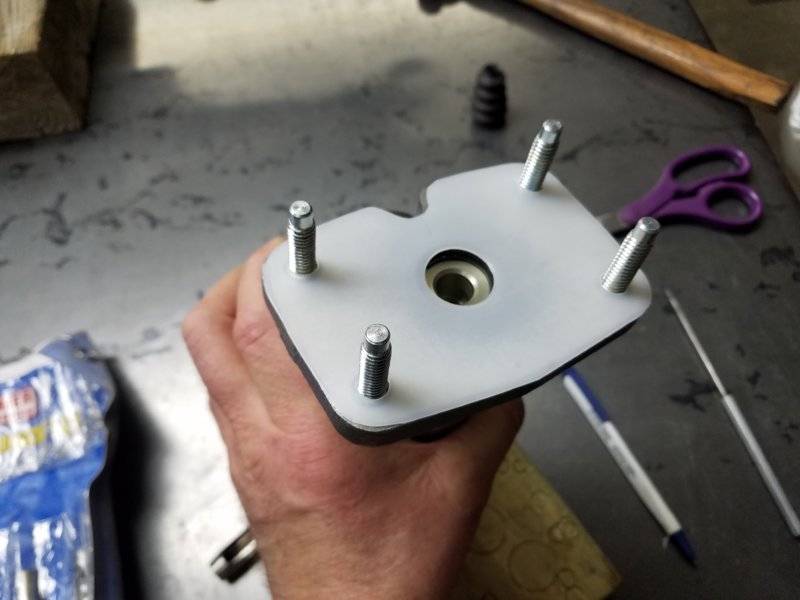

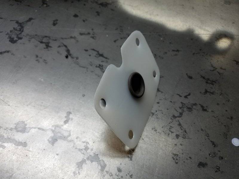

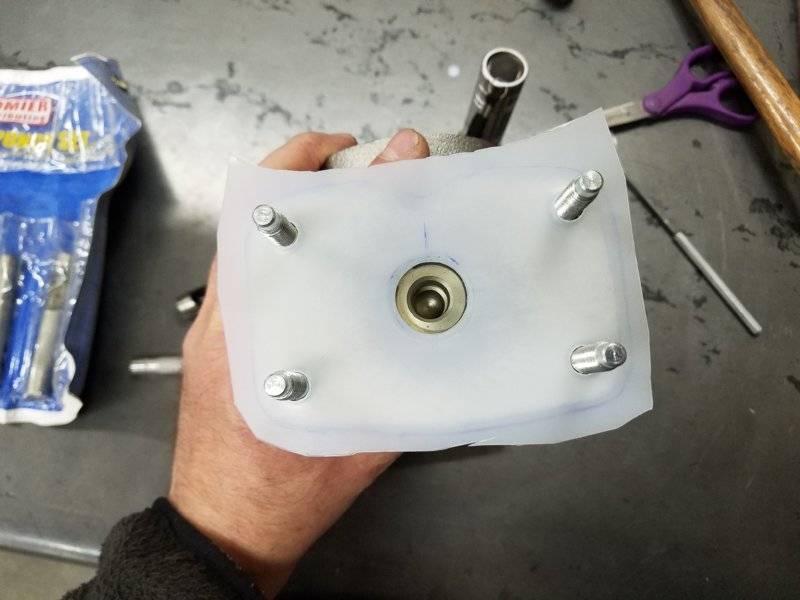

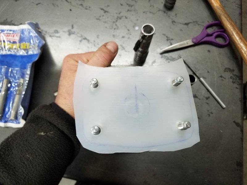

When converting from a drum brake car to manual disc/drum and using a smaller bore master cylinder, a problem always comes up for what to do with a dust boot. They are not produced and I have gotten lucky on past projects to find good originals. None to be found for this car however. So I found a tough plastic clear jug and made my own. Took 2 tries to get it perfect, but I am happy with the finished product.
20191222_063615.jpg 20191222_065659.jpg 20191222_070227.jpg 20191222_065609.jpg 20191222_070309.jpg 20191222_070335.jpg 20191222_070304.jpg
Sometimes you got to be creative and think outside the box! Nice work!
