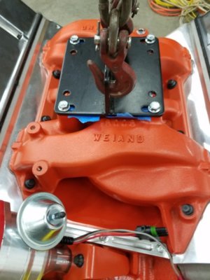

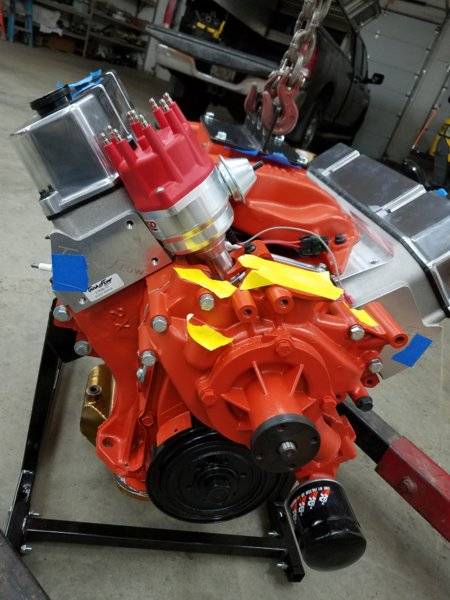

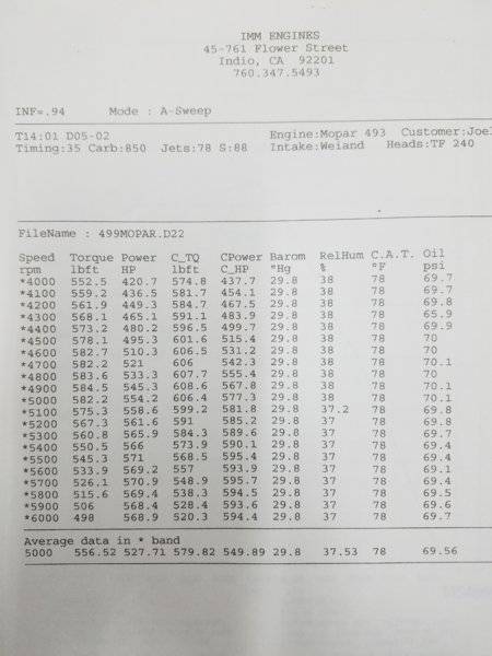

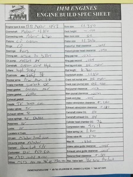

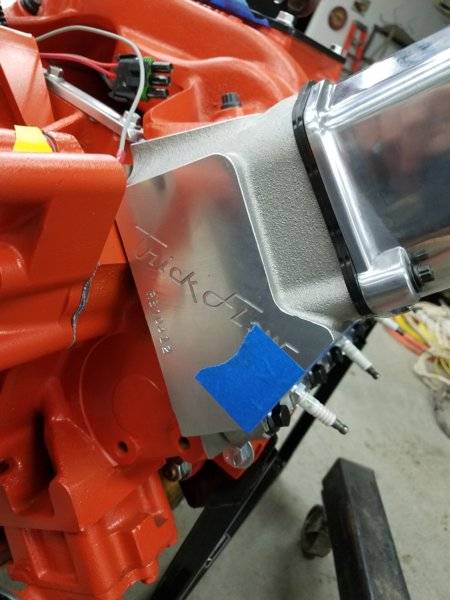

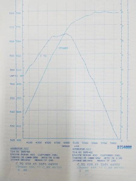

Just got the 499 picked up from FedEx, in the garage, and uncrated. This was the last big ticket item for the car, so kind of a relief in that respect.
20200102_164321.jpg 20200102_164330.jpg 20200102_164313.jpg 20200102_164340.jpg

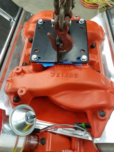

congrats on getting your eng that should be a monster in that bee,i see you went with the weiand intake did you modify the intake any for performance. if that is the low profile it will fit under ramcharger set up. thanks
Yes, I went with the Weiand because of the Ramcharger ductwork. It was between that and the standard Edelbrock. Brian thought this one would make a bit more power over the Eddy. He did port match it, but I think that is about it. I wanted to use a brand new Holley Street Dominator that I have, but the height would have been an issue. But honestly, the power the motor is making is more than I was originally looking for anyway, so I am happy.

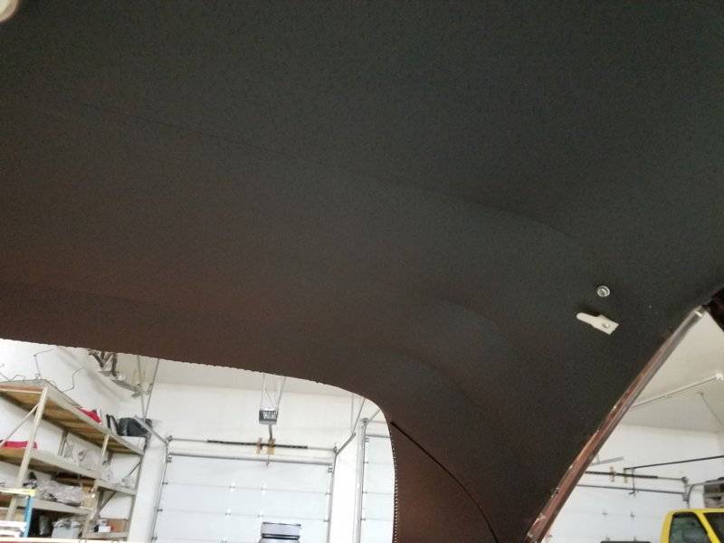

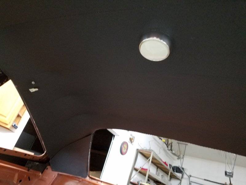

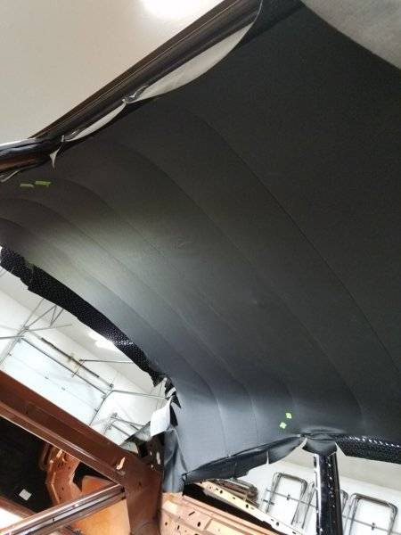

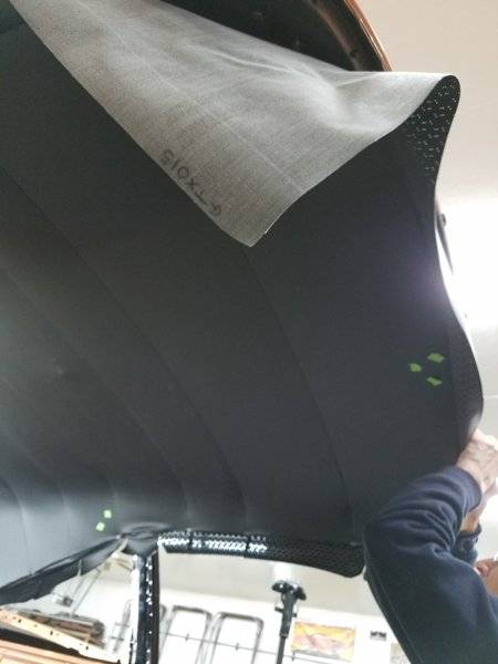

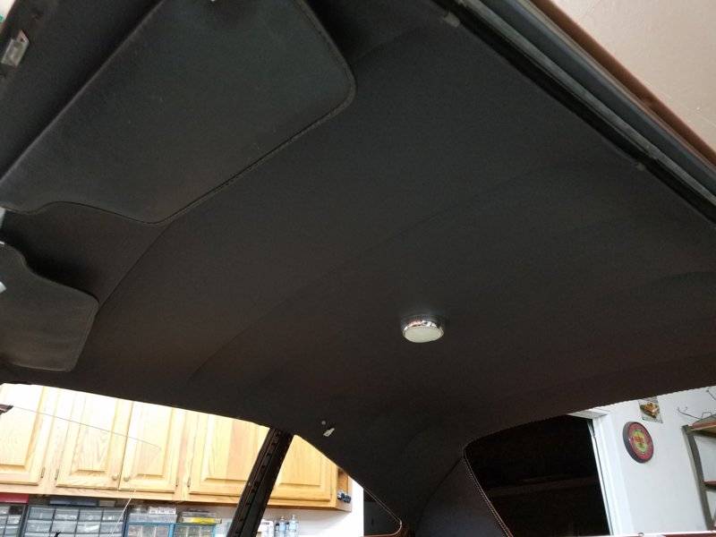

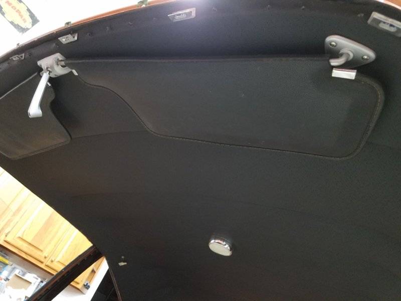

A neighbor lady who I just recently found out loves old cars and does seat upholstery on the side stopped over yesterday to install my headliner. She spent 4 hours and is very meticulous. Turned out great. And on top of it, she only wanted $50. Gave her $100, and that still probably wasn't enough. Wish I would have known about her years ago.....
20200105_064707.jpg 20200105_064711.jpg 20200104_120914.jpg 20200104_120917.jpg 20200105_064655.jpg 20200105_064659.jpg
View attachment 890668 View attachment 890669 View attachment 890670 View attachment 890671 View attachment 890672 View attachment 890673
That looks nice and tight, as it should. So many cars with bow type headliners are not done right and have sags and wrinkles. Congratulations on finding her. You may have under-payed her but I am sure she would appreciate a hand written Thank You card from you more than a few dollars more.
She is restoring my seats also, so I will be sure to make it right with her when all is done. Cool woman. I am guessing she is right around 60. When she was in high school, she volunteered to try recovering the seats in her boyfriends car. Apparently it turned out nice as the 2 of them ended up getting married and have been together ever since. She has been doing seat upholstery and headliners on the side ever since. Some real nice custom stuff as well. They have around 15 cars and trucks from the 50's and 60's.

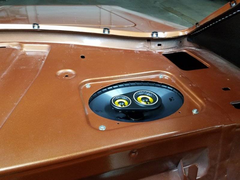

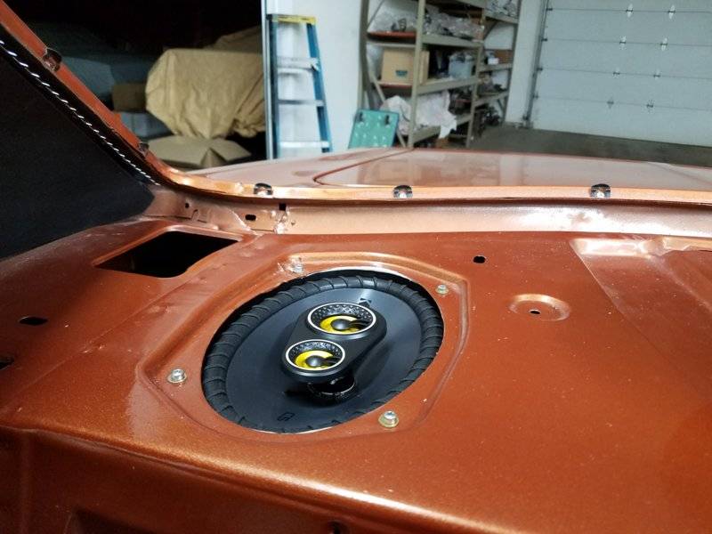

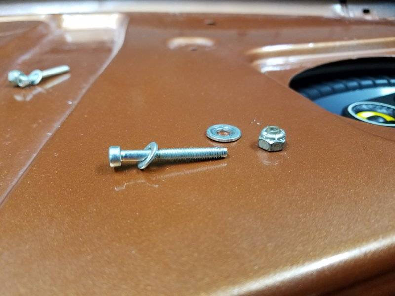

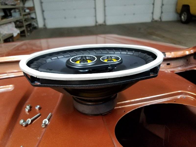

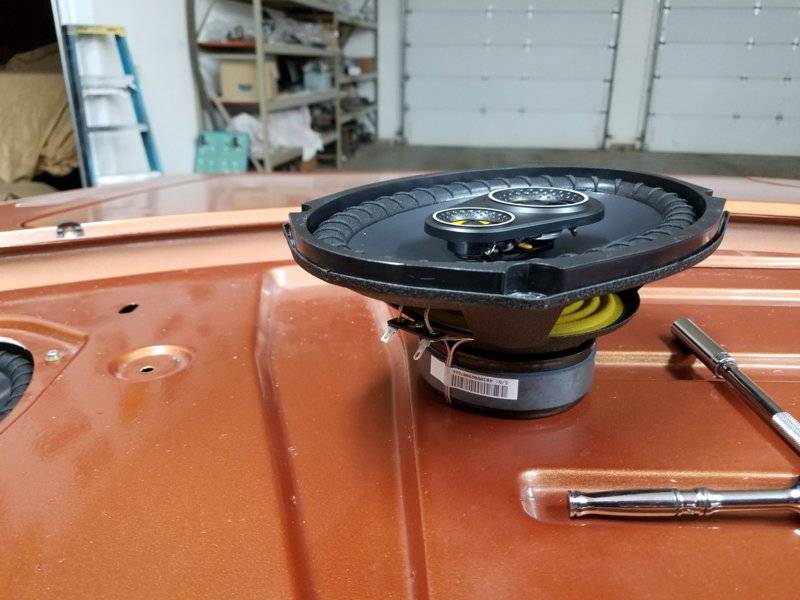

Small things getting done, but really starting to look like a car again. Bottom mounted a pair of 6x9 Kickers under the package tray. Seems odd that the one hole was made for a rear defroster motor housing but the 4 mounting holes are exactly where they needed to be for a speaker.

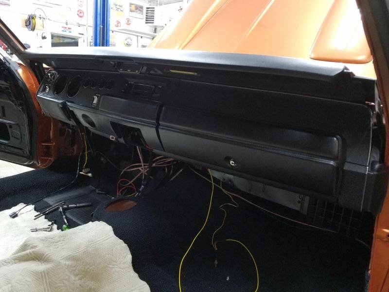

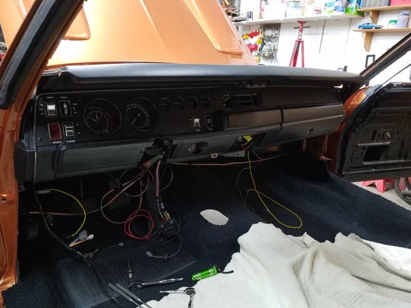

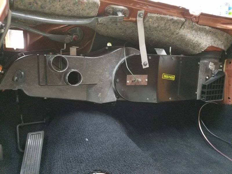

Dash and heater box in place and have the front and rear glass install set up for Tuesday. Also got the carpet set in place. It came from Mega and I believe is ACC. I will say that it is probably the best fitting one I have had around the 4-speed hump. I keyed everything off of that because that is what is seen. Only issue was that the gas pedal ended up to far to the rear. I cut out the rubber and mounted it there anyway because everything else fit so nice. I will get some floor mats to cover that up later.
View attachment 893939 View attachment 893940 View attachment 893951
what radio are you using? rock and roll,that bee is coming full steam.
good choice they are expensive but a good radio and has the factory look.
I bought a restored factory AM radio for my Coronet and a new center dash speaker. It sounds OK unless you start the car then you can barely hear the thing. Looks good in the dash, though. I installed a modern Kenwood in the glove box. Only thing about that is the remote is IR and only works when the glove box door is open; wish I could find a RF remote for it.

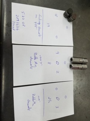

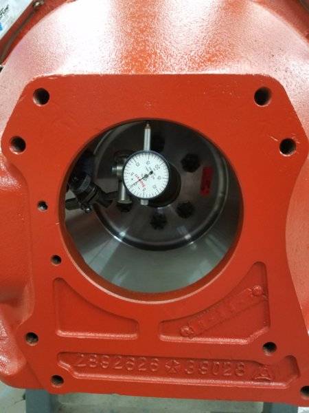

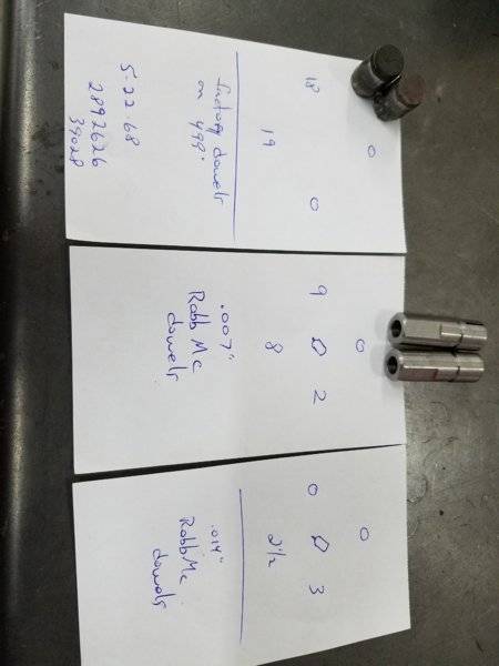

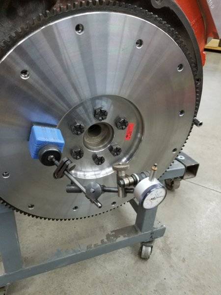

First time that I have messed around with bellhousing alignment. Pleased with the final outcome although it took me 2 tries to get there. My scratching shows where I started. Bought a pair of RobbMc .007's thinking that those would move everything that far up and right to bring me within about .004. Those got me 1/2 way there, so I had to order a set of .014's. These are some nice quality pieces and I would definitely recommend them to anybody going through the same thing as I just did.

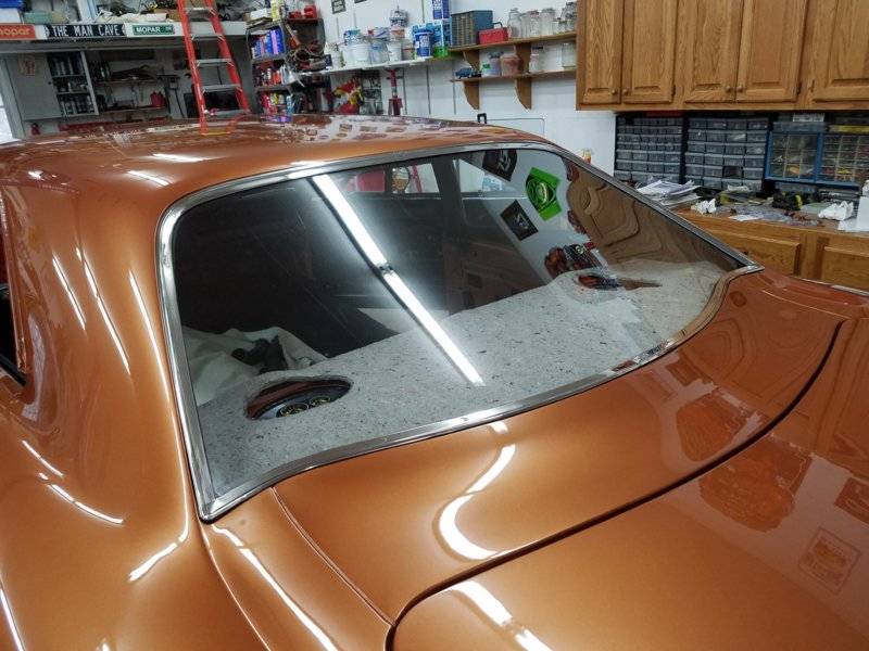

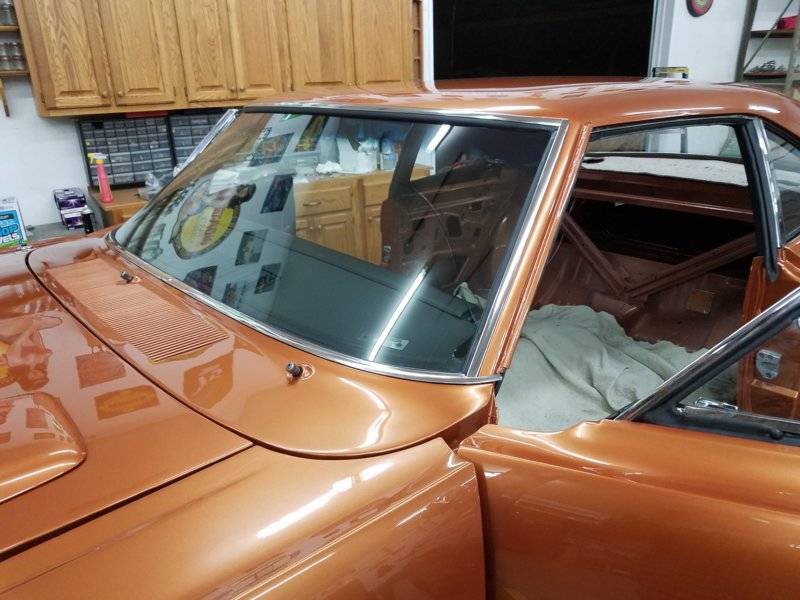

I hope your window instillation went well.

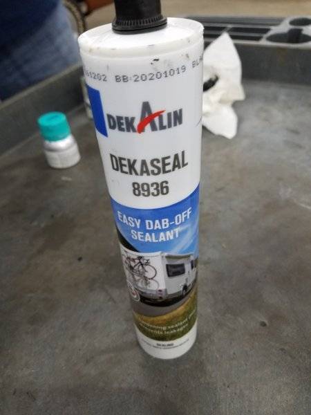

Window installation did go well. A member here recommended a couple guys from a shop in the neighboring town that does all the window installs for Muscle Car Restoration. First time that I have used them and am happy with their work. This is the product they use on the front glass.

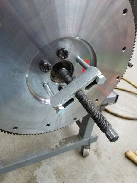

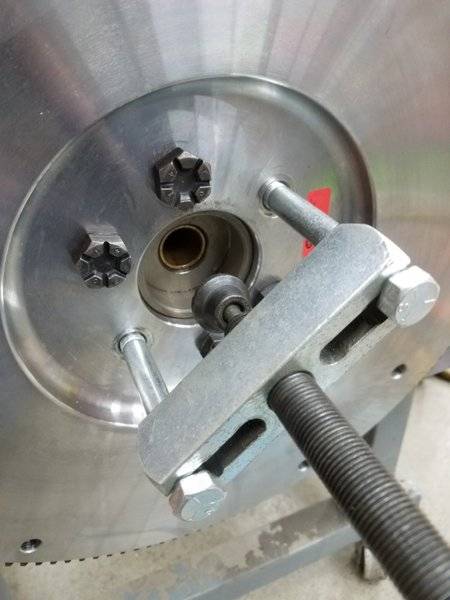

Work has been getting in the way of playing around on the Bee lately, so things are moving slowly. I did come up with a good idea imo for installing the pilot bushing though. Modified my steering wheel puller to accept 7/16" bolts. Put the bushing in the freezer for a few hours, and pressed it in. It is usually a challenge to gently pound them in with a soft hammer. I actually ruined the first one which prompted me to find another solution.
