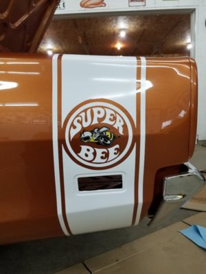

Anybody want a slightly used 69 Bee stripe from Phoenix Graphics? It's off and I am ordering a new one from Performance Car Graphics. Lesson learned. I have way to much time and money into this car to have the focal point be out of wack. It would have always bothered me anyway. My wife says I'm a bit to ****, and she is probably correct.
Good choice. You are correct, this is the focal point of the car, it needs to be spot on. Not **** at all through my eyes. If you are going to do something, do it right.

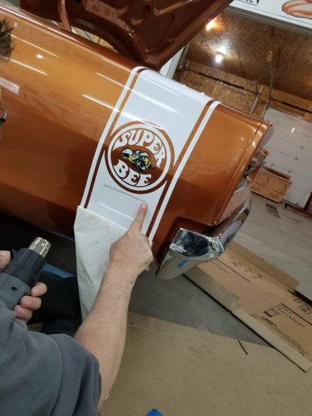

He makes it look really easy, but of course that is all he does day in and day out. Not only can the reflector recesses be done right away without having to let the solution dry, he is also able to manipulate the stripes a bit if need be. Haven't had to do that on a rump stripe, but he did on the horizontal stripes on my Duster. He says it is a lot harder to get bubbles out of wet applications. I don't argue with him, just tell him how it should be and then stand back to let him have at it. He does get me a bit nervous when the propane torch comes out however, lol. I don't have enough internet power to make a video here, but will try to remember to take some pics as we lay out the new one.

One reason is time of course. Like on these rump stripes, he would have to come back the next day after the solution dries to do the reflector areas and where they wrap around the decklid area. But I think the biggest reason is that he can bend and stretch the stripes if they are not conforming to the body lines perfectly. He will have part of it stuck down and then with heat he can bend the vinyl. He had to do this on my Duster for one of the rear quarters. Glad he did because it would have been off enough to bother me.

Yes, but if they are not made straight with the world that is more than "product only". I don't think there is any reason a guy should have to cut apart a decal like this to be able to rotate the Bee and 'Super Bee" to make it look correct. I also think they have the area with the circle layed out to low in the stripe and that is why it gets down into the reflector cutout. They are supposed to be Mopar authentic restoration approved. We can see from the pics of these compared to what PCG makes that there clearly is a difference. I am upset because not only am I out the $169. I paid for the stripe, buy also the money I paid to have it installed. We did the drivers side first and noticed the issues after the protective coating was removed. I was going to try to live with it until we did the passenger side. That one was just terrible. I'll post up what happens Monday after I call them. One thing I do know for certain is that if something like this happened with a product bought from Summit or Dr. Diff, I would have nothing to worry about. It would be resolved immediately.

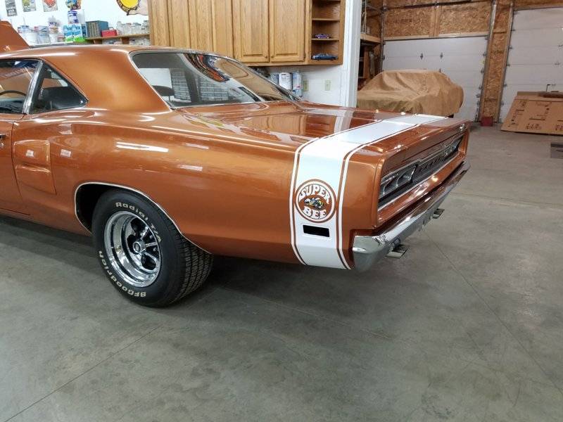

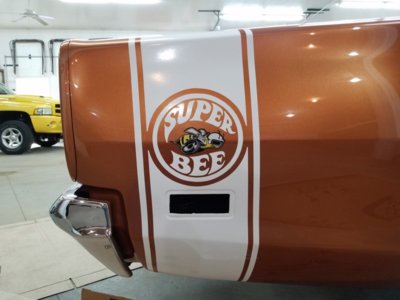

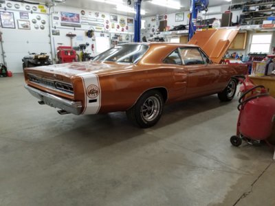

Performance Car Graphics to the rescue. Ordered on Monday and installed on Friday. And the logos are even straight. How's that for service?

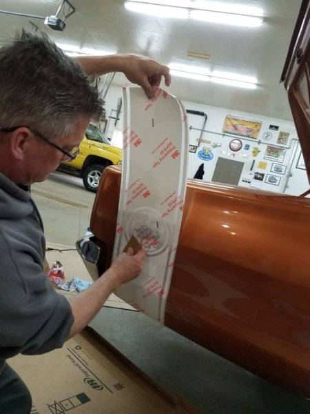

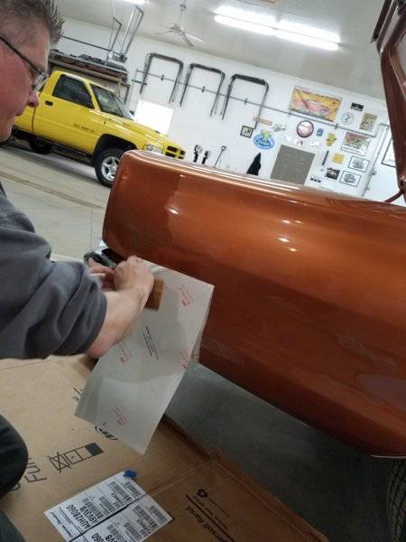

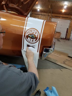

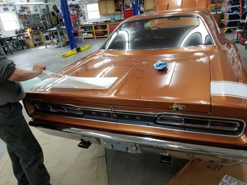

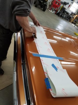

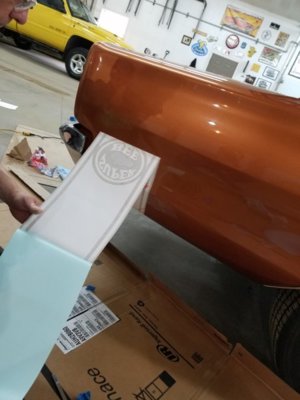

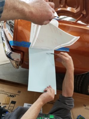

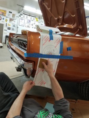

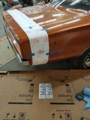

Decals went on dry again. What he does is get it layed out exactly how it will go down and secures with tape. Picks up 1/2 of the stripe and removes the backing. Lays that down and repeats for the other 1/2. Took us about an hour.

It looks very nice!
