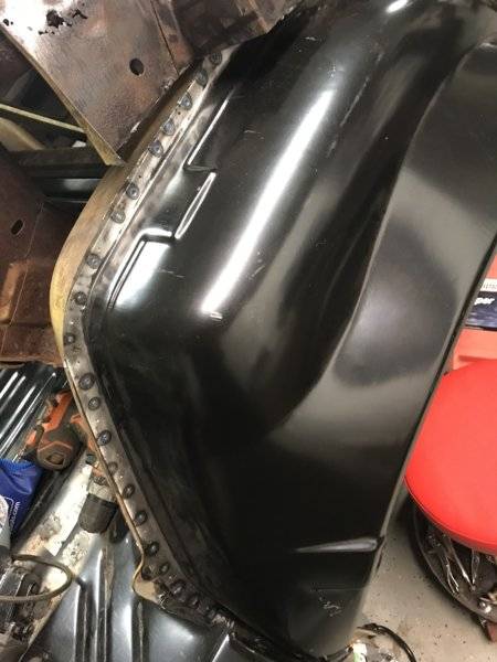

All lined up and ready to Cleico

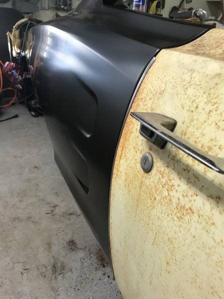

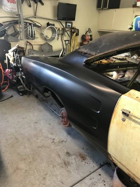

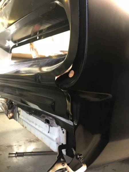

Test fit is good for the wheel tub and door. Tail panel needs some work along with a lot of small rust repairs in the rocker and roof support. HOLY SH*# is that quarter a pain to get on right at the lower edge of the rear window!!!!

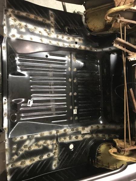

Looks amazing! That should be good to weld the pan, wheel housings and extensions. Before you weld the quarters, get the trunk lid bolted up. Welding new metal into place was my favorite part.
Thank you Threewood. I really appreciate your feedback. My thought was to weld the wheel housing but I wasn’t sure about the trunk pan and extension. I ordered a spot welder so once that arrives I’ll get started!!!! Do you know for spot welding do I have to clean up both sides of the metal surface on each piece to weld?

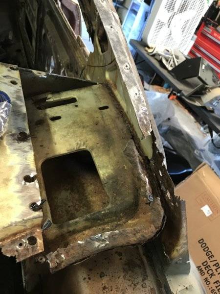

In terms of getting both quarter panels on so that I can fit the tail panel and the Dutchman panel, is it OK to have both quarter panels removed at the same time? I will have the trunk floor and passenger wheel tubs welded. I’ve gotten and read mixed reviews on removing both quarter panels at the same time. Currently no additional bracing in the car.
Personally, I would keep as much original metal as you can and build off of known placement. The AMD Dutchman is known to have issues with fit. You will also want to test fit the rear glass and trim before welding it in.
Thanks again threewood. Unfortunately pretty much all of my rear end is totally gone. Not much to go off of. I was able to line up the new tail light panel with the old drivers quarter Which actually fit right on top of the old one.

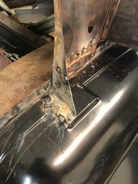

Spent the afternoon taking apart the rear end, cleaning up all the metal to be welded and reassembled. Lesson learned, clean up all of the edges to be welded prior to fitting anything together. My spot welder showed up today also.
