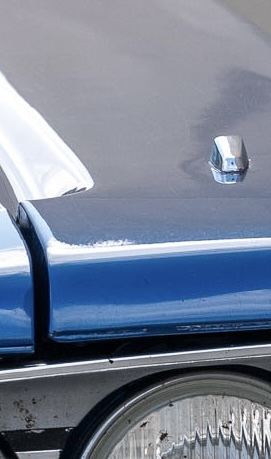

These are on my 69 Coronet RT built in Los Angeles

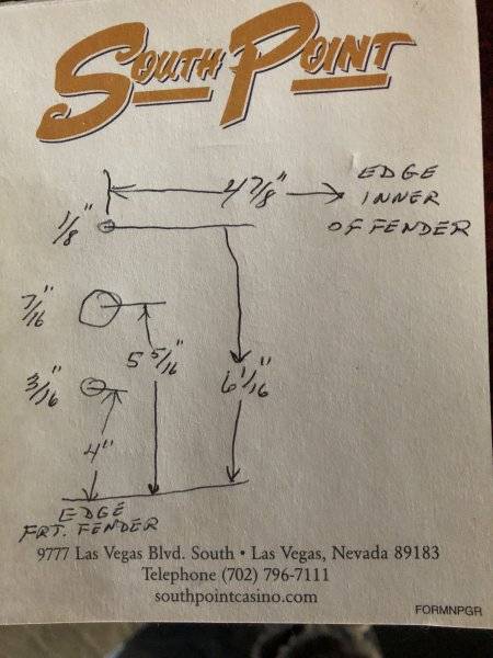

dspur & others. Measurements for 3-hole fender indicator. Ran a straight-edge on fender by headlights for center of each hole. All 3 holes are 4/78” from inner edge of fender
