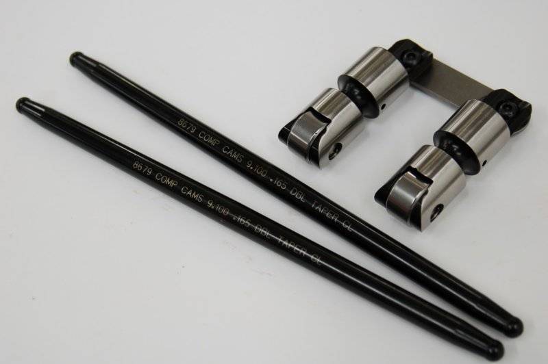

I used 7/16 pushrods with the Trick Flow heads on my dry sump 470. I had to clearance the pushrod holes. It didn't require a lot of work but you need to have the correct setup. A rollover fixture in a milling machine works the best and then you need a long mill to reach down in there.
Good thing is that my dad has a milling machine with a rollover table. Did you clearance the pushrod hole all around or just on one side?
