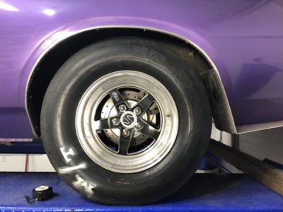

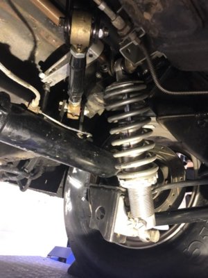

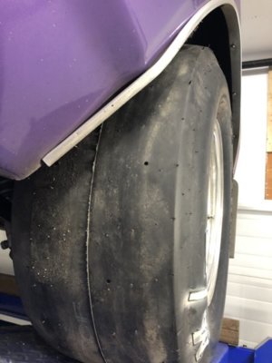

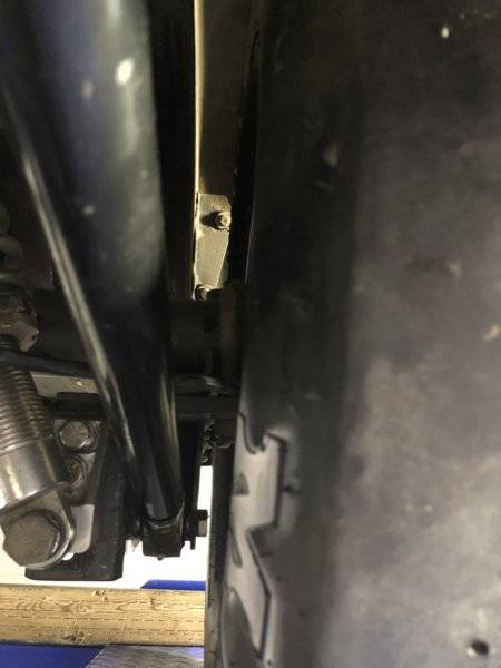

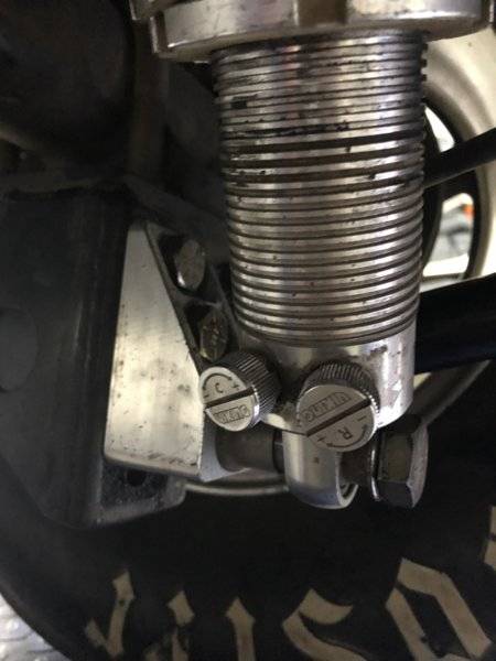

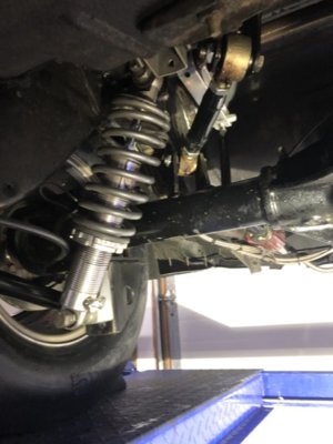

Well after spending some time under my car measuring and brainstorming, the light bulb cam on! This is an RMS Alterkation street Lynx setup. Key word "street!" When we put this system in the car a few years ago, in order to get the 30" slicks to fit without rubbing, I had to flip the lower shock bracket upside down to get everything to fit! Ding, ding, ding, what happens when you lift everything? all the bar angles change. This setup is designed for a lower profile tire, Pro touring stance. So about a 28" tire is the max diameter you can have with a proper ride height on this suspension. I have a set of 28x10.5 stiff wall M/T's coming. I flipped the lower shock mount and lowered the suspension. I will fine tune the height once I have the 28's mounted and on the car. Right now just flipping the lower bracket I went from an 11 degree up at the front angle on the top bar to a 2 degree. I may be able to get it 0 once I have the tires on it. I can probably add 1-1.5" on the forward bracket and even get that top bar angle down in the front now. Bottom bar went from 14 to 9 up at the front. I would have to add a piece under the axle now to get anymore angle as I am up in the spring perch as high as I can go currently. The only other thing I may have to do is shorten the anti-rollbar links to get the correct angle on the pivot arm. That is a minor detail.

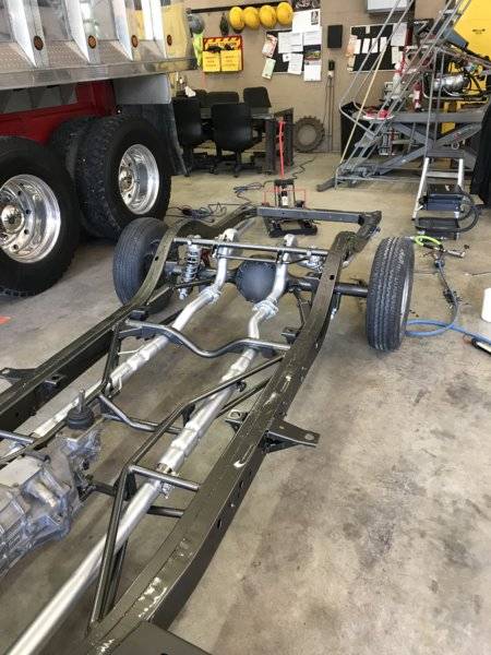

Hopefully this will help the squat? If not then this winter Malex may have to come visit and install a sweet ladder bar setup in my car like he has!

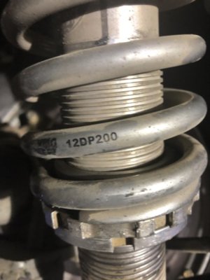

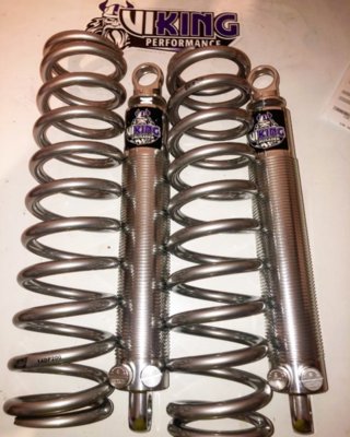

One other thing that would probably help is a better rear shock and I am not sure if a 200 is enough spring rate for my car? My tank may benefit from a 250 or 300 at my size? Thoughts?
One other question, on an anti roll bar, is it best to preload the P/S? I notice with the squat the car has, the arms are hitting the body. So hopefully better bar angle stops that?
