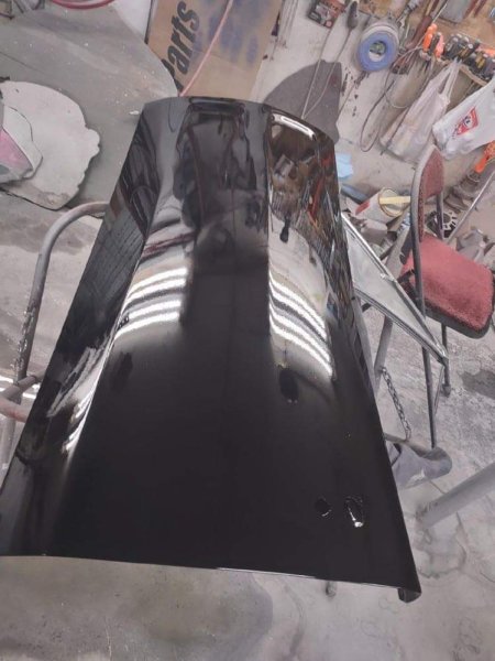

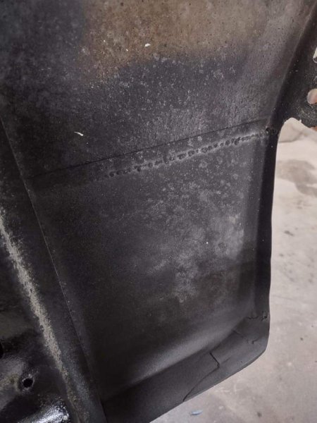

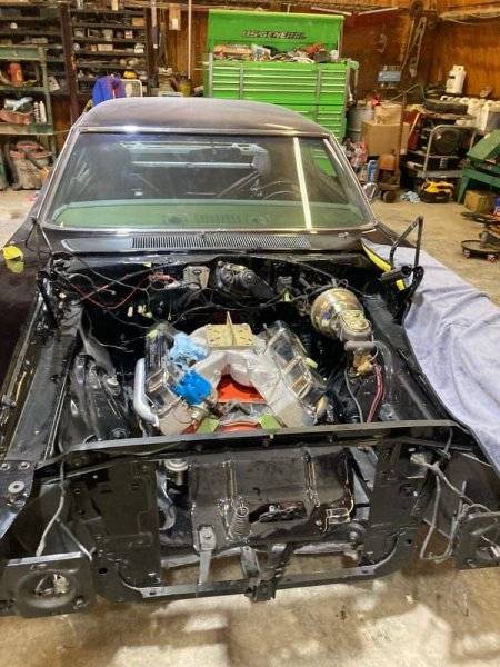

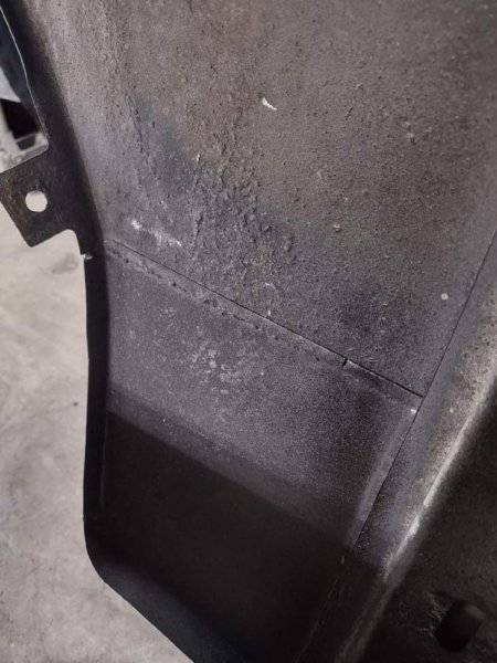

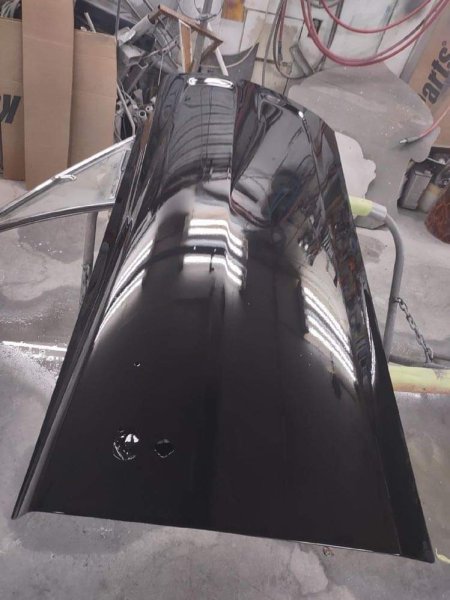

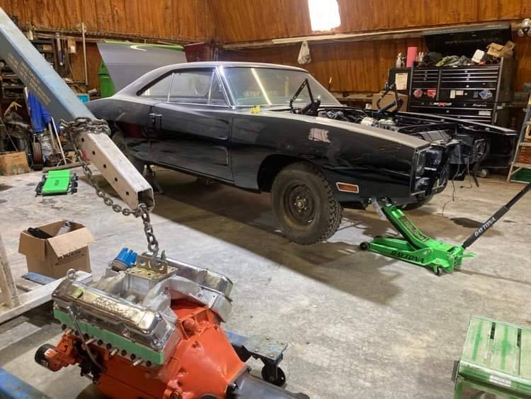

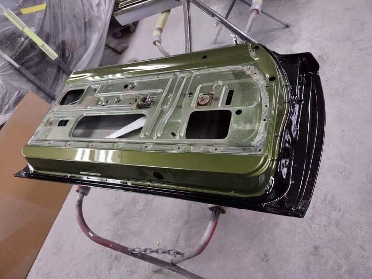

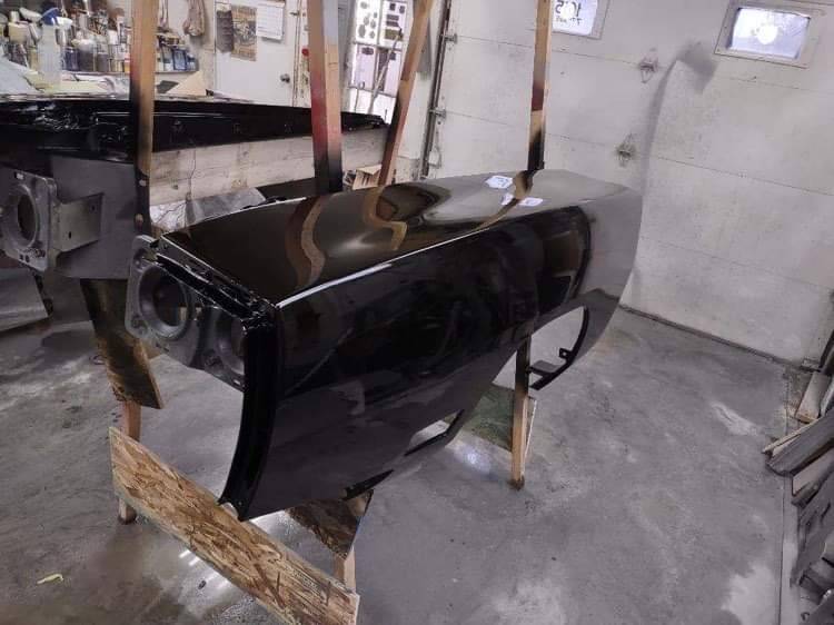

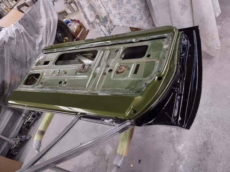

Thank you for the specific info. This helps very much. Attached are a few additional shots during resto. I got these after originally posting.
I’ll get the VIN but wondering if the shot tells originally a base or 500? Assuming base because that info hasn’t come up at all. He’d want to ref as an oem 500 if that was the case?
Oem green interior is what you were referencing vs changing to black? Interior stuff is not cheap right?

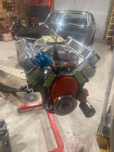

He did tell me he had the 499 stroker sitting around before he bought this about 3 years ago. I don’t yet know any details where he obtained, who rebuilt it, how long ago etc.
Pics appear to show he painted himself? Makeshift garage booth? So glaring flag there right? Greater risk of potential issues down the road - prep quality, what issues might be underneath?

EDIT: I'm seeing a fair amount of orange peel in that paint, but to be fair, this forum downsizes high-res images to fit the site formatting, so without seeing the original pics (assuming they're much higher resolution), it's hard to judge the quality of the paint. In person is the only true way.

Looks like he lap jointed the lower fender doglegs? Guaranteed he cut more corners than that. And keeping the green interior on an exterior color change to black, that is just dumb. Can you tell that I would be walking away from that one?
Yeah, pretty clear! lol. There are two pics in there I wasn’t sure what they were. Is that what you’re referring to lower fender doglegs?
The reason he will settle for $55k is BECAUSE he didnt change out the column, the green interior, chrome the bumpers, or put the RT door scoops on it. If he had done that he'd be asking $75k.
It does look like the fender patches are overlapped, which, if this car sees much moisture will eventually mean rust. The water splashes in there from the tire and seeps in between the overlap and then sits there. This would lead me to look very closely at how the quarters and other panel repairs were done.
