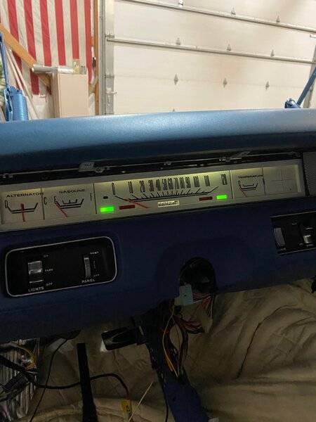

Back to the electrical gremlin. I ruled out the new dash harness possibly being wired wrong. I confirmed each wire coming out of the bulkhead connectors to both the headlight and dimmer switches as well as the steering column connectors to the manual. I found no issues there.
I also disconnected the two steering column plugs and then turned on headlight switch and still have the issue with the turn signal lights coming on in the instrument cluster. That should rule out the original turn signal switch I reused as being bad, right??
Somehow those lights are getting power when they shouldn’t be. Now what????
The only issue I have now is when I turn on parking or headlights, the turn signal lights on the dash come on.
Double check the grounds - I would disconnect the turn signal switch while the lights are on and see if the dash indicators go out. If they do then there is something backfeeding through the turn signal switch. If the lights stay on then there is power being back-fed through the lights themselves (which points to a grounding issue)
Electrical is NOT fun
That’s what it was. I found it by unplugging the front valance marker lights and the lights on the instrument panel went out. I took out marker light housings and touched up points that are intended to pinch through paint into valance and that solved the problem.
