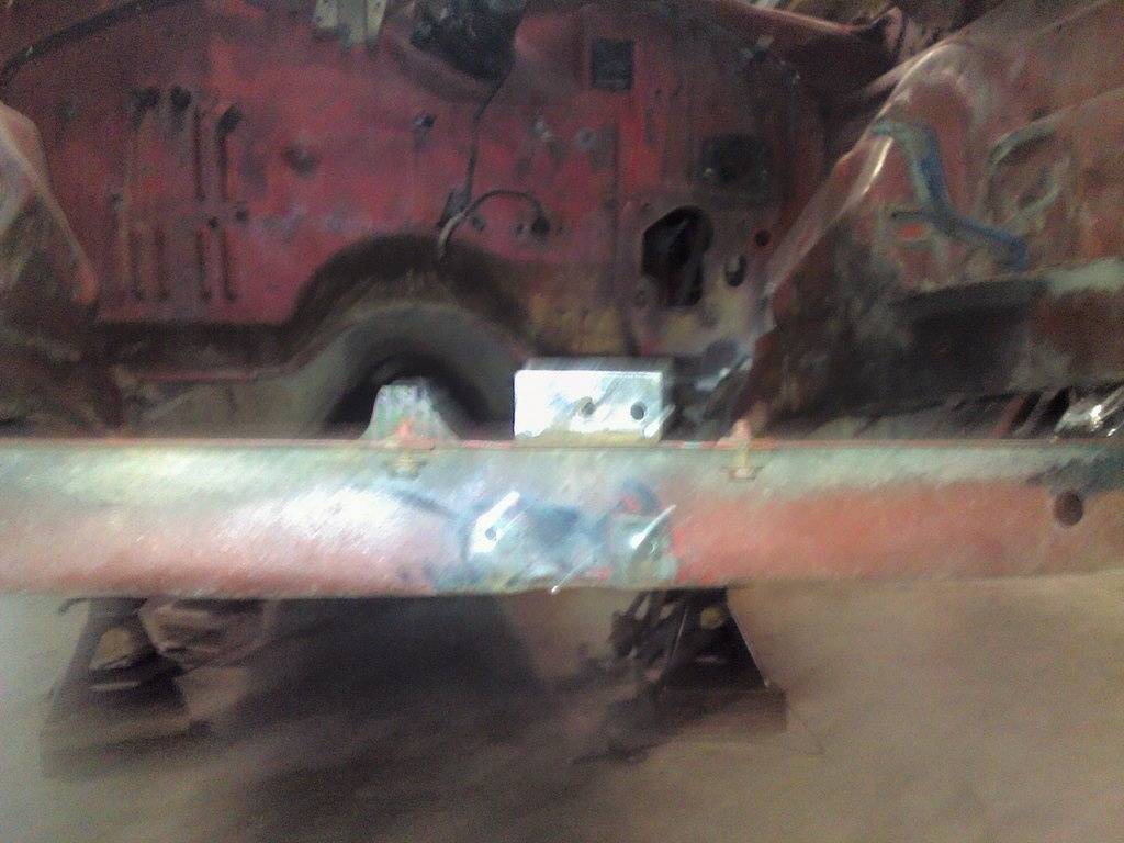

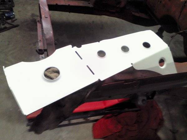

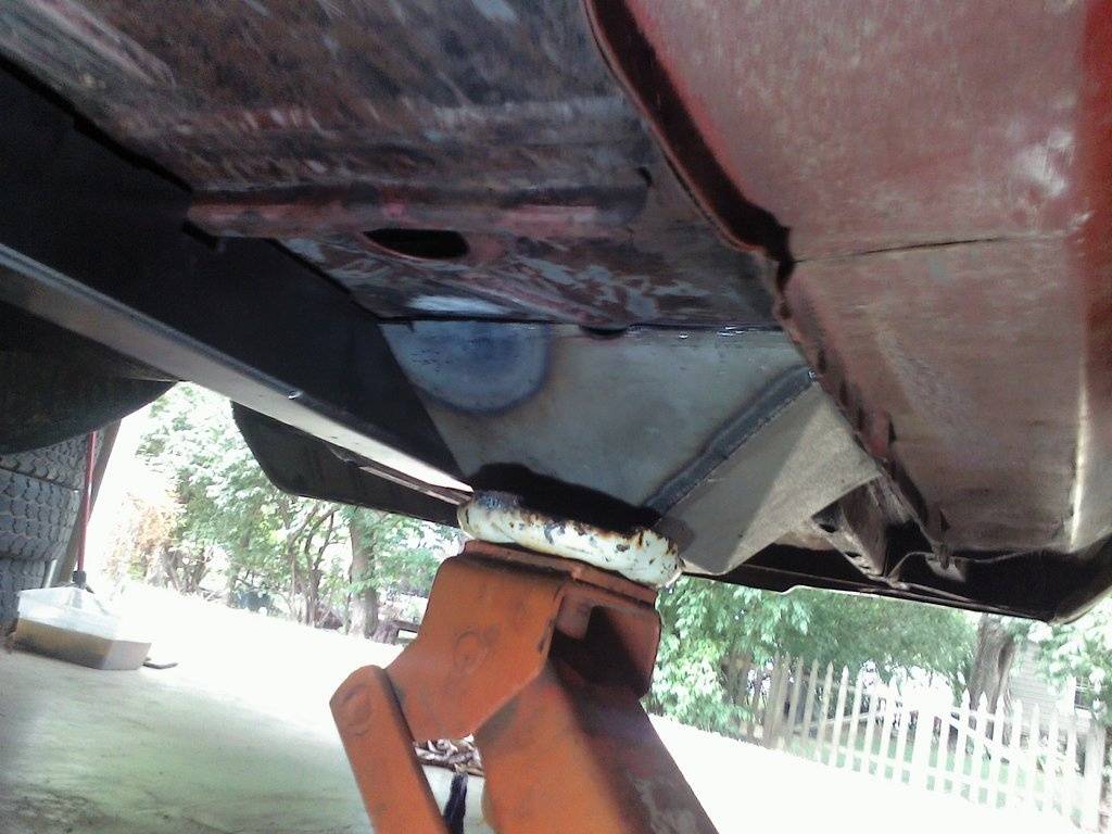

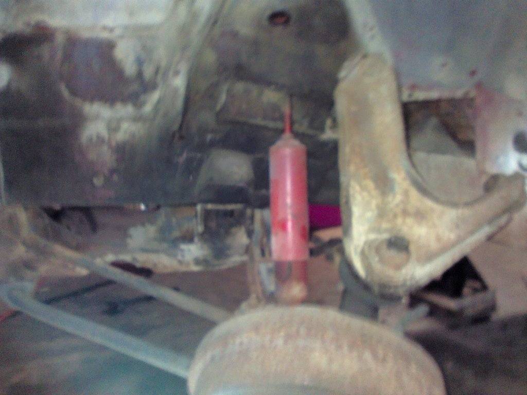

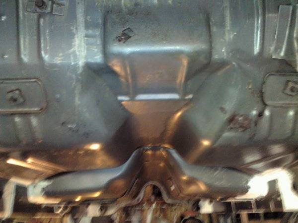

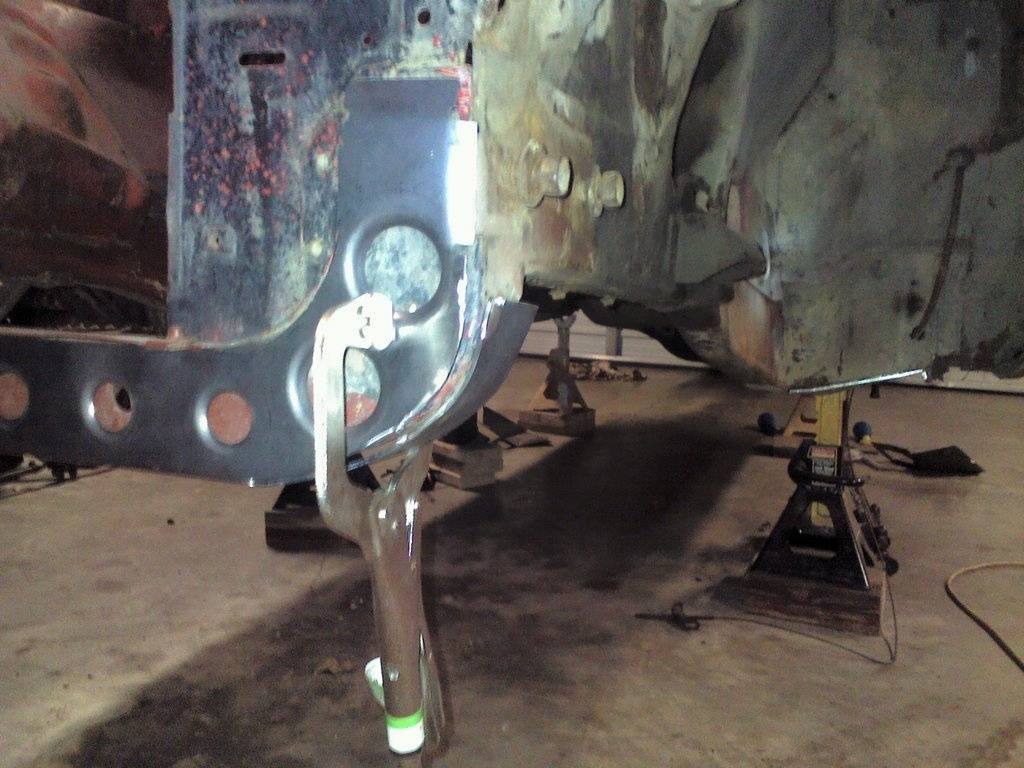

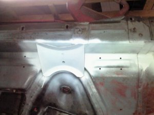

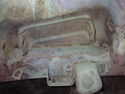

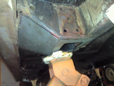

Trial fitting torque boxes & sub frame connectors...

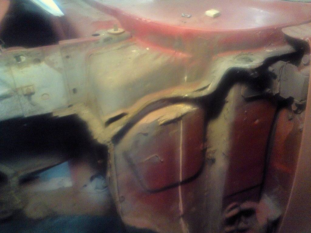

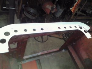

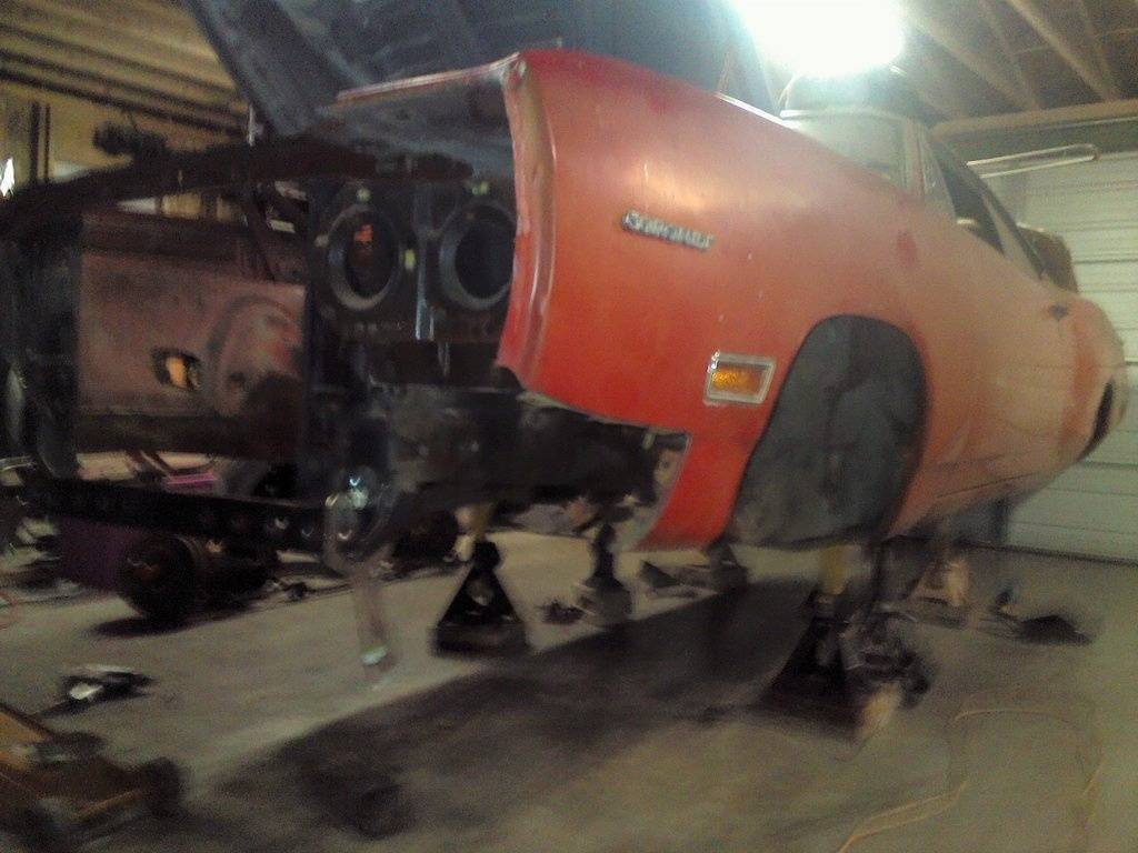

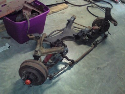

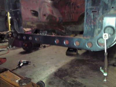

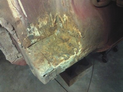

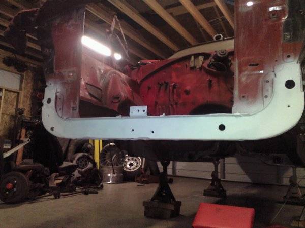

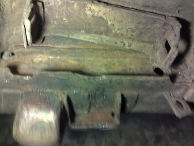

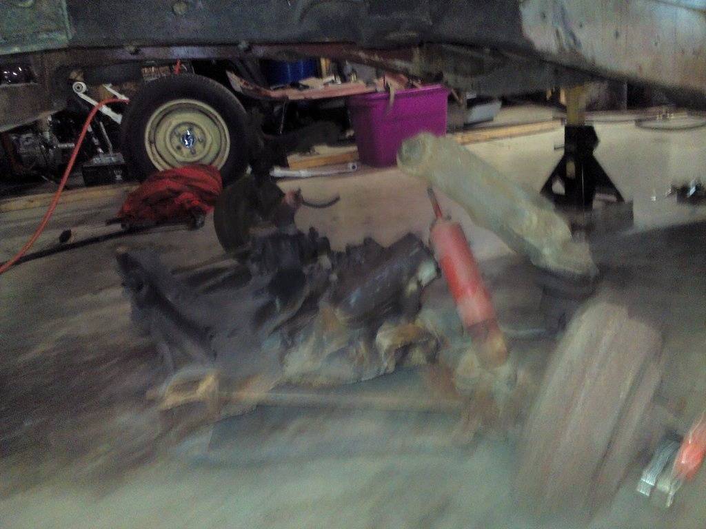

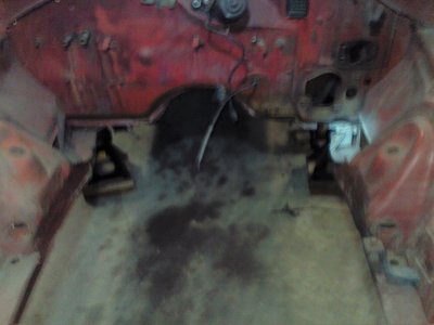

Rad support brace,Z bar frame bracket,and K member removal...Rad support brace tac welds had to be cut in order to get it to fit...too narrow otherwise.....fenders come off tomorrow & scrape off undercoating so braces can be welded onto inner fender well.....bit by bit

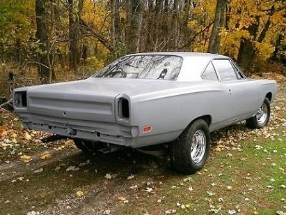

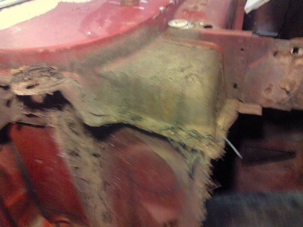

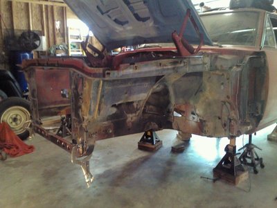

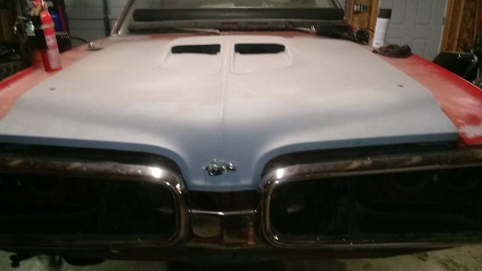

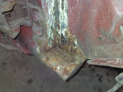

Was a lil worried about what I might find when I pulled the fenders off ....Nice surpris to see the only rust was surface and a FEW scaly spots....WHEW !...Gotta LUV S.W cars their sheet :confederateflag:metal is SOLID !
0828171426.jpg 0828171430.jpg 0828171528.jpg 0828171609.jpg 0828171625.jpg 0828171626.jpg 0828171616.jpg 0828171610.jpg
95% of undercoating removed ! ...took long enuff....sub-frame connectors screwed in place ,inside primed...

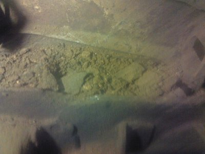

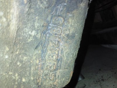

Sand n dirt from inside the front subframe rails....

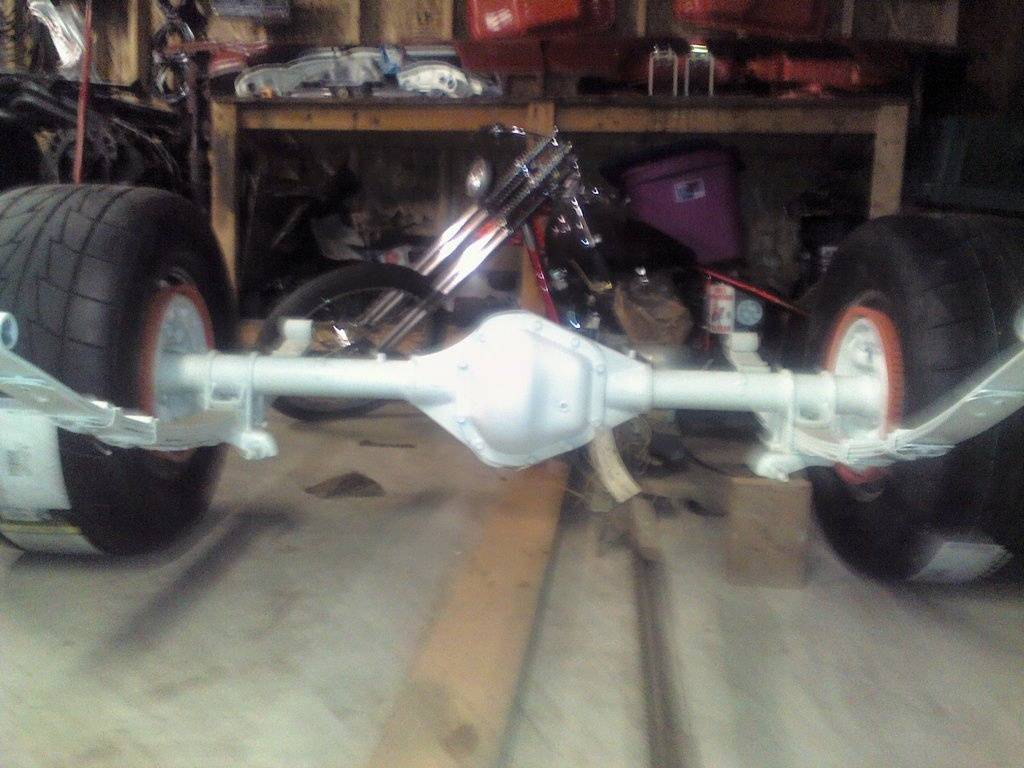

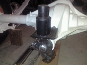

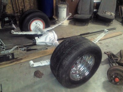

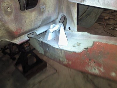

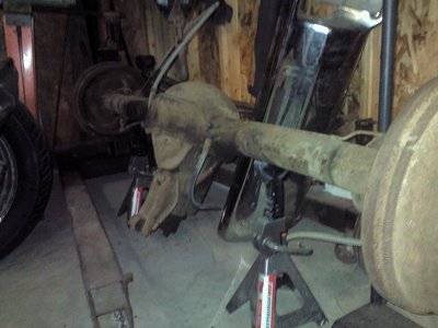

Pinion snubber mounted on S60

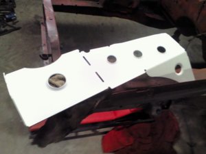

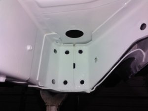

Sub frame connectors insides primed in painted and screwed in place

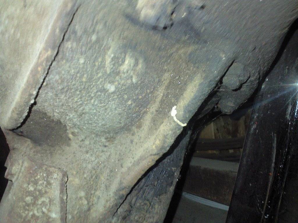

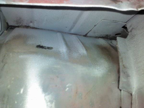

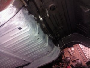

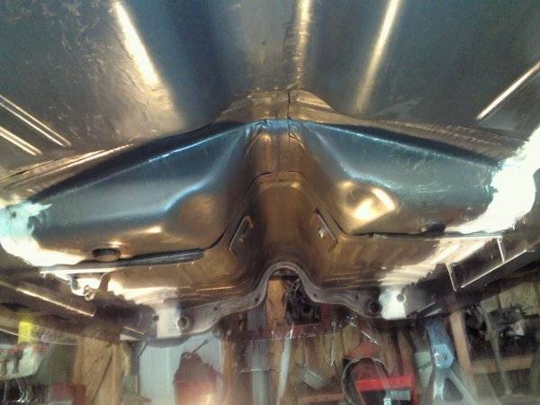

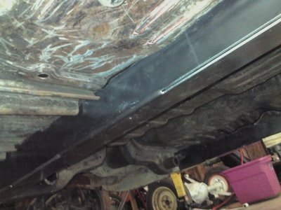

trunk underside ...had to prime ...fact prep n paint not good here,started to flash rust after only 12 hrs...
Paint shows small rust holes ...think'n weld solder or braze ?

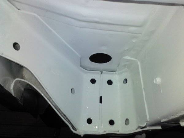

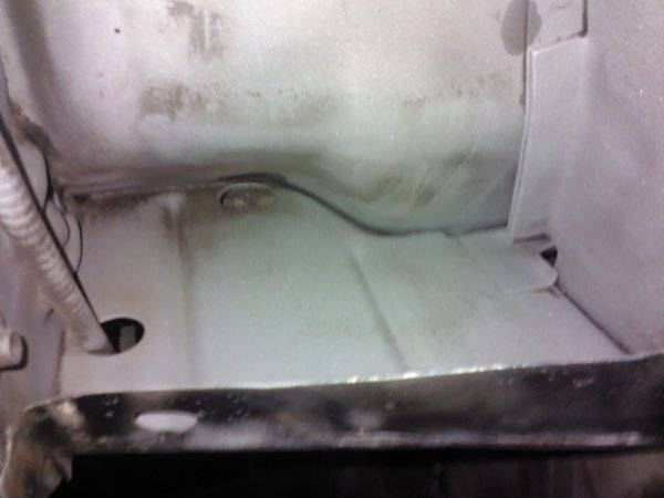

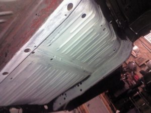

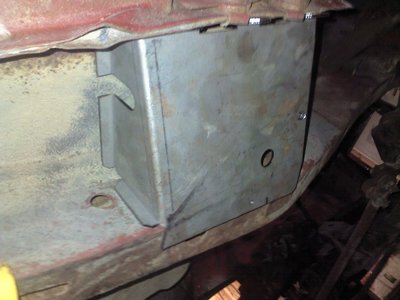

Rear Torque Box wells cleaned n primed...if it's not to cold I'll do the fronts tomorrow then a lil detail grinding n weld everything in place...GOD willing!

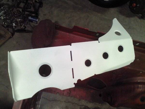

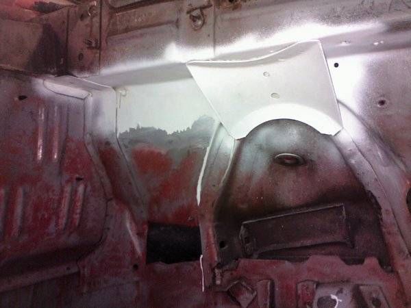

lower rad support brace,rad support,driver side inner fenderwell brace,pass side fenderwell brace,driver side prep't & pass side prep't ..welding m in hopefully this week...
