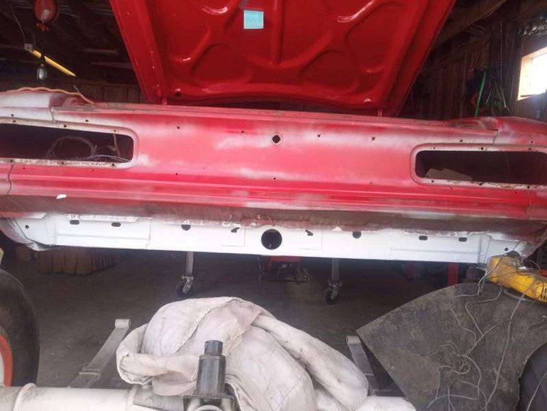

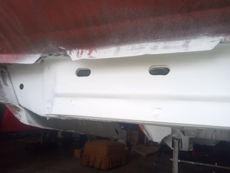

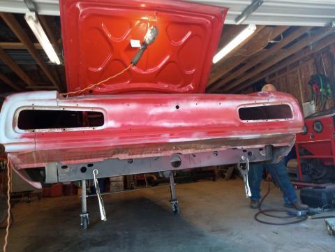

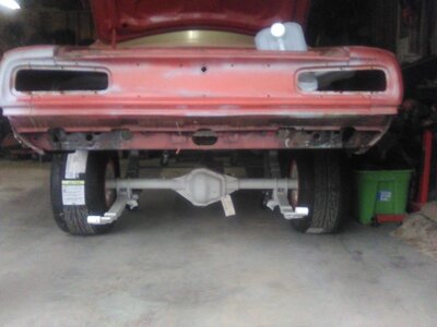

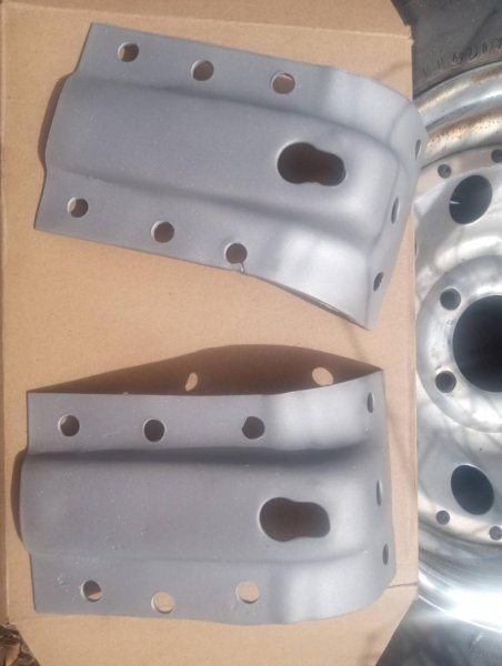

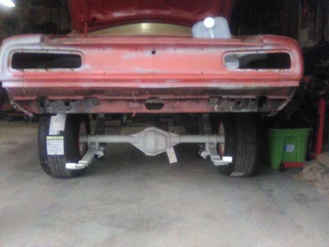

Got the rear crossmember & bumper plates primed n YES front side of crossmember and backside of bumper plates are primed......

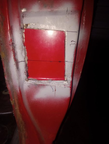

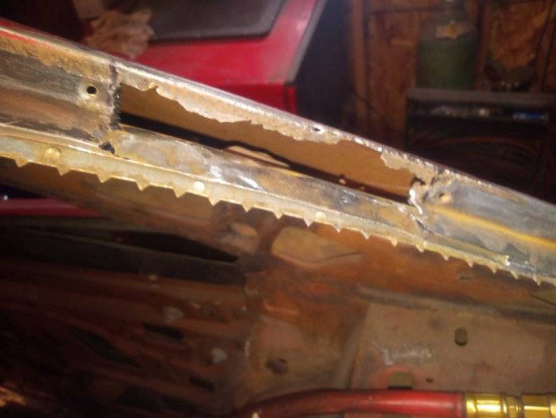

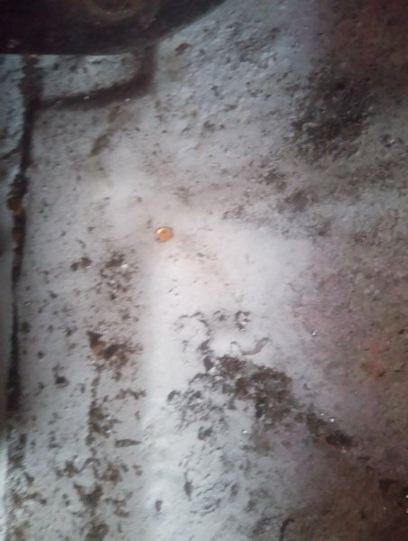

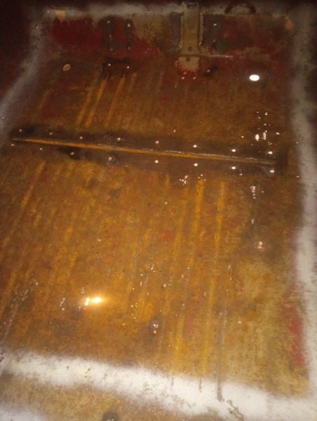

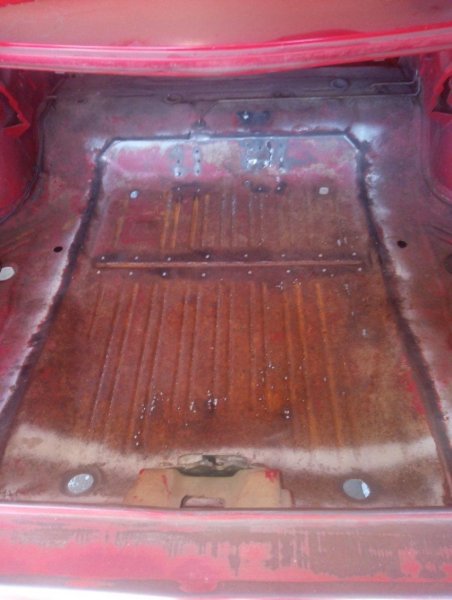

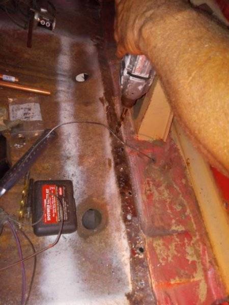

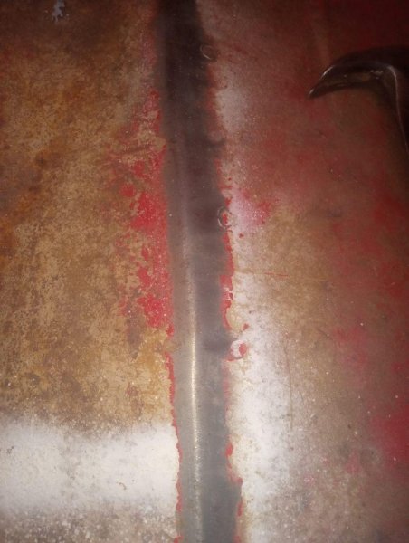

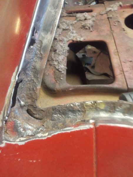

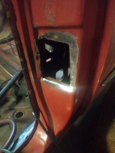

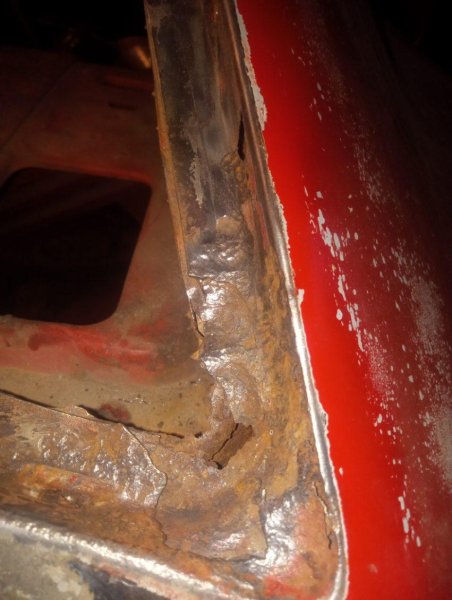

Starting on trunk valley pan removal & repair,drill guide holes in the corners that I will pop a chaukline on then tapes for cutting with body saw. It's weird because outside of the valley pan the floor is solid as a rock. I placed a droplite under it with garage lights shut off to show the rust holes in the lower part of the channels...
