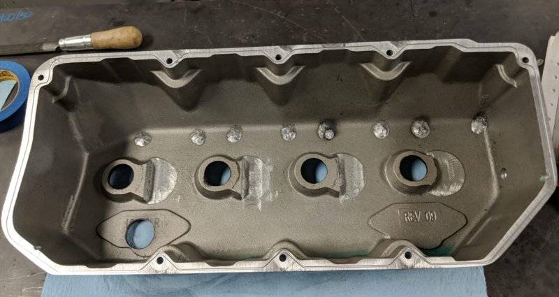

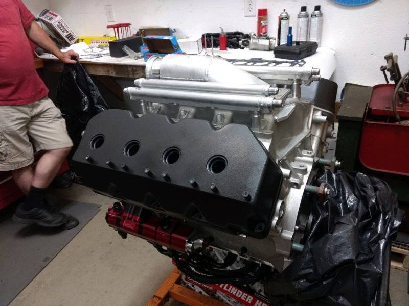

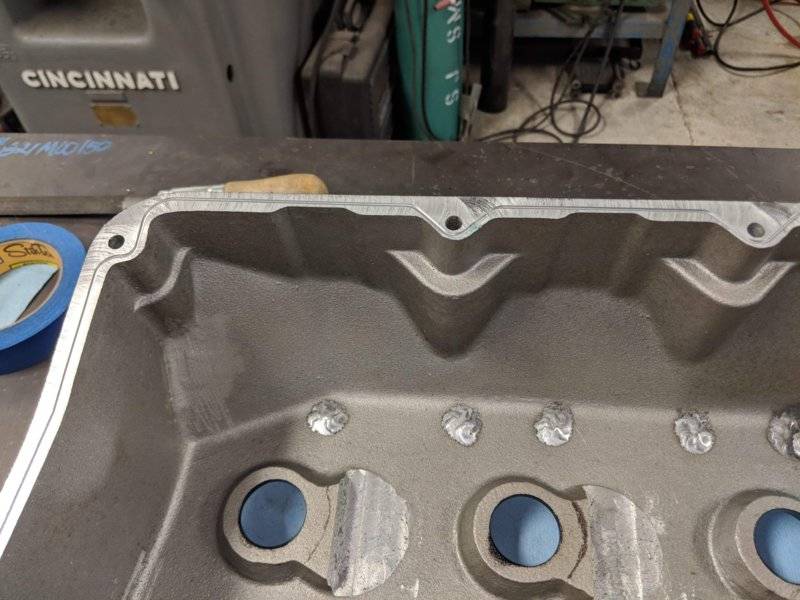

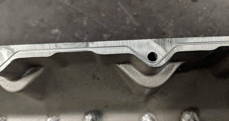

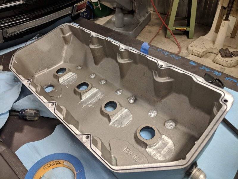

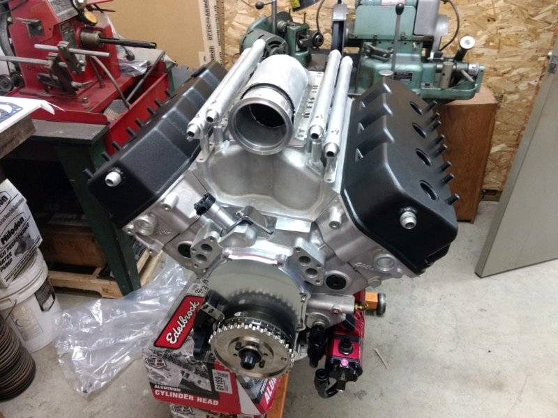

I got the valve covers back this weekend. More o-rings to eliminate gaskets. Now, if only I could get heads
They were milled for clearance. The bosses were originally there as those castings are used for dual plug applications as well. I milled them to eliminate any potential rocker clearance issues.Nice, did you have to mill the sparkplug bosses for clearance, or shaving weight?
It was pretty humid. I degreed a cam, checked piston to valve clearance and measured for pushrods on a stroker RB in the bed of a truck in the heat. Lots of sweating, lol.How was the heat down there yesterday?

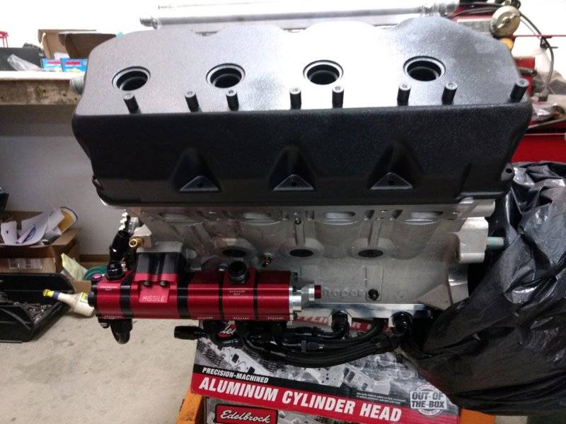

Ridiculous but in a really good way.So these heads finally showed up... I couldn’t help doing a mock up of the top end.
