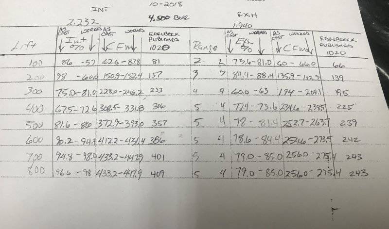

So in between all of the chassis work I’ve been doing, I finally found time to check out and prep a couple ports on the hemi heads. I took them to the local shop and he put them on his Superflow 600 bench to see if I actually improved anything, lol.
This sheet is confusing, so I’ll attempt to clarify.
Column 1 is valve lift
Column 2 is % flow in that range intake
Column 3 is CFM of as cast and then worked intake port
Column 4 is Edelbrock’s claimed numbers from their 1020 bench
Column 5 is flow bench range
Column 6 starts over for the exh %
Column 7 is CFM of as cast and worked Exh port
Column 8 is Edelbrock published 1020 bench numbers for Exh
These were flowed using a 4.500 bore.
Pretty good!!

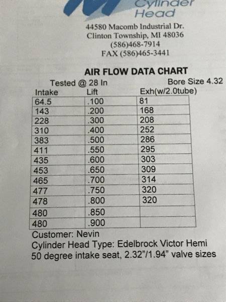

For comparison my modern ported Vic jr’s
I think these were a 1020 bench also. I know those are usually softer numbers compared to a 600.
