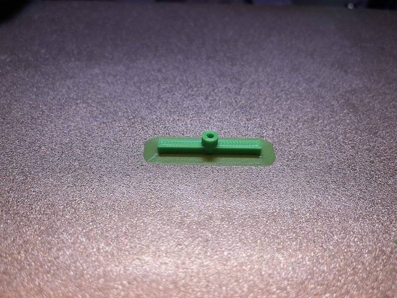

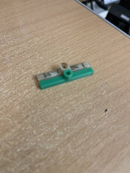

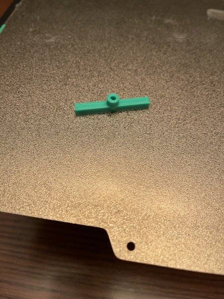

I posted this in another thread. I am planning on printing some slider clips in the next day or two.
Guys let me know if you need any of these window channel clips. I made some and they work with the old pins or .125 steel rod. I’ll just send them to you if you PM me your address/info.

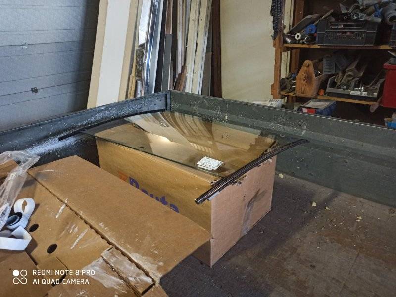

Got door glass installed with repro slide felts no problem, they seemed to have correct contour only needed to trim to lenght and punch holes for the plastic slide clips.
One tip, if you doing this by yourself and install the glass with window frame already installed in the door, leave the felt abit longer on the bottom so its easier to guide into the frame channel from top and wont catch an edge and break.
My repro door glass edge to quarter glass seal was rubber and causes some friction when cranking window down when door is shut... Dont know if there is more original felt style? With enough fiddling got it to seal and still able to crank it down however, not the simplest job
