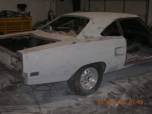

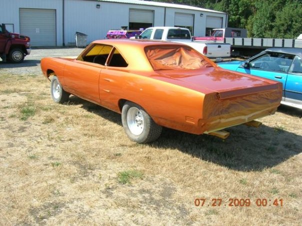

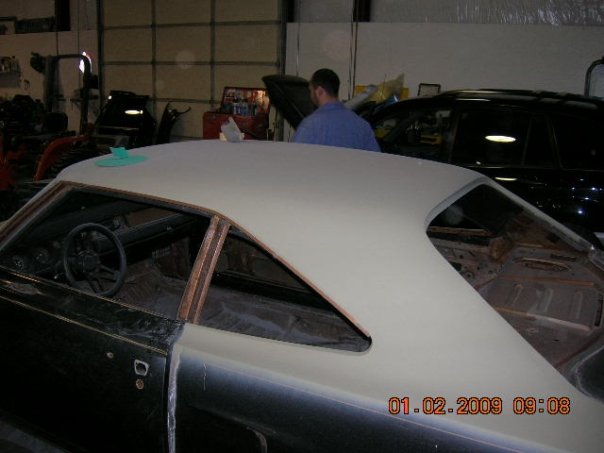

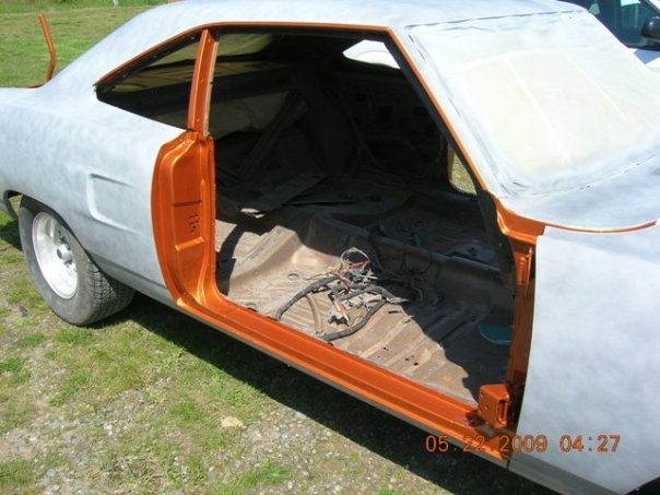

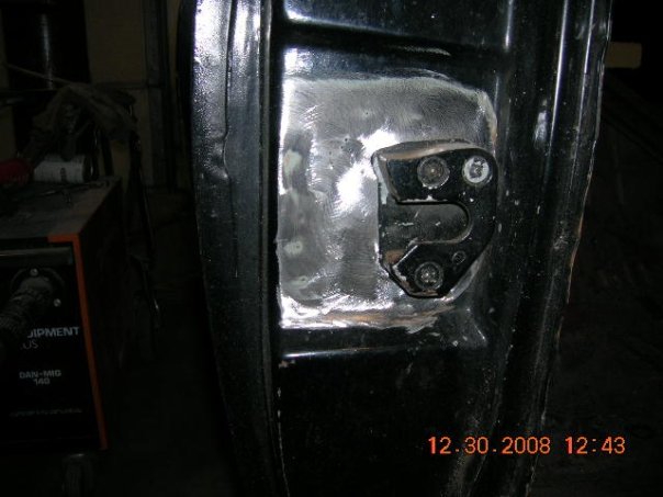

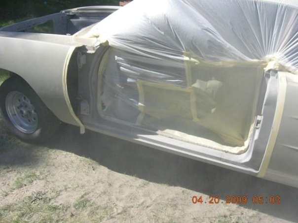

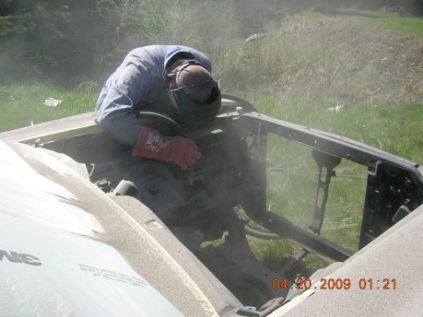

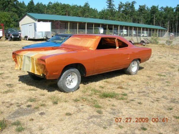

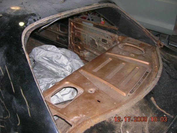

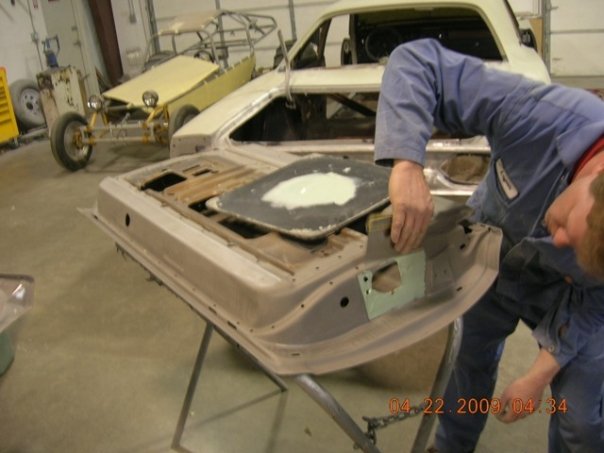

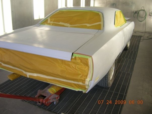

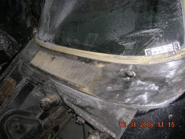

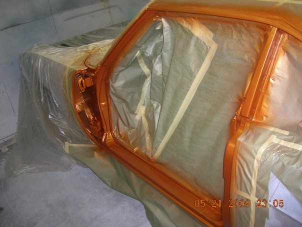

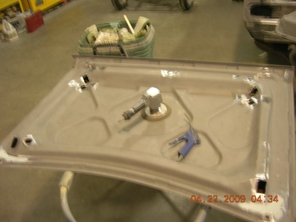

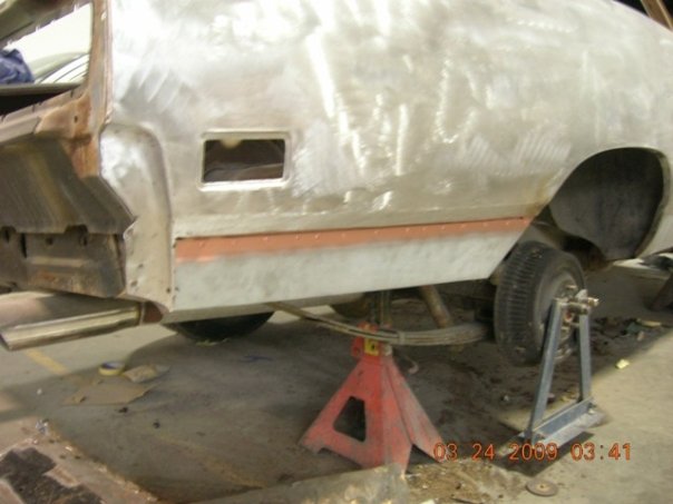

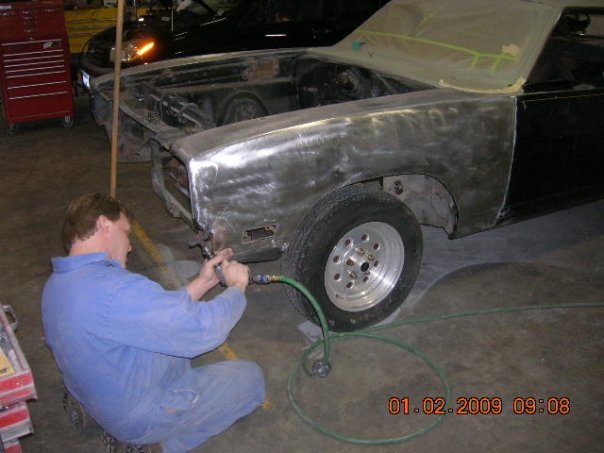

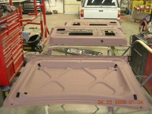

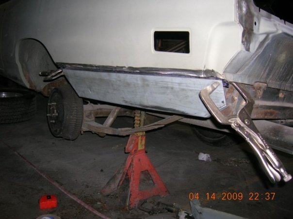

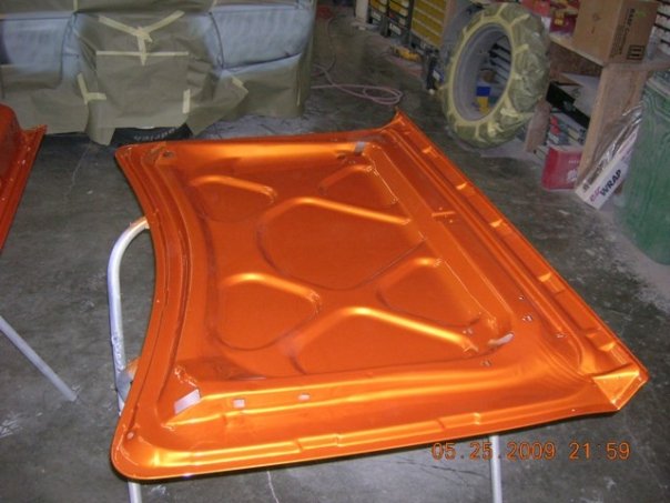

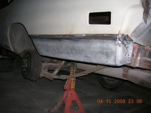

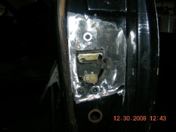

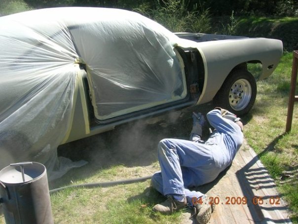

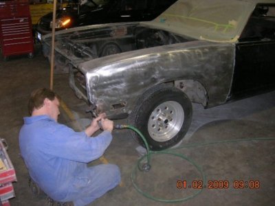

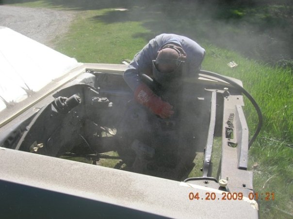

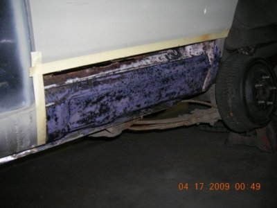

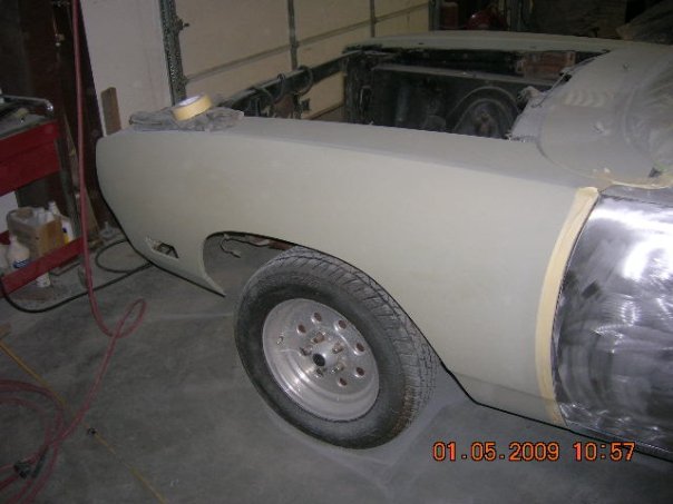

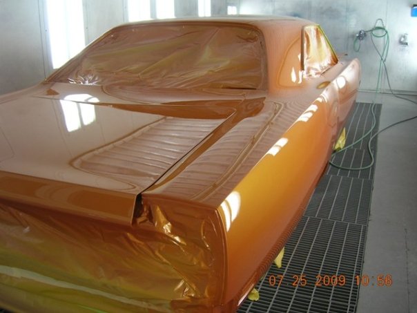

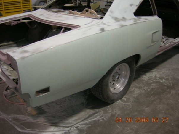

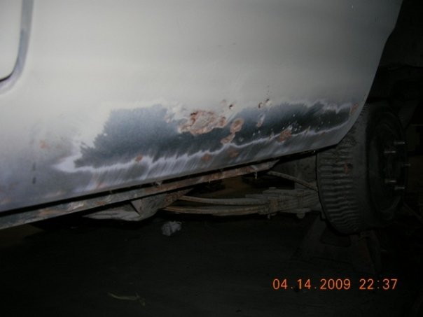

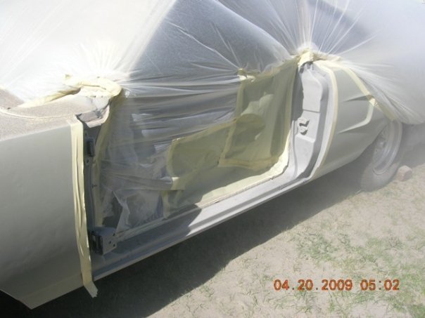

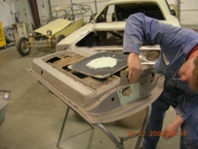

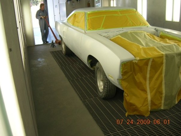

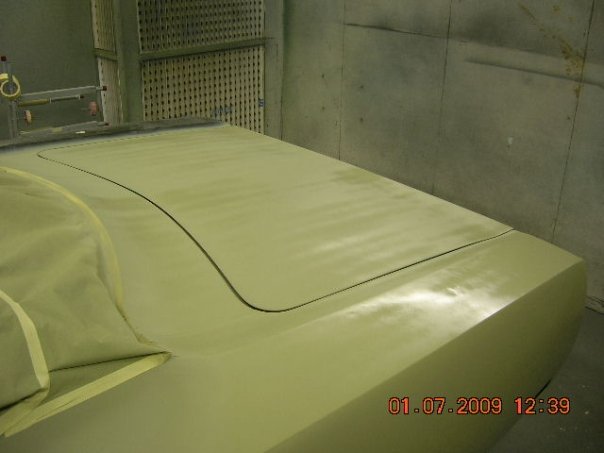

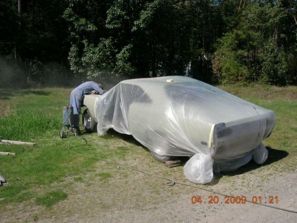

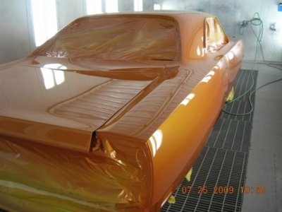

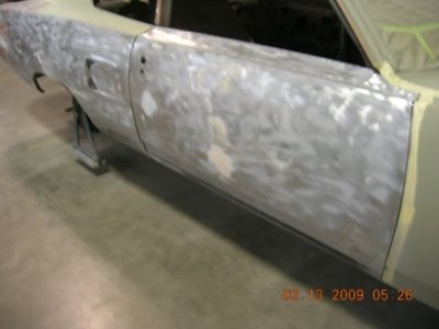

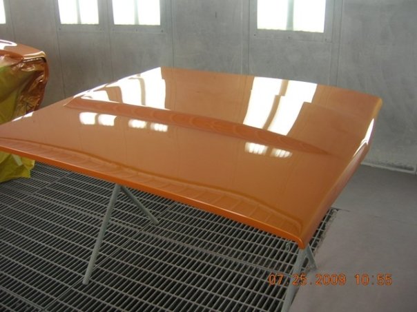

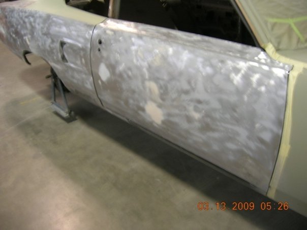

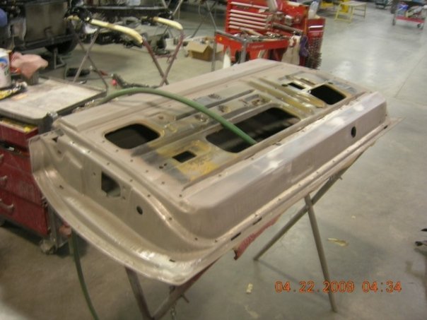

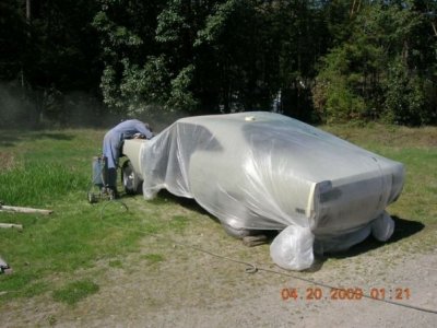

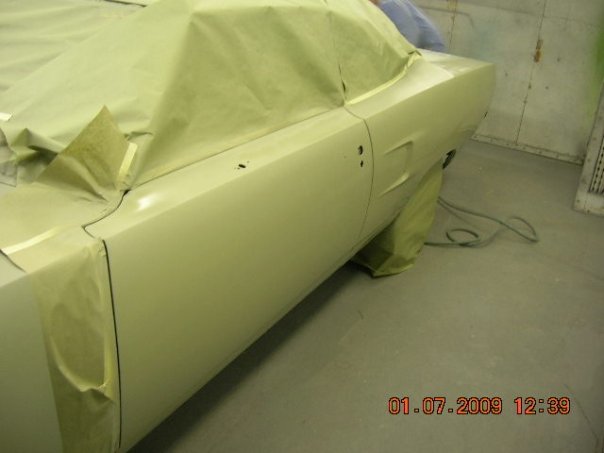

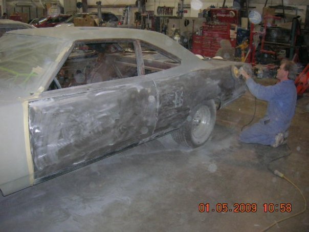

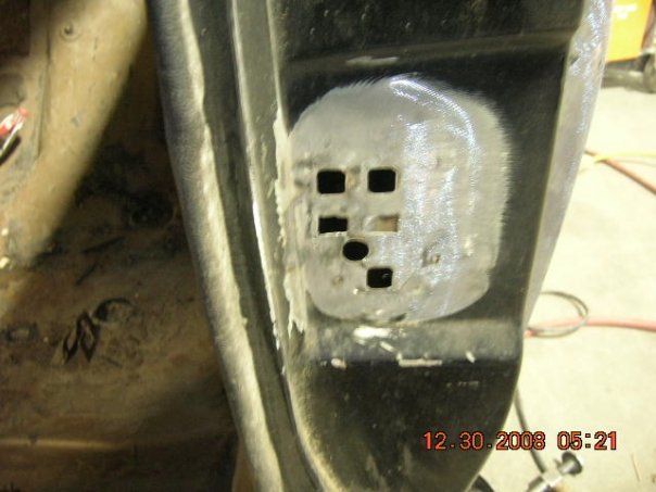

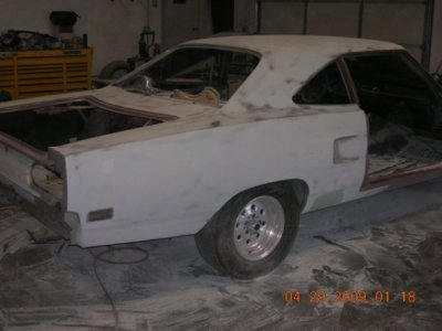

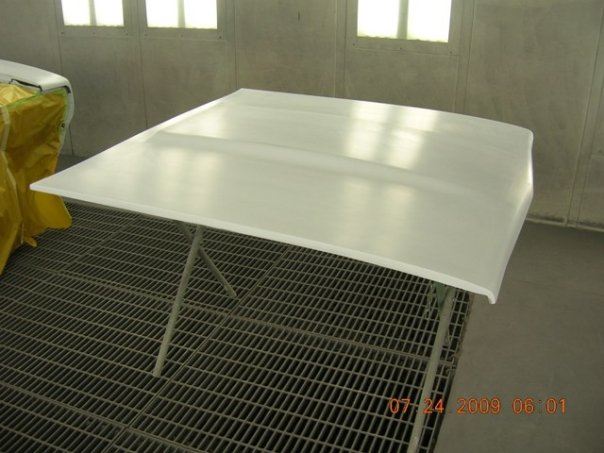

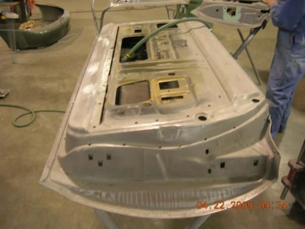

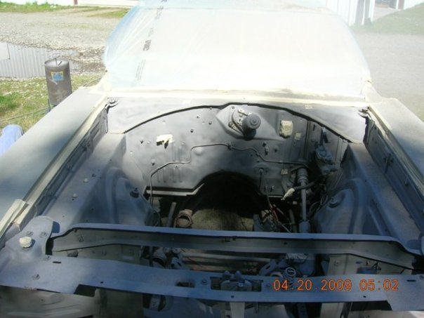

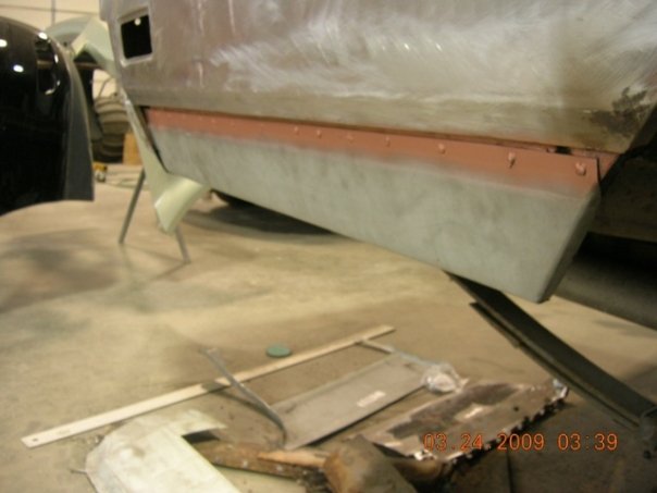

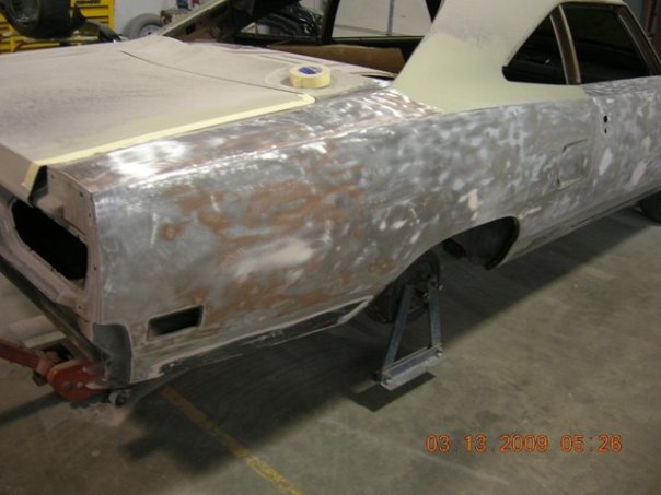

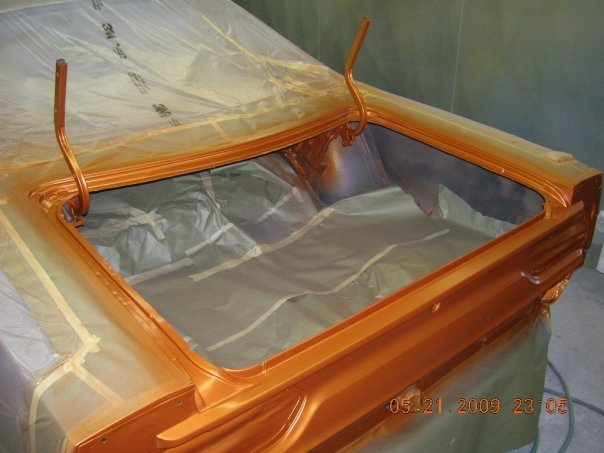

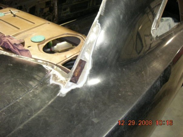

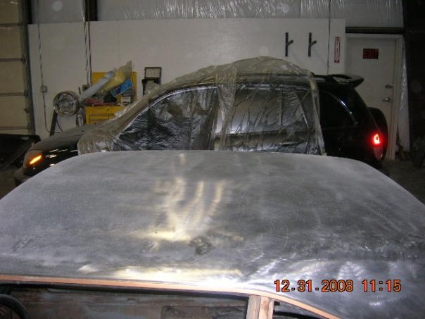

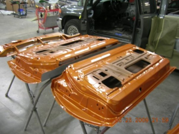

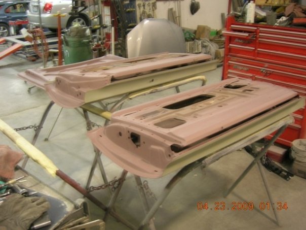

Alright folks, I just became a member of this forum and promised some pics. So here ya go!!! This car was originally copper from ma Mopar, but when I picked it up circa 1992 it had been done black! While that was a pretty tough color I was lookin to do something to bring it back to copper, but wanted to update it and decided to go with the color of the 05 SRT-4's...... I know its not for everyone, but hey, thats the great thing about restomods!!! This will definately not be any sort of trailer queen as I love to race! Some of the pics may be a little out of order, but figured I'd get them up here anyway in case anybody's interested There are quite a few, so this might take a bit!

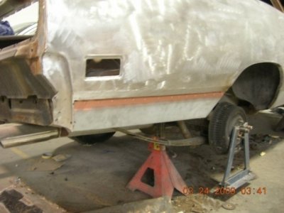

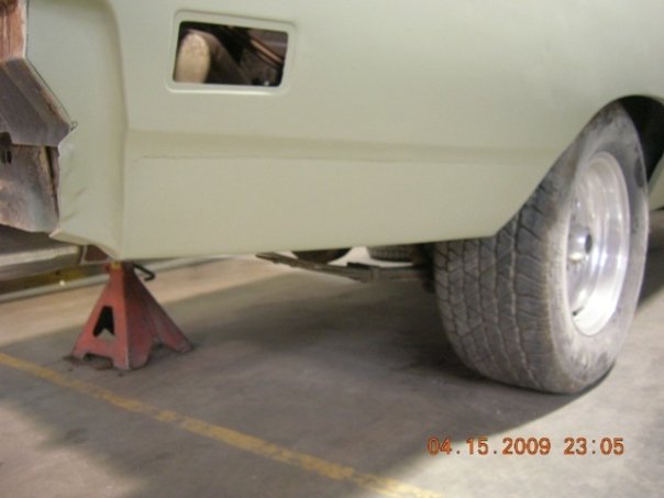

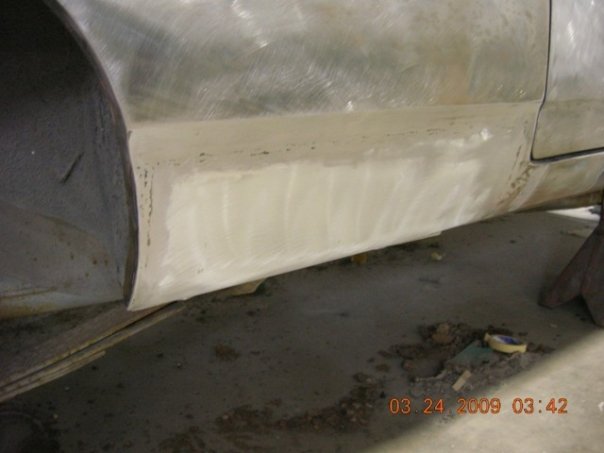

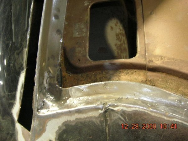

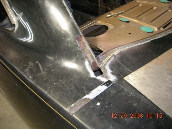

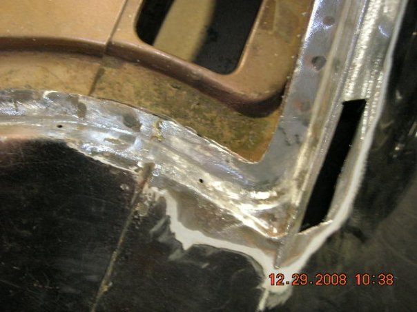

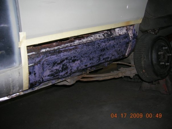

nice job, I,m dealing with the same issues as you are. When you repaired the lower rear 1/4s, did you flange your repair panel or butt weld? Also on the rear window corners, did you buy them from AMD or did you fabricate them?

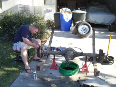

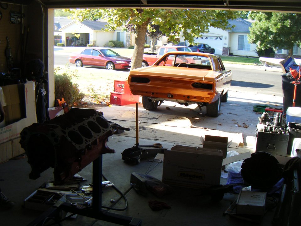

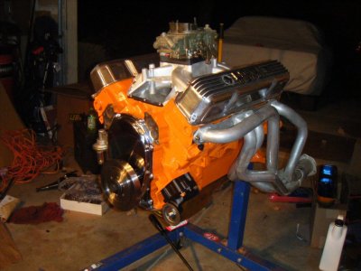

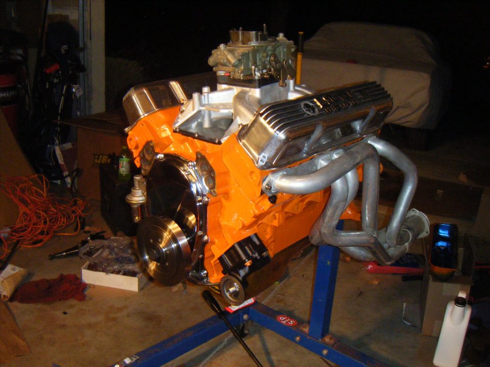

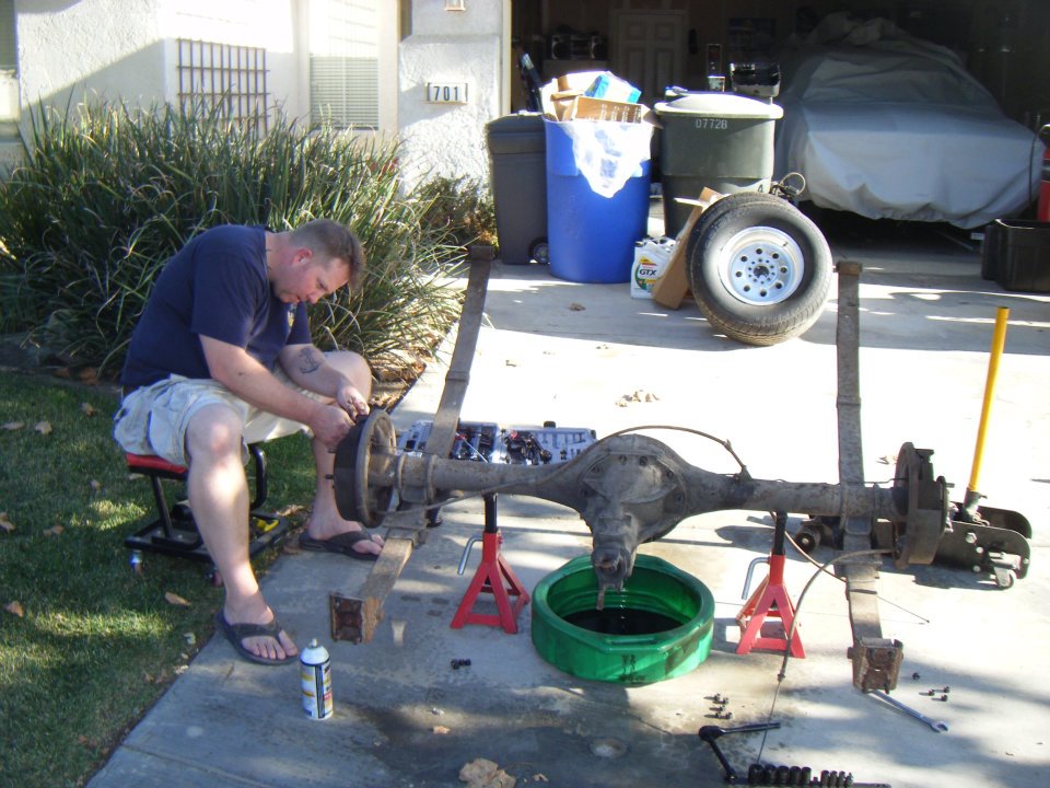

Here are a few pics of the Engine/Rearend.....
383 .030 overbore, forged original crank, Speed pro forged flat top pistons and an MP 509 cam, Holley Street Dominator and a rebuilt 650 DP (might be going up to a 750. The car is originally a 4 speed, but since I do not have one for it the 727 I have was rebuilt and I put in a Transgo TF-2 shift kit and a Hughes 3500 stall. Still gotta rebuild the 8 3/4. pulled the rearend out, but gotta get some more tools (shop press) to do all the rearend and axle bearings, but have a 4.30 ring/pinion setup ready to go! Not sure what she'll run, hoping for low 12's but it sure is fun so far and I guess we'll see!!! Nitrous is always an option I suppose, but sometimes its like a really hot chick with an STD! "Would love to hit it, but a little affraid of the consequences!" LOL!!
I wish I could take credit for the body work on this thing! However, I had it done through a local shop in Coupeville WA. I do know that they Flanged the repair panels, and being a (very) amateur welder myseld understand how much easier that was for them than trying to do in the panels through butt welds..... I also know that they had to fabricate the lower rear window corners, but after having seen the AMD ones, I almost wish I would have went that way as everyone on here says their sheetmetal is pretty dead on! Probably would have saved me a good bit of money in labor! LOL!
