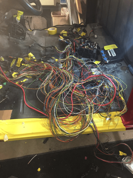

This is what was removed from a 2005 SSR to make it work in a 1965 Chevy truck. If you are trying to integrate old and new tech you are going to have a problem with analog vs digital. For instance, an old school gear driven speedo trying to integrate into a modern dash. It can be a lot of work, so best of luck on your project. Just watch out for fuel pressure and oil pressure signals. That can shut you down and is difficult to locate/figure our why.

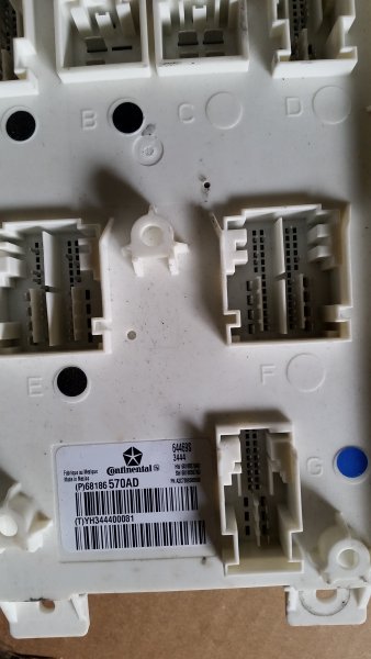

You guys are obviously missing the point here. ALL YOUR KITS will not connect to pieces like this
I think you are missing the point. Why go through all the grief to connect to a special purpose brain box. You can have all your needs fulfilled with a whole lot less grief.
All the controls and terminations needed to connect the NEWER Cars instrument panel interfaces look like the picture I posted earlier. Tell me whos suggestions you are presenting can connect to this type of interface? because my picture SHOWS the types of computer controlled devices I need to connect to to make the NEWER car parts work
To use that module you will have to use all the components and wiring that came with the car. Good luck with that.

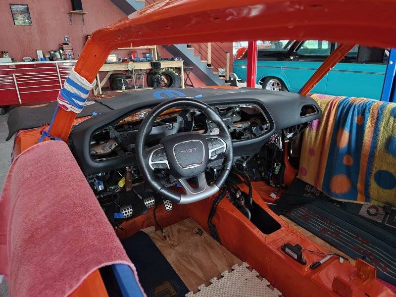

Thanks Gents! FINALLY some guys KNOW exactly what Im doing. YES I have used the entire Drivetrain and all wiring harnesses and Power distribution blocks. The things I have omitted are ABS, ORC, Parktonics, Door modules. Everything else stays. Finally got the car to start - but it wont shut off. Hoping to find someone local here in Florida thats can take a look . Any suggestions?
