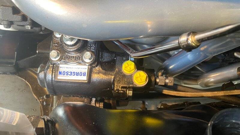

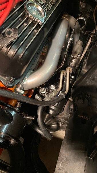

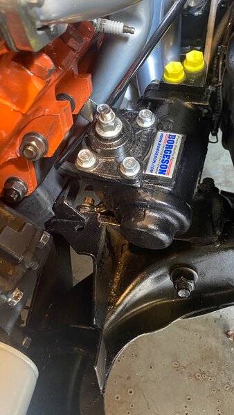

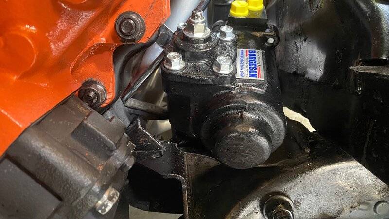

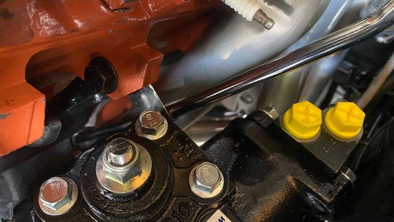

I got some time today to continue on the car, i already had the timing chain replaced and since a lot of stuff was removed it was easiest to do the box change also.
I had to lift the engine quite a bit and had to remove the motor mount bracket but the old fat bastard came out.
Installing the new Borgeson box was a breeze as there is lots of space, cut around 1" of the steering shaft and only have to drill the holes for the roll pins.
Lots of clearance with the TTI headers.
Only thing is the pressure hose is not really the right shape for proper installation, but i let it be as it sits since it is not contacting anything and is just in a loop shape with no twist or torsion.
Hopefully i will be driving it in the next few days.

Nice! Thanks for sharing the great photos too. Did you keep the stock power steering box or install a Borgeson?
I assume you mean the pump, I am using the stock pump, maybe 2 years old.
Pressure and flow is acceptable according the specs for the Borgeson box so i think it is no point to buy another pump.
