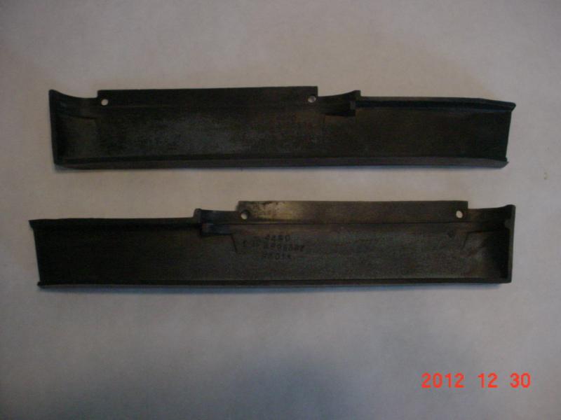

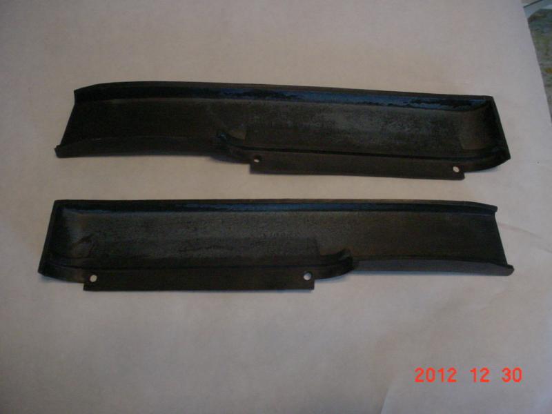

1970 power bulge hood p/n and photo
I believe that you may be looking for a set of these? #2998397 and #2998396 I believe they are called rain deflectors and they are held on by two bolts per deflector.
Here's one listed on eBay. I had a '70 Coronet years ago that was missing the parts. I cut two pieces of aluminum that I got from Home Depot and painted them satin black and bolted them in. I didn't know what was missing either at that time but didn't like the rain going stright through. They weren't perfect, but they did the job, and if I can recall that far back I bolted them in with two bolts, also. I made them long enough to clear the upper part of the 'bulge'.
There's one listed on ebay, I can't post a link yet, but search "super bee power bulge" it's blue, item # is 261029477514. I had a '70 Coronet years ago that was missing the parts. I cut two pieces of aluminum that I got from Home Depot and painted them satin black and bolted them in. I didn't know what was missing either at that time but didn't like the rain going stright through. They weren't perfect, but they did the job, and if I can recall that far back I bolted them in with two bolts, also. I made them long enough to clear the upper part of the 'bulge'.
