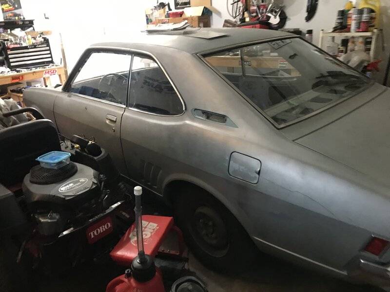

A while back, my brothers bought this car over at forabodies from a nice fella named Stan. California or Arizona car. Rust free, clean as it gets.
I’ve tasked myself with building a patina drag car out of it. Budget minded if at all possible.

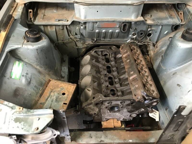

I have a .040 over ‘68 318 block w steel crank. I have a narrowed nine inch that I’ll be using. I intend to go a833 4speed manual.

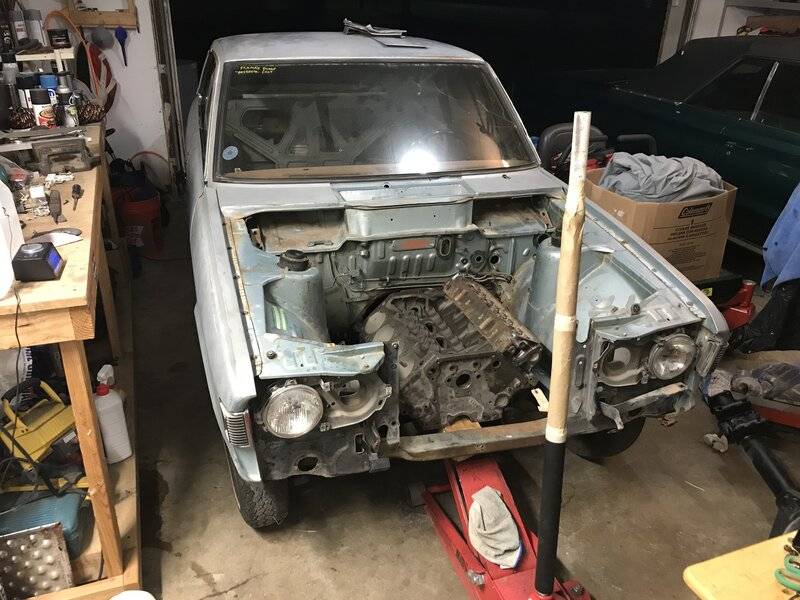

Stuffing a 318 into this is no easy task. I’ll have to move the engine back a few inches to get some weight off the front. And there’s not much room in front of engine neither.
I’m trying to not cut it up as this is a real nice car. I am only sectioning the bell housing portion of the firewall a few inches to get the engine back. The inner fenders and everything else will remain.

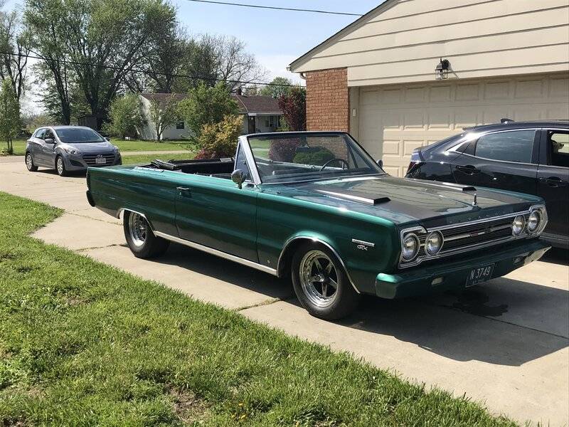

a few pics of the colt and a pic of my gtx convertible that you guys have helped me with...

That's a nice looking GTX. A friend of mine has a 72Colt GT drag car with a 440 in it. It was interesting to watch until he moved the shock towers back and realigned. Good luck with the build.

1971 Colts are 95.2" wheelbase. Thanks 66Sat. This is exciting. Can't wait to have some progress pics to post. As of yet, the front lower core support area needs pulled out slightly (must have been in a fender bender- very mild hit). My brother will put it on the frame rack to straighten.
And then, we will remove battery tray cleanly without molesting inner fender. Then, begin mocking up engine for location and fitment.
