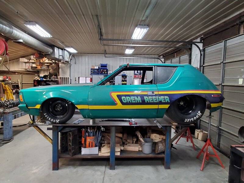

Also, here is my brother Ethans factory pro stock gremlin 1of4 made by amc for nhra pro stock competition, however it was not amc backed. Former peck and peck car out of Dayton Ohio. Not much history except: My father owned this car in the 80s, raced it and then sold it!!!!.....but......we found it three years ago in south or North Dakota and bought it back. Brought it back home. Factory lightweight...special acid dipped body and other trick **** of the day. This car is currently under construction for moly tube chassis. And will rightfully receive an amc 343 stroked to 413.

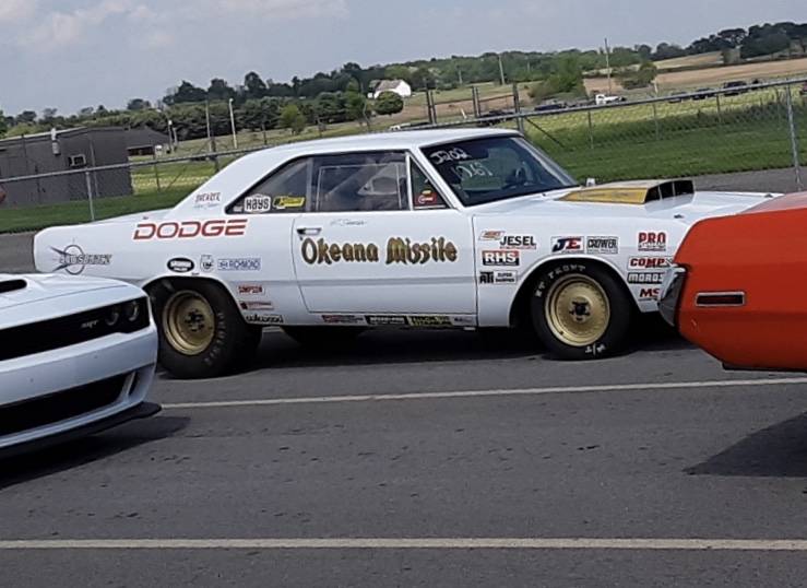

Here’s my brother Trav’s 69 Dodge Dart named the Okeana Missile...Bracket racer w 440 auto, tunnel ram. He runs this all the time it runs 10:60s-10:80s...but since civilization has shut down, he’s yet to test out his offseason improvements (my father built this one and maintains the car).

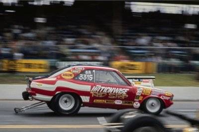

some inspiration

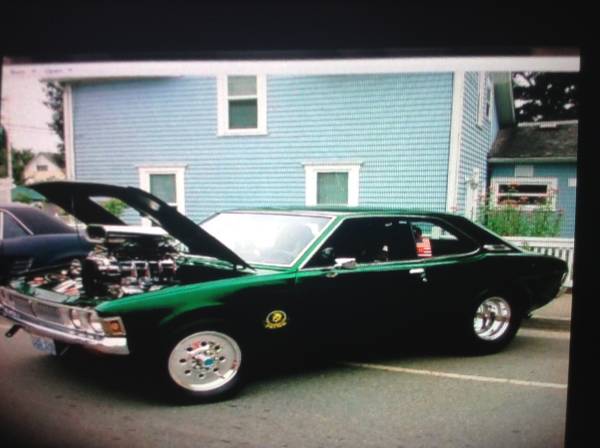

@funnykarman here on FBBO IIRC,
his photos if nothing else

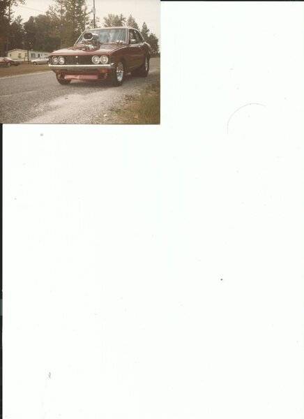

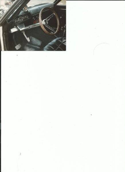

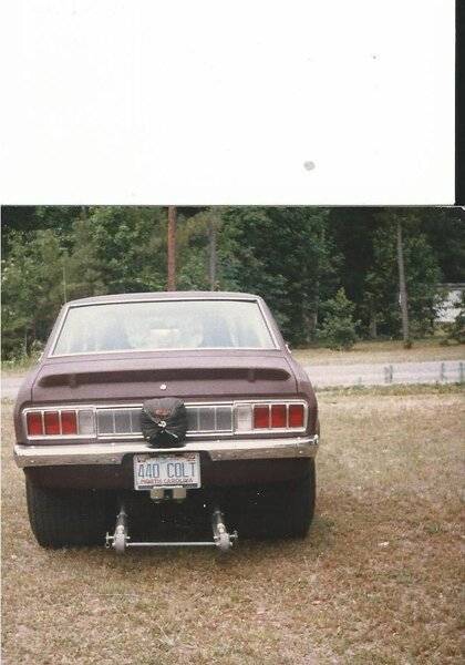

72 Colt 440ci Blown & twin 750cfm Dana-60 4.10's street car funnyKarman @ FBBO.jpg
72 Colt 440ci Blown & twin 750cfm Dana-60 4.10's street car rear funnyKarman @ FBBO.jpg

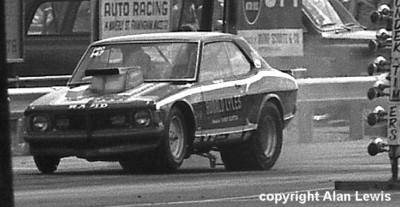

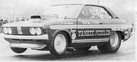

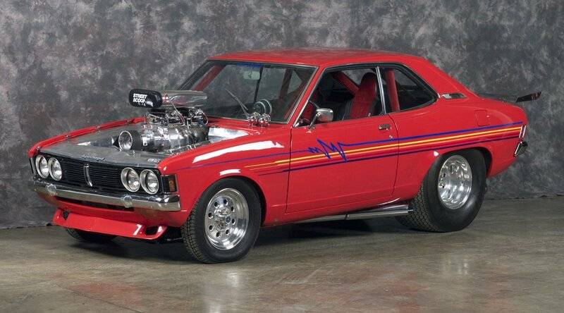

another blown Pro-street version

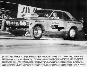

Mr. Norm's

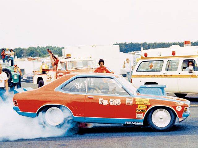

Roy Hill

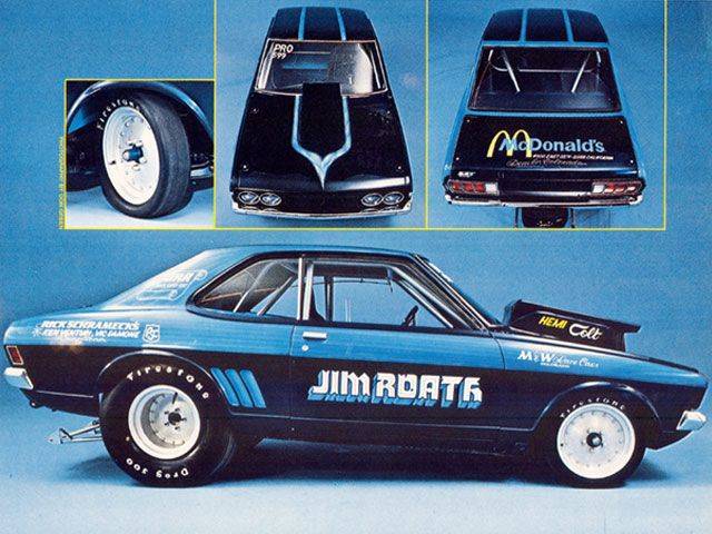

Jim Roath

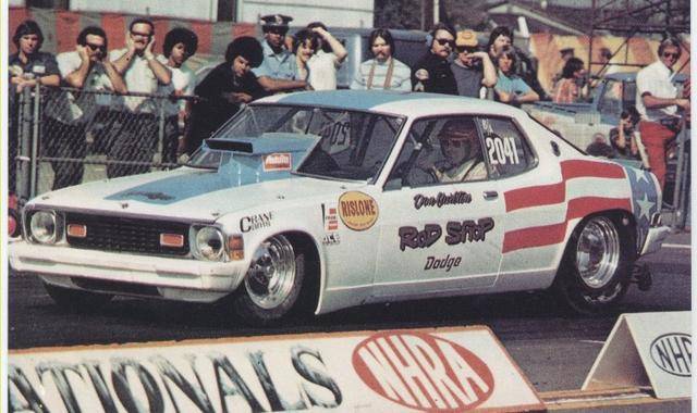

Don Carlton's extended wheelbase car

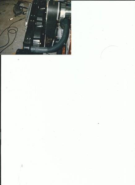

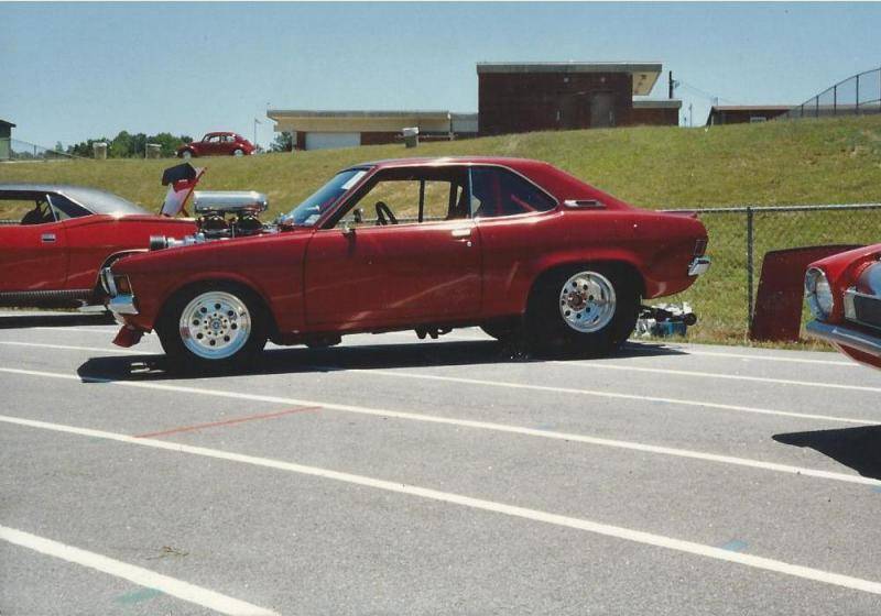

I am the guy that built the blown pro street colt . It was the first full on build I did . Your colt is a rear steer , hits oil pan will have header problems . The oil pan for the 4 banger is in front of the crossmember . I turned the crossmember around 180 degrees and installed a mgb rack . Moved in the lower control arms and the top in 3 inches . Used a 4.5 by 4.5 wheel spacer and redrilled the rotors for 5 lug 4.5 x 5 using the stock rotors . moved the 440 back 14 inches and still had radiator clearance problems . I used smaller 1000 lbs springs on the struts up front . All this and much more back in 1986 . Its still around in the Crawford Auto Museum in Ohio . If you need and help with your colt send me a private pm and I will give you my number and we can talk . John

I am the guy that built the blown pro street colt . It was the first full on build I did . Your colt is a rear steer , hits oil pan will have header problems . The oil pan for the 4 banger is in front of the crossmember . I turned the crossmember around 180 degrees and installed a mgb rack . Moved in the lower control arms and the top in 3 inches . Used a 4.5 by 4.5 wheel spacer and redrilled the rotors for 5 lug 4.5 x 5 using the stock rotors . moved the 440 back 14 inches and still had radiator clearance problems . I used smaller 1000 lbs springs on the struts up front . All this and much more back in 1986 . Its still around in the Crawford Auto Museum in Ohio . If you need and help with your colt send me a private pm and I will give you my number and we can talk . JohnView attachment 953205 View attachment 953208 View attachment 953209 View attachment 953210 View attachment 953205 View attachment 953208 View attachment 953209 View attachment 953210 View attachment 953205 View attachment 953205 View attachment 953208 View attachment 953209 View attachment 953210
Wow. That looks pro. You did an amazing job. Probably the nicest colt bar none.
Thank you for the info. Unreal.
The neat thing with turbo exhaust is we can swap the exh manifolds from left to right and run the exhaust towards front of car....hopefully. Avoiding clearance issues at the steering. But...I was also hoping/figuring that with the engine pushed back, we can run a rear sump pan that clears the steering cross link, but haven’t got that far. If not, a rack would be awesome.
