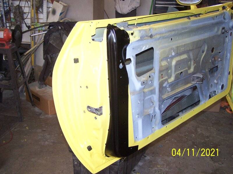

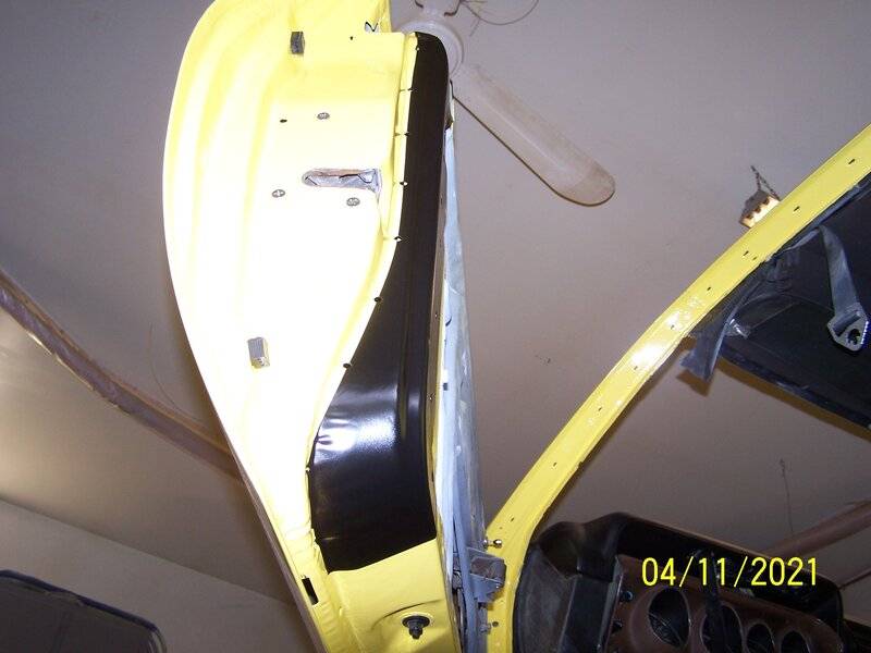

The color transition is hidden behind the weatherstrip...
The black on windshield pinch area is so a bright color isn't showing through the windshield... Typically it extends around the outside too so you don't see a bright color between the weatherstrip channel & the drip edge...
